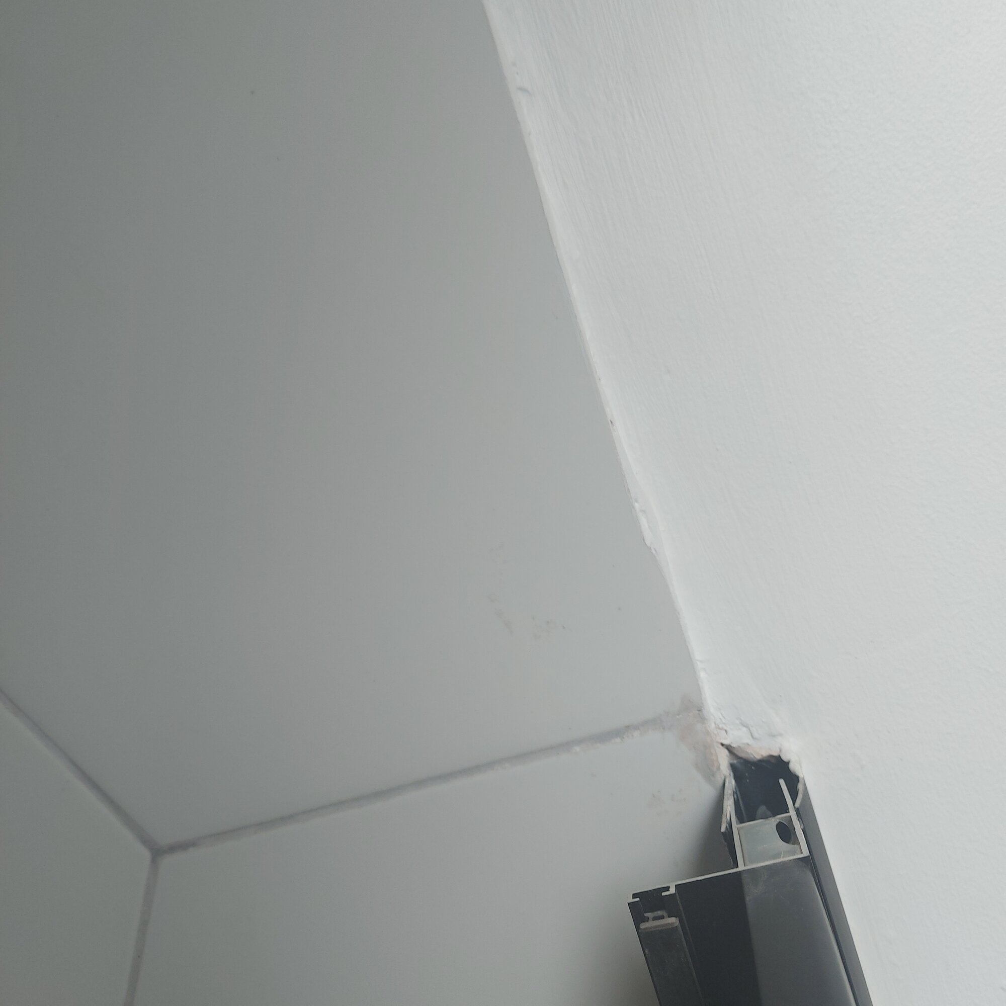

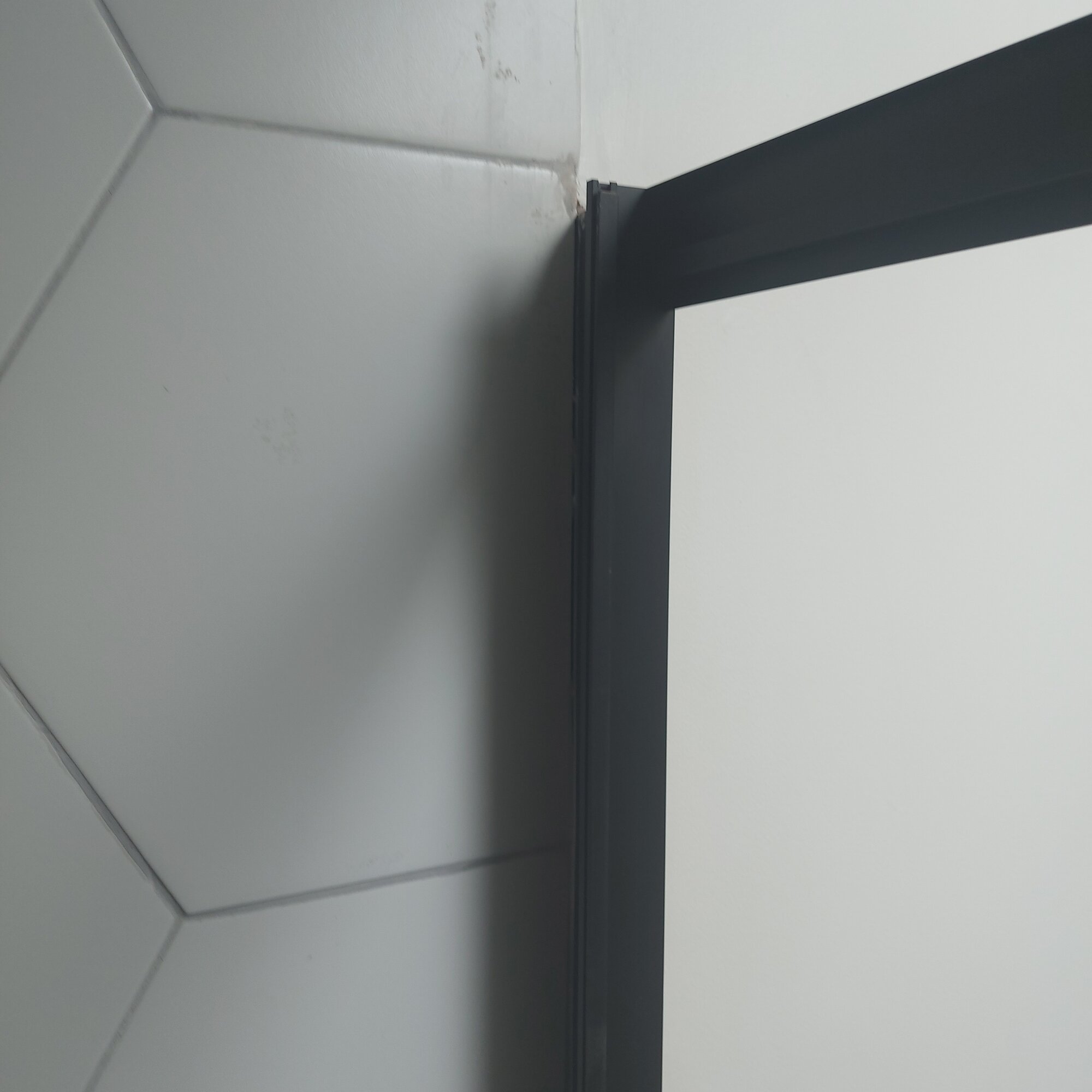

To me it looks like the shower screen , upright channels were fitted before the tiling and tiling butt's upto itRecently had new bathroom installed, is it acceptable to have the shower screen fitted onto the wall or should it have been onto the tiles, photo attached, any advice appreciated.
Also the screen does not look like its fitted right way , I've never seen a installation like that !!! Something is definitely wrong there , I'd be more worried about thatRecently had new bathroom installed, is it acceptable to have the shower screen fitted onto the wall or should it have been onto the tiles, photo attached, any advice appreciated.
Your first picture of the screen is definitely not how it's supposed to be !!Recently had new bathroom installed, is it acceptable to have the shower screen fitted onto the wall or should it have been onto the tiles, photo attached, any advice appreciated.
