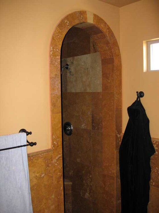

1.arches- should a full tile sit either side of the arch and then a baton gets fixed above the arch for the cut to sit underneath.

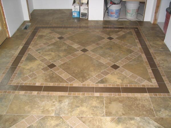

6. diagonal patterns- centre wall and try to have half a diagonal either side if possible. always start with half a diagonal off worktops
