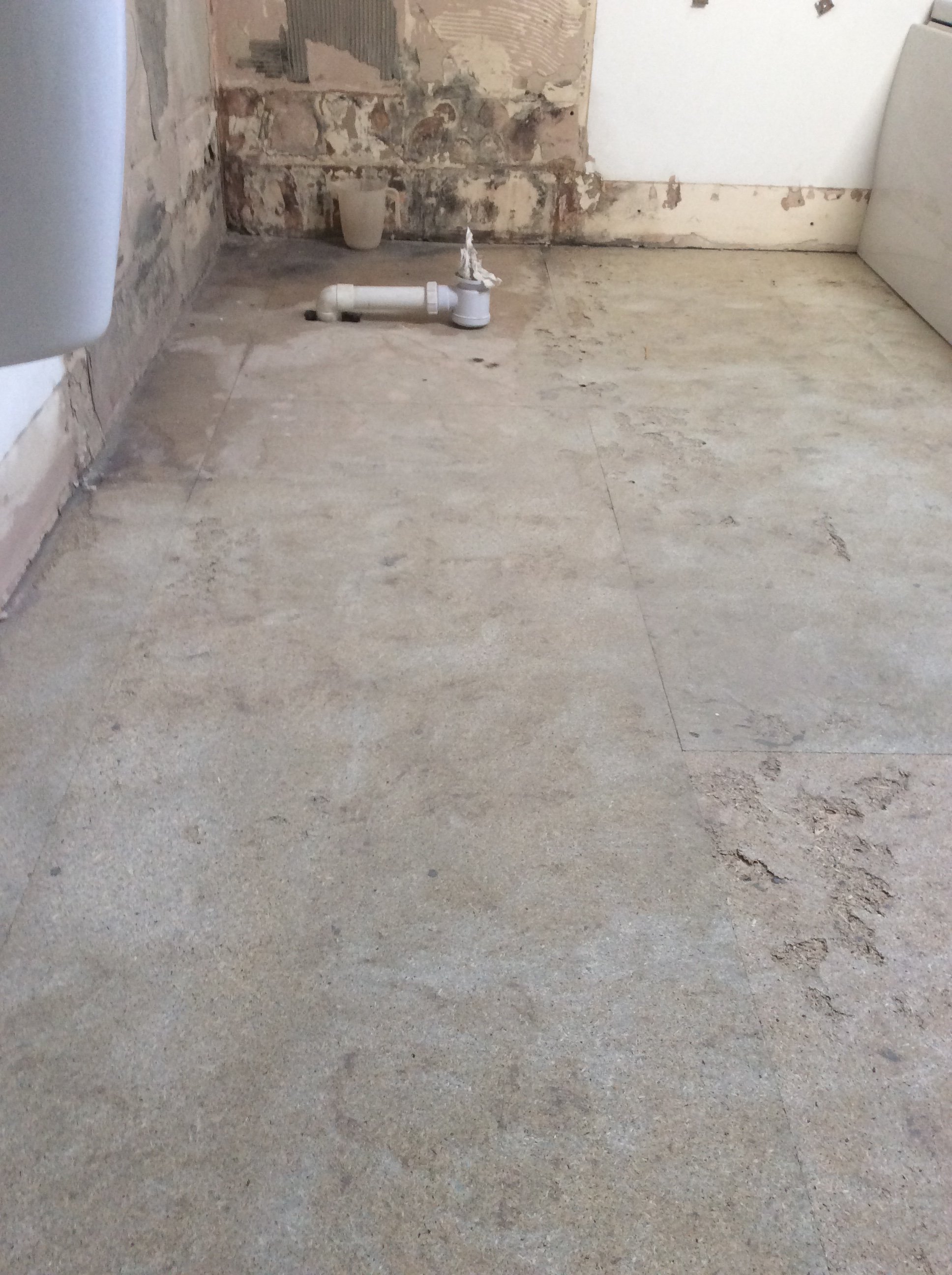

Can somebody tell me what's the point in sanding this adhesive when he needs to over board it anyway ?
any reason you can't just apply a thin layer of leveller ?

Ive got a mask ready, and won't use rapid set, as I don't want the additional pressure of rushing! It's going to be a case of slowly does it.
I realise that the hardiebacker in the shower enclosure will need to be tanked. What are the other options you allude to?

Grinder cup was definitely the way to go, but of my god, you weren't lying about the dust!!!
I'll start a new thread for the next phase of the project!
Cheers.
Haha we don't lie, people don't listen. 😀
And obviously, you are not included in that statement 🙂
Well done, glad it worked out for you.
