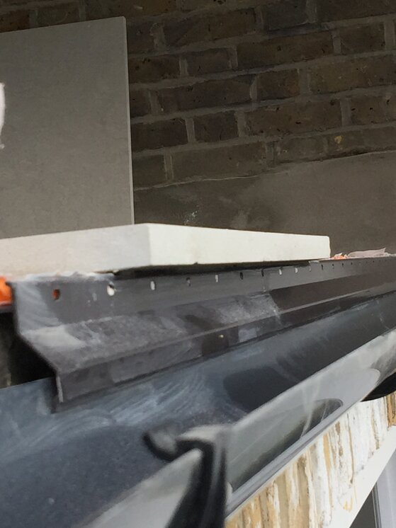

You will need seep holes in the block work or schluter may have a metal profile that will protect the tile edge and allow drainage. They have profiles like that for balconies and terraces, there's no reason why one won't suit the edge of a lawn.

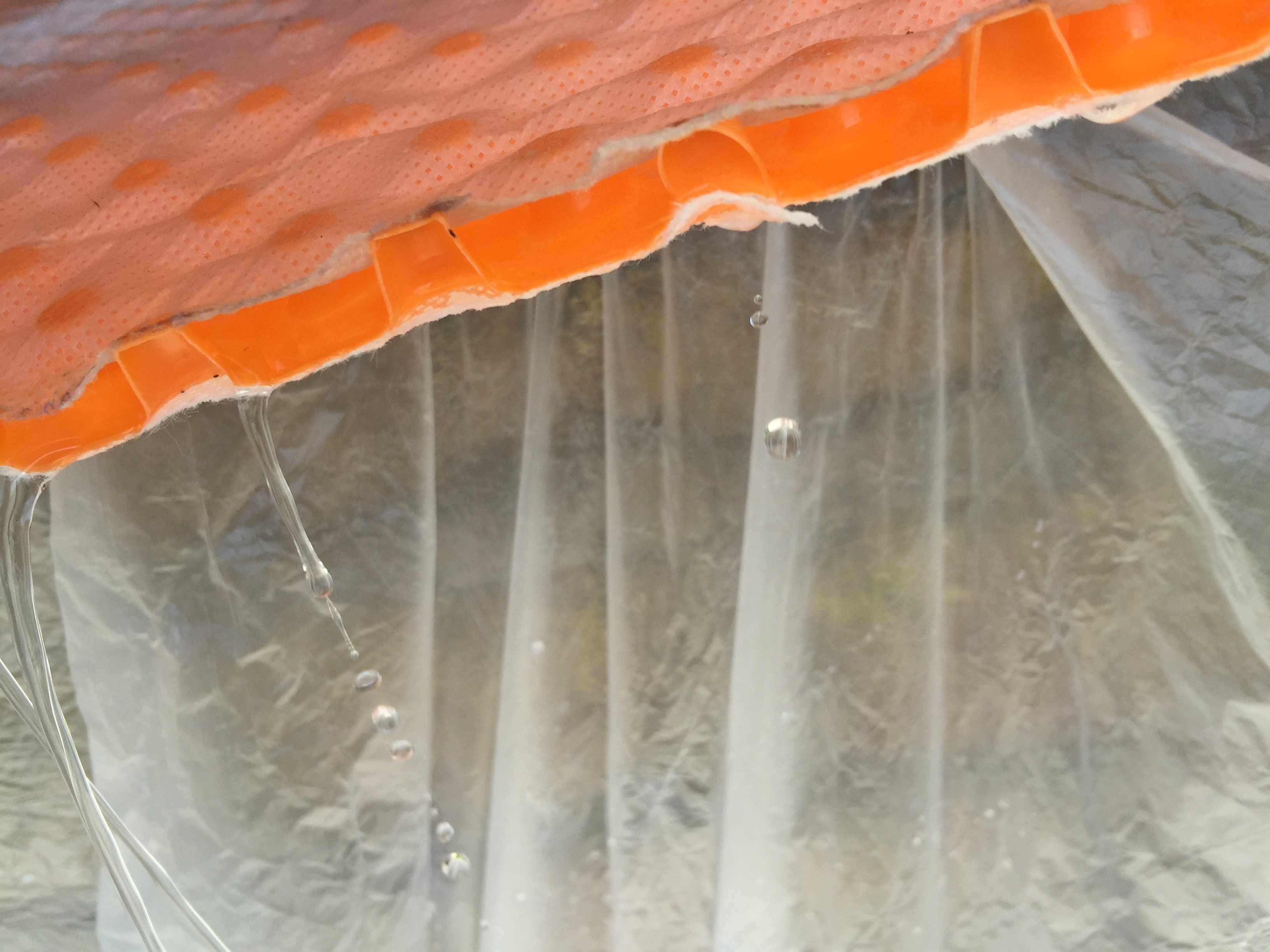

Here's Ditra drain working, you can see water draining away from between the mat.
1st pic water on left side draining.
Water draining on far right side. It does work.

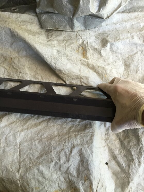

This is one of their profiles with seep holes.
You can see, they're not small.
They have quite a few different ones designed to allow drainage.
