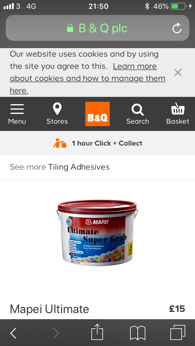

do i tile straight onto the walls with the adhesive or do i need to prep it first with a treatment? ive already started so will these tiles fall off in a few weeks because i didnt treat them?
i assumed when i removed all the paint i was good to go without doing anything else to the walls :/
please tell me its going to be ok!
