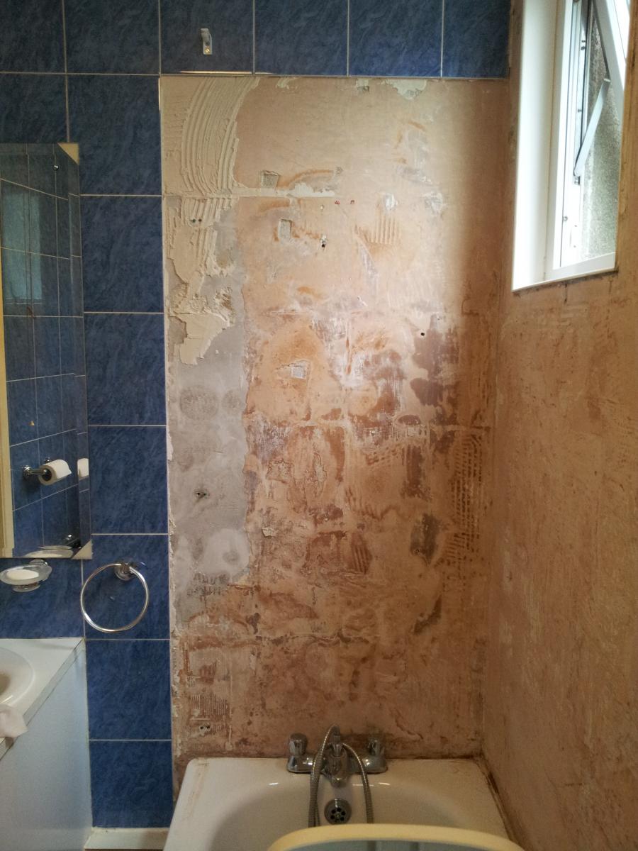

As you can see from the pictures below, that's how the wall currently is, I've had someone over and they said that theres no need to plaster or anything, and that the tiles could be put back on straight away.
The walls were previously damp from a leak which is now fixed, and the walls are now dried up after a week being exposed.
Could anyone please guide me on what I need and give me a guide on how to go about it (dumb it down please).

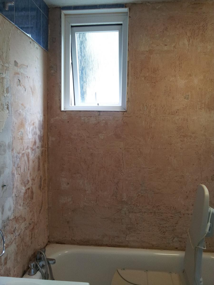

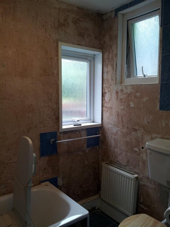

To be honest mate I don't know, I have no experience of tiling. There were a few wet bits of plaster left this morning, scraped them off gently and underneath it was all dry. Some parts of the wall have good plaster on, some parts have no plaster left, and others are back down to the wall. Look at the first and second picture. You'll see where its the grey where the plaster has gone off completely, and the second behind the radiator where its down to the bricks.
Is it possible and safe to use a filler, fill in all the gaps where there's no plaster as well as where there is but some has gone off? I really need some help with what stuff I need to buy so I can go get them tomorrow morning.
