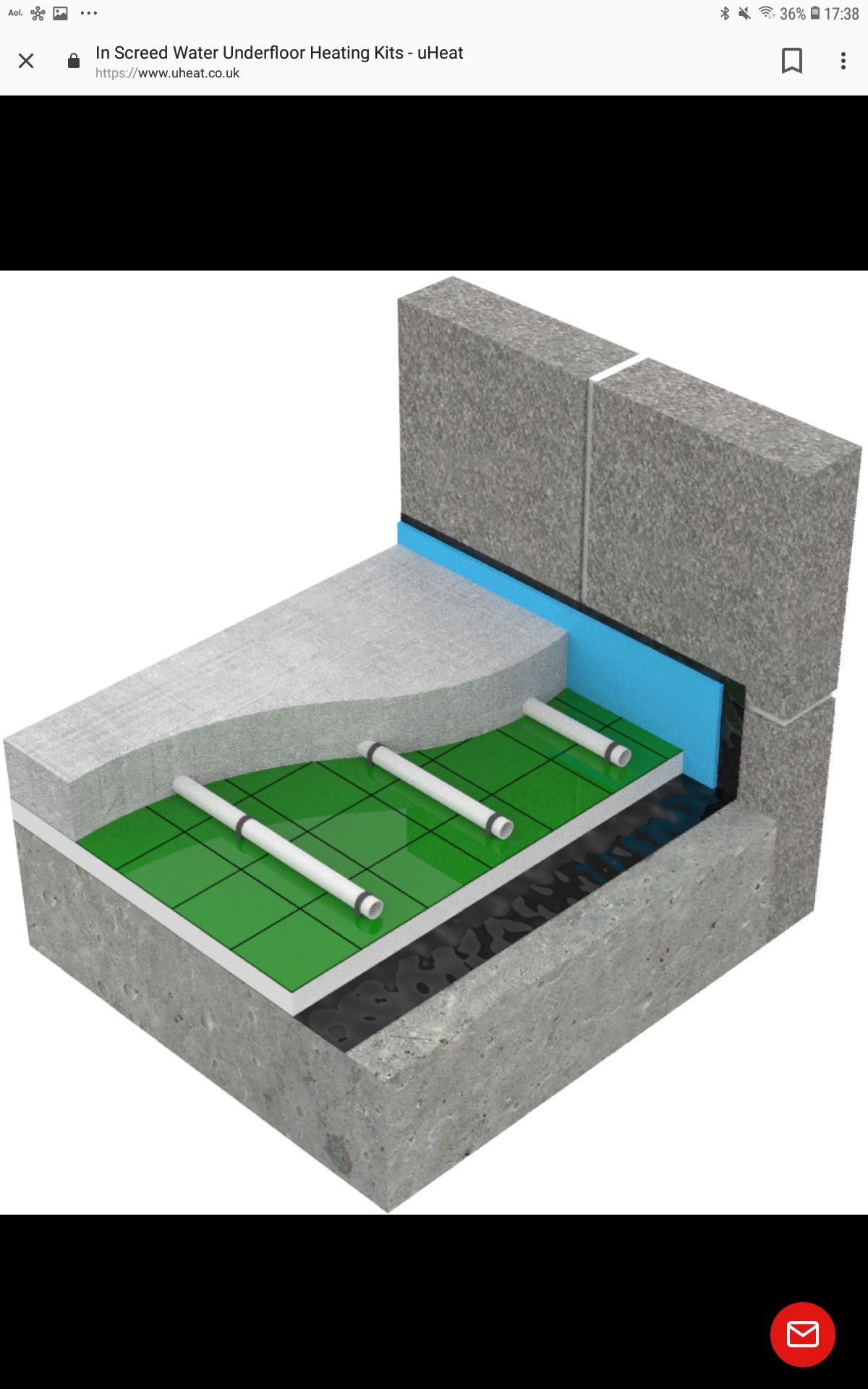

Are you planning to lay heating pipes directly to your concrete without insulation beneath them?
This system was recommended to me by the underfloor heating people so that the heat is retained in the slab and slowly releases throughout the day.
It wouldn't be lost, there's 100mm king span underneath and 50mm king span on all 4 sides.
My only issue is that there's 42mm between concrete and finished floor.
