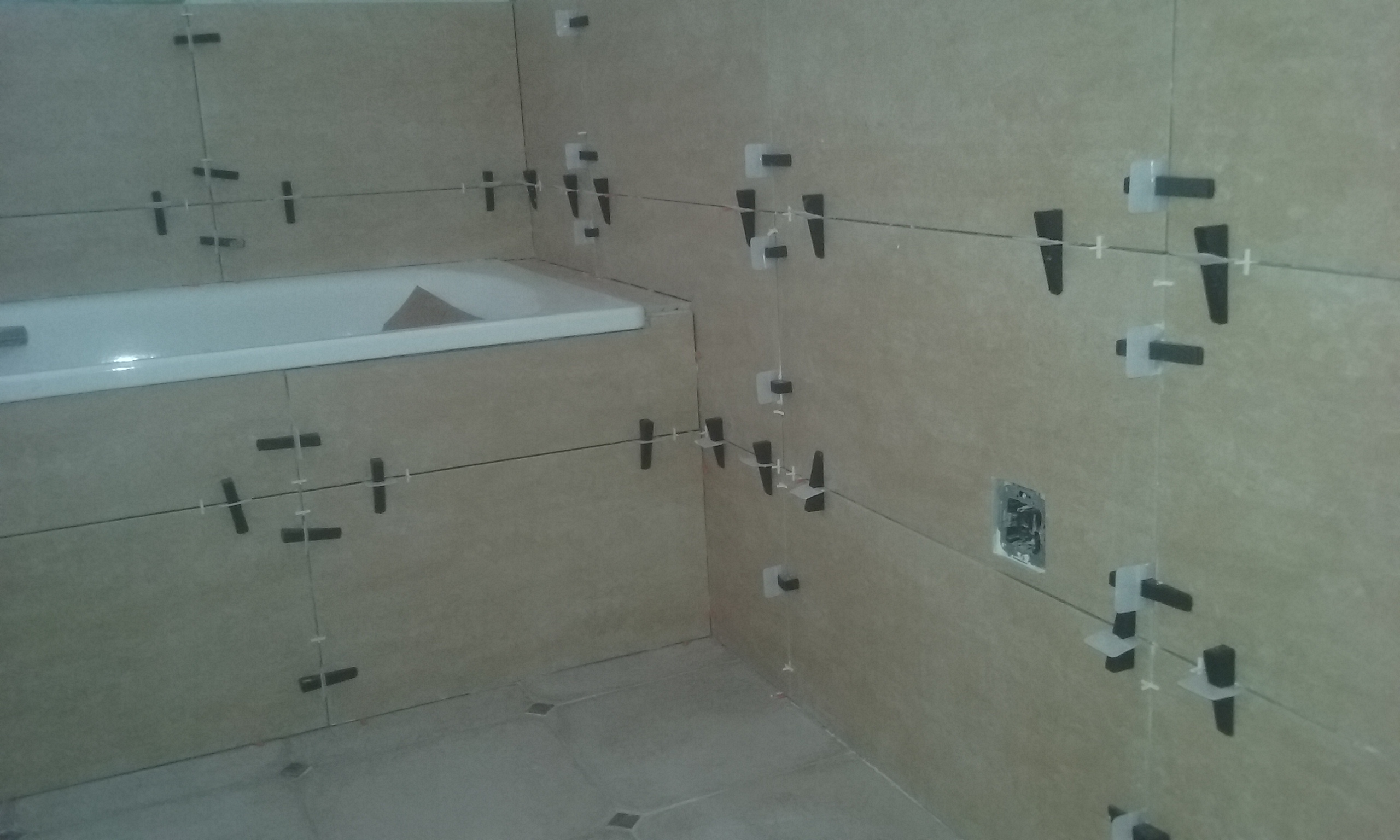

I gave mine a proper chance on some 750x750's a couple of weeks ago, they really are very useful in the right situation.
I'd be struggling on this job without them.

The clips & wedges only have one flaw & that is they move the tile from the grout line & you have to check & triple check everything for movement, the MLT won't suffer that problem as your pulling the cap straight down onto the strap.

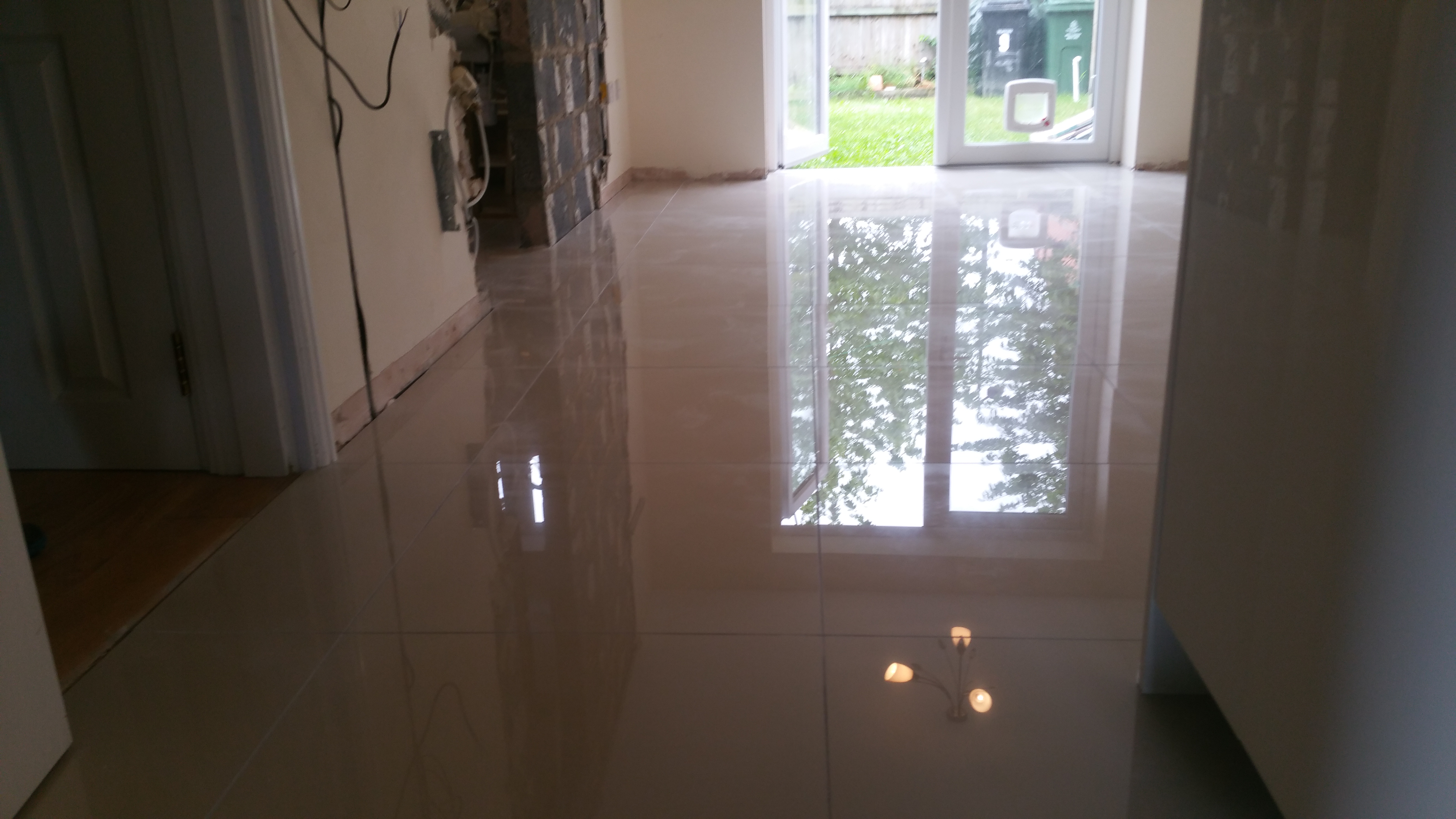

So folks do you not think it's reasonable to lay large format floor tiles without using levelling clips . I tend to use level and grout bucket across face of tile to check there is no lippage.
U don't have to use level clips if u don't want it's like u don't need to use a van to get ur gear to the job u could load up some donkey's with ur gear they both do the job
