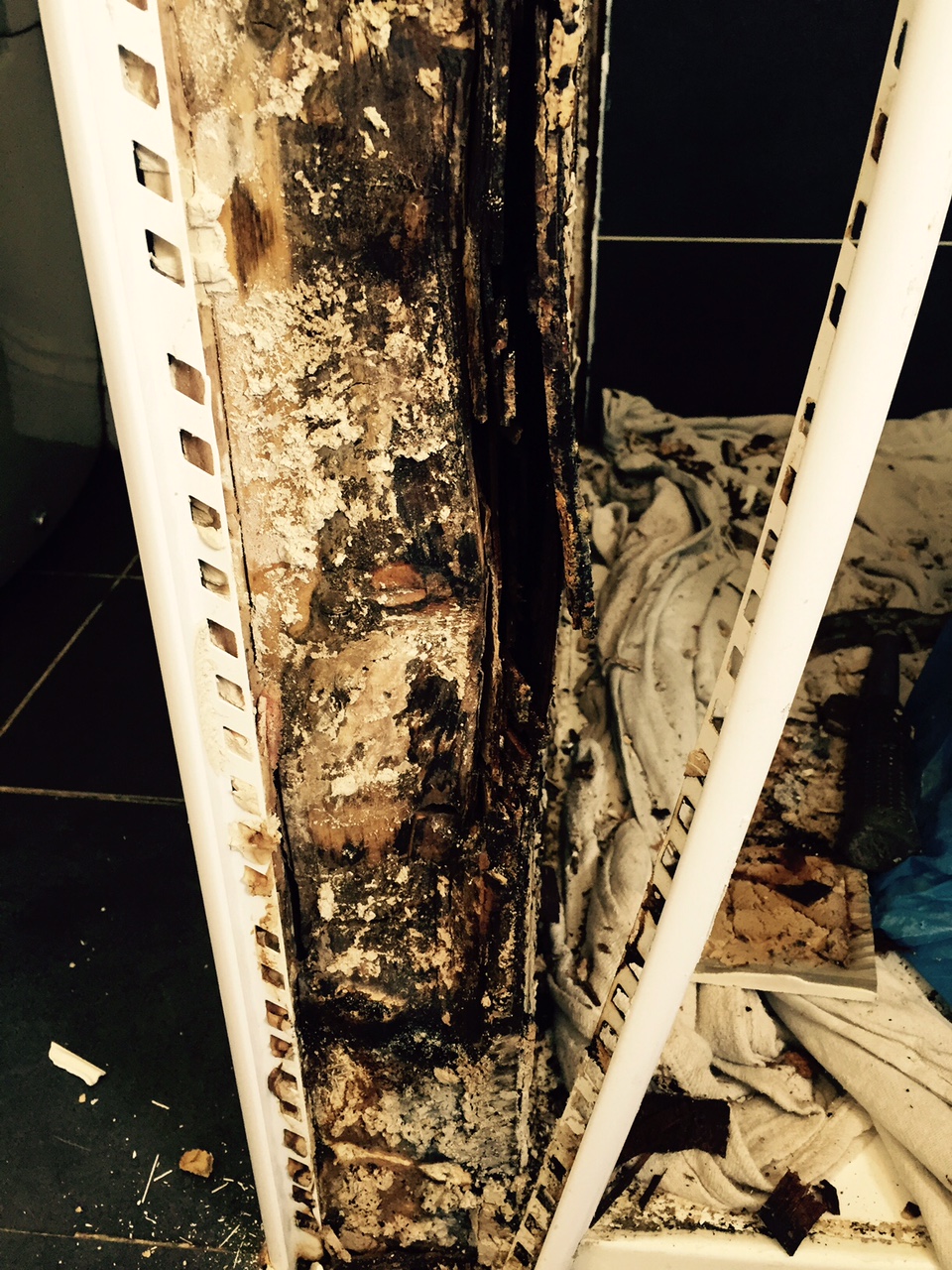

I framed out a 3 sided walk in shower, insulated it with 100mm celotex, lined the area with 12mm marine ply, primed the ply with weber primer 360, i used a unibond readymix bathroom tile adhesive, 150x150x5 basic white tiles from B+Q (i buttered every tile) then grouted the lot with Mapei Flexible wall and floor grout for kitchens and bathrooms.
8 months on i saw i little movement on 1 tile and decided to investigate!

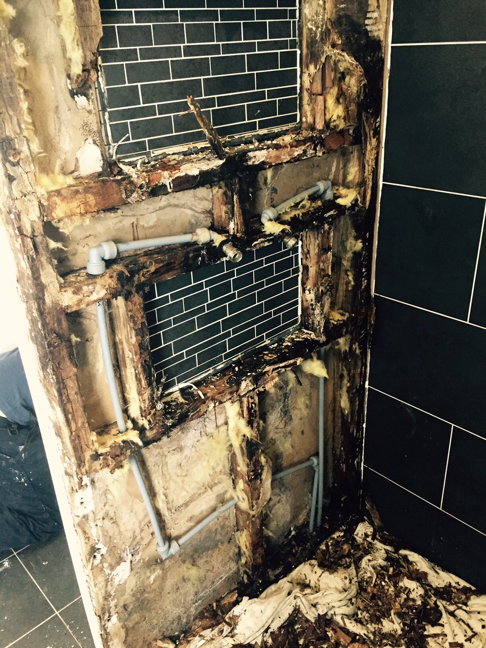

i pulled the first tile off and there was thick black mold behind it, which lead to the next tile and the next etc, ive had to remove the bottom 7 rows on all 3 sides because of this black mould. even the ply was soaking wet ive removed that too.
the plan is to dwang the joins and patch in with new marine ply after that im stumped! i dont want this happening again!
Where did i go wrong?

Honestly?
Strip it all out back to frame.
More noggins.
Board with 12mm Hardibacker or tile backer board.
Stagger joints.
Tape joints.
Tape between shower tray and wall.
Use shower tanking kit like Ardex WPC.
Tile using bagged tile adhesive not ready mixed.
Grout
Silicone
Leave for 7-10 days
Shower
Jobdone! :D
It'll save u time and grief in future, to just start again.
Put it down to experience and never use ply or tubbed again.
That's what I would do.

Ive cut out everything to head height, all seems stable, dry and mould free above! ill stick some noggins in and patch everything below with hardibacker, and whack some Ardex on. I hope i can find that or something similar tomorrow at TP, Jewsons or B+Q? Yikes the wife is going crazy i need to get a move on with this! wait till i tell her she has to let the grout dry for 7 days! lol

I've ripped out a lot of showers where ply has been used & they were all the same, black mould everywhere.
Wood & water don't mix.
You would have been better using standard plasterboard & tanking that.
I would use wedi or marmox boards (there's plenty more out there) & as they are waterproof then it's only the joins that need taped & you won't have a bit of bother.
I use Mapei Aquadefence for waterproofing showers before I tile & it's very easy to use.
Sorry folks ive been busy. Ok so there are probably many contributing factors as to why it went wrong in 8 months. Having said that i did prime the ply i did butter every tile meticulously, let the adhesive dry for 24 hrs as it advised, i squeezed and worked the grout very carefully into all the joints and sponged off leaving perfectly even grout line and let it dry for 24 hrs as is advised, i thought i had done good! it looked perfect. i still cant believe it failed so quickly.
I have now cut out all the ply up to head height on 3 sides, dwanged and fitted hardibacker, primed, taped joins, twice tanked, and laid new tiles on 100% bed. BUT im still nervous as on closer inspection the cheap B+Q tiles have varying amounts of glazed cover on the edge of the tiles varying from 0.5mm - 2mm! Secondly, i just noticed the bagged adhesive i purchased at B+Q was 3 month past its use by date. Thirdly, because im patching in i am held to the previous pattern and spacer size but i have noticed on the tile box it says "only use spacers of 3mm and >" i however had to use 2mm to match the existing! does that mean the grout dries to quick and loses integrity? should i seal/prime the open grout lines before grouting to slow the suction rate? I hate tiling......
