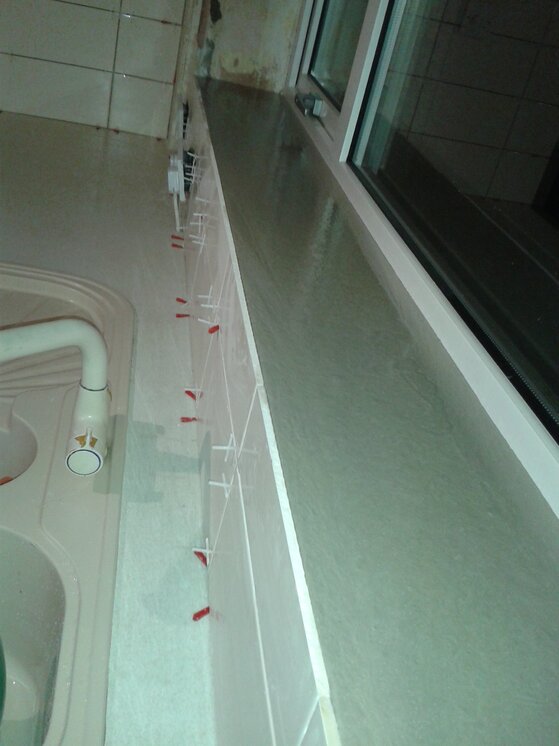

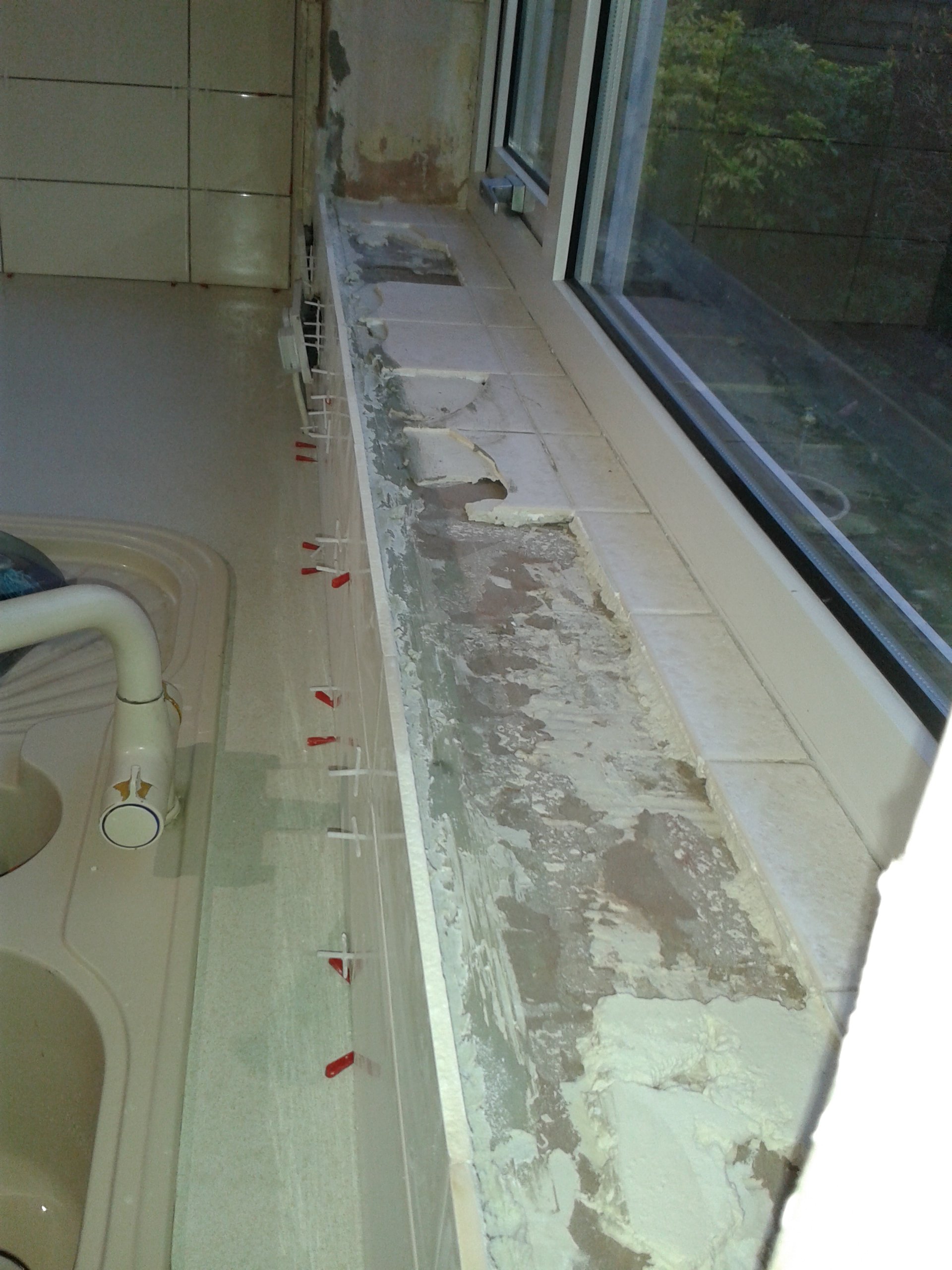

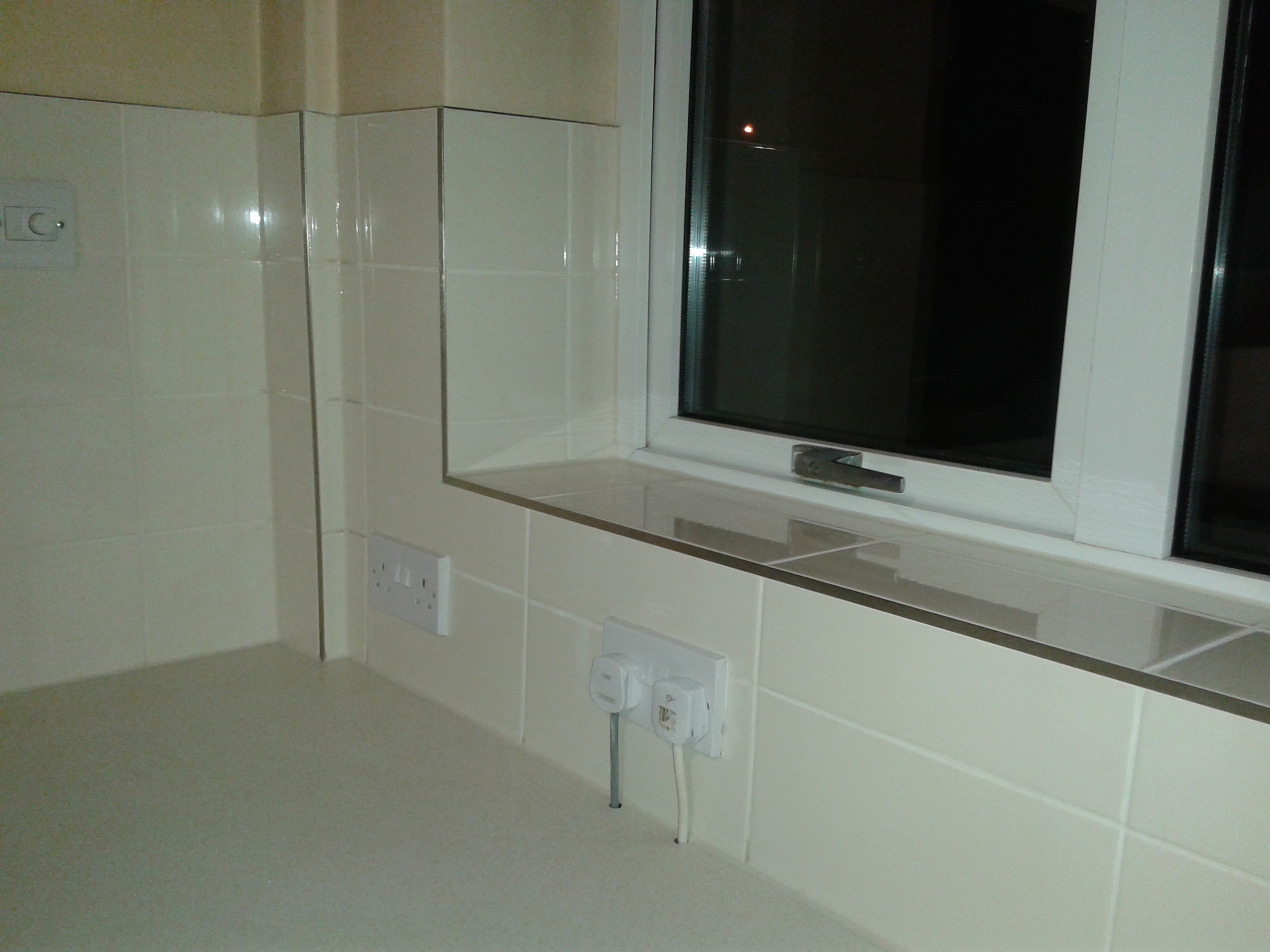

Had a window sill that I wanted to raise by 40mm to avoid slither cuts yesterday. I normally use cement or plaster board but for speed and ease I thought I'd try SLC.
Had a freebie bag of BAL max level in the garage and poured it at the end of yesterday and finished the job today - worked a treat.
