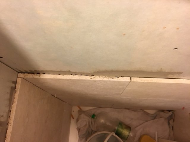

1. the first thing he did was put Mapei Primer G all over the tile backer board. I didn't think tile backer board needed primer.

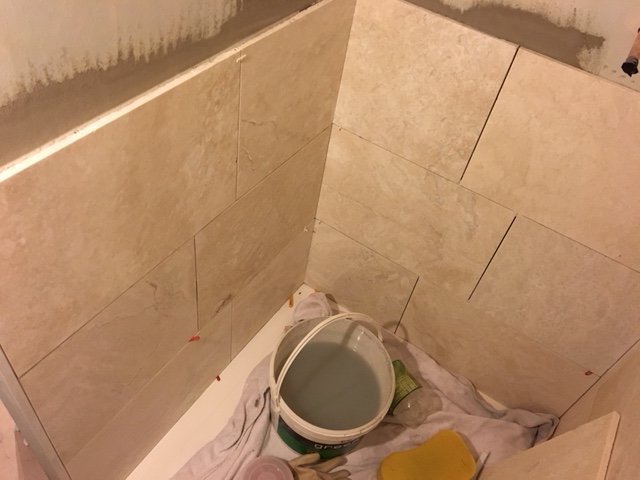

2. he has used Dunlop Set Fast Plus Flexible Tile Adhesive which is grey and doesn't say it's for use with large format natural stone.
3. he has used a 2mm gap for the grout and I thought it was supposed to be at least 3mm for large format natural stone.
4. I can see voids in the adhesive behind the tiles.

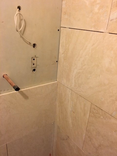

5. He has laid out the tiles so that there are narrow strips down one side of the wall (whole / half tile at the other end) and hasn't continued the layout around the corners.

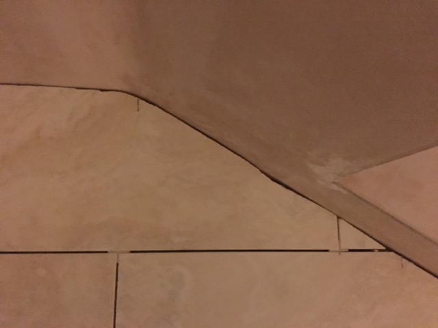

8. He cut one tile around the shower tray wrong and has fixed it by putting a slither of tile in there!

Hi, if you mean he primed the cement backer boards then that’s ok but he should have taped and tanked the boards in the shower area. Natural stone is fragile and when transported can have hairline cracks that split as soon as you touch them, I usually keep them in the hope they can be used for a cut somewhere. That would explain a few of the broken tiles but rest looks as tho he was pushing them too hard and too quick thru machine and they have broke IMO. The sliver is not professional and tile should be replaced. 2mm joint is a preference I prefer 3mm.
When I set out stone tile half bond I try to fold them round the internal corners ie whatever you take off cut use the other piece on next wall so that same tile, shade and vien turn the corner.
