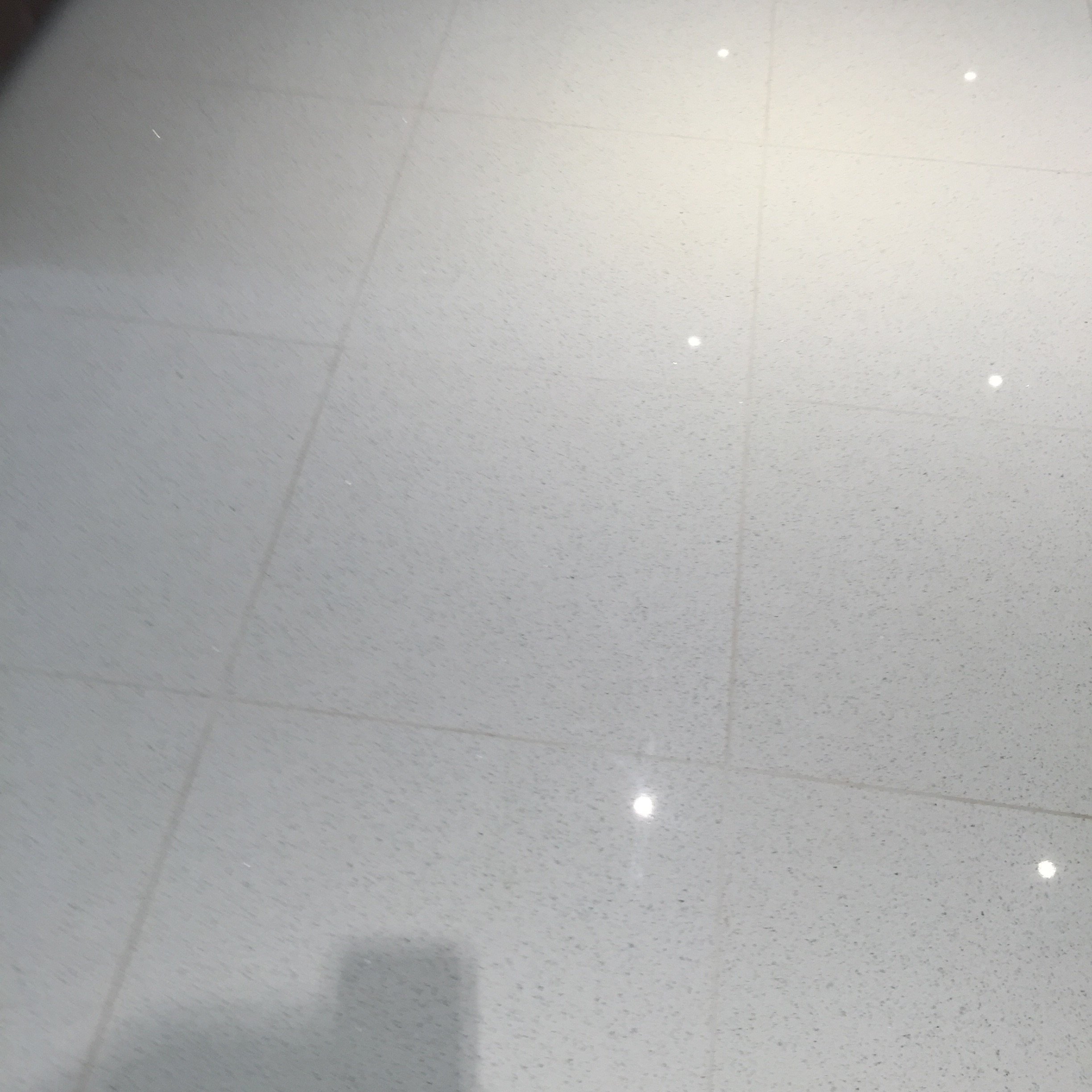

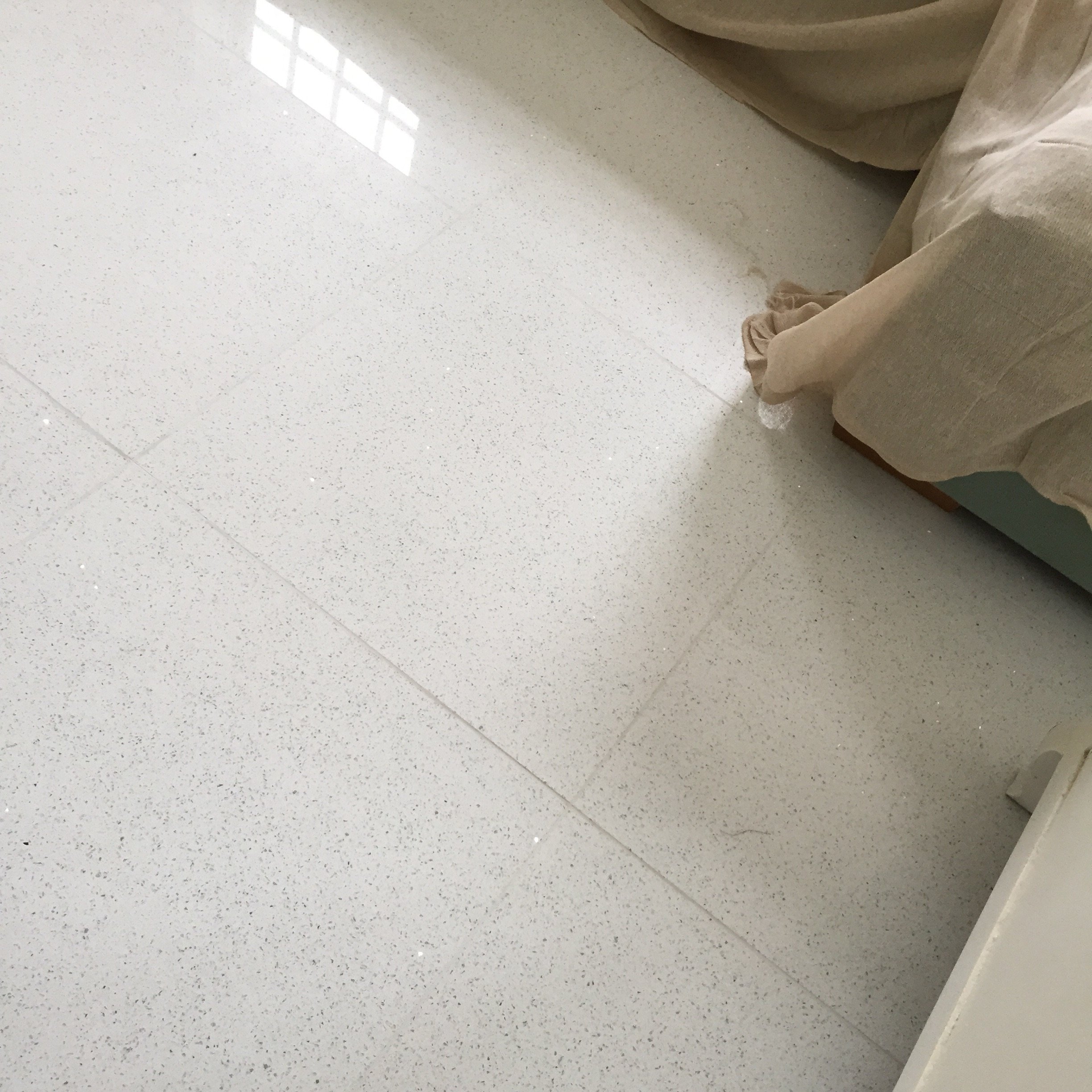

Here's a few pictures of it, not the best sorry I'll have to get some more
