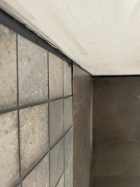

General lippage on the walls was "unfortunate" and he is not prepared to reinstall tiles that have the problem. I estimate that 15-20% of the tiles on the wall have the issue. Is this within an acceptable professional standard?

He says that you can not get mosaic tiles level so they lay how they lay, there is nothing he can do. Before they were installed the wall was a bare plaster wall with some bits of plaster missing due to removal of previous tiles. He applied some kind of filling compound to fill the gaps. On seeing this I questioned if it would make the walls flat as I was worried that if he didn't board the wall or if the wall wasn't flat it would affect the lay of the tiles. He assured me is what he was doing was fine. During review he states there was nothing wrong with what he has done. I believe that the wall was obviously not flat and is the cause the issues. The pictures don't do it much justice. The bottom is approx 3mm protruding, bowing is approx ~2mm and the top is recessed by ~4mm so it is very obvious to the eye.

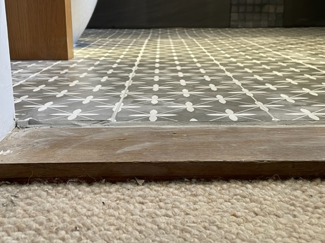

The entrance to the bathroom now has a lip approx 8-12mm. He has told me the job was to install the UFH mat and floor tiles and it is not his problem that they are higher than the threshold. At no point during the installation did he mention that the floor would be higher than the threshold, (I wasn't expecting it to be as the uninstalled installation was UFH and stone tiles so I don't know why there is such a difference). He will not provide a resolution to remove the trip hazard and said that it is my problem.
