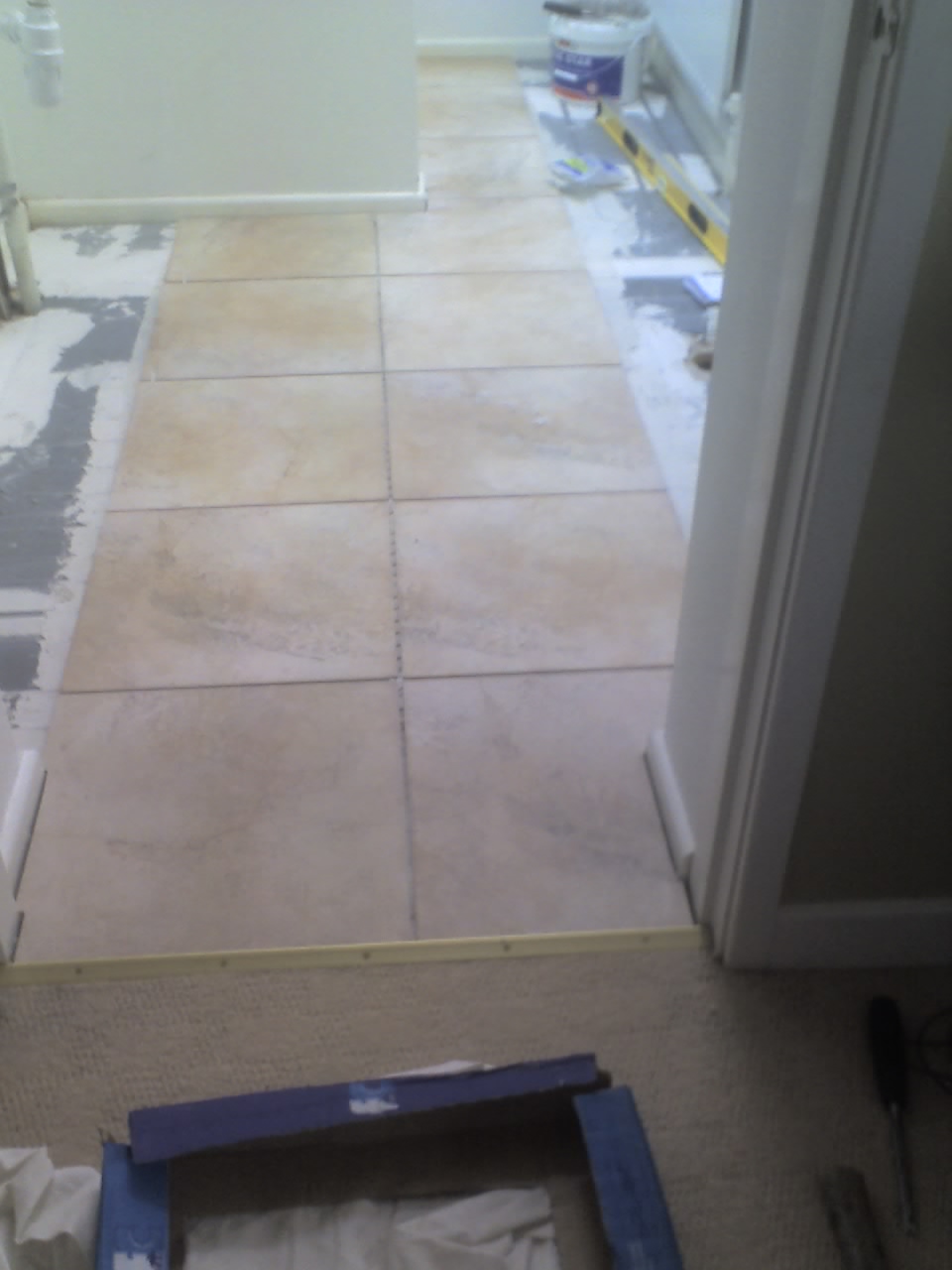

Ive just done a floor in simiolar tiles, porcelain, didnt need sealing as were glazed. As said before, mix only half buckets full of addy at a time.
Im relatively new to this game and managed this in 30 mintes using Bal Rapid Set white addy with porcel bond.
Use a 10mm whell on a dry cutter, score once and once only , very firmly and use a snap action to snap the tiles with the handle.
Take your time and post some pics when done.
p.s. mine was over under floor heating so had to be very careful

GatesheadCol, thanks for your advice. How did you cut the corners around the doorway etc, I presume you used an electric wet cutter?
Yes mate I used a wet cutter. Went through 2 blades doing both the bathrooms too as they were really hard porcelain tiles.
