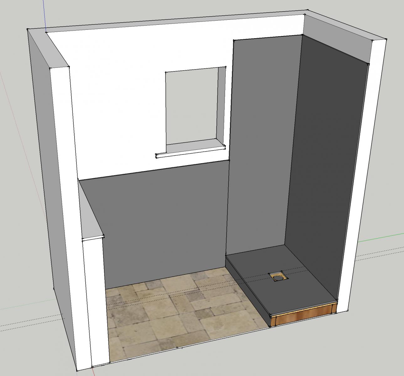

I've spent ages researching our different options and think I now have a basic plan which I was hoping somebody here could validate and make sure I'm not going to do something stupid. The width of the shower alcove is 104cm which annoyingly means any shower tray is going to be either too short or too long. I'd prefer to avoid building out the wall or chasing in the tray so the plan is to do a custom tiled tray on a plinth (to accommodate waste - the sub-floor is concrete).
My current thinking is:
* Construct plinth out of treated 2x4, board over top with 18mm exterior grade ply, cut hole for waste.
* Line walls of shower with suitable water resistant/proof tile backer board - there seems to be lots of options here - up to similar height as existing tiles (about 1ft down from ceiling)
* Line front of plinth with tile backer board, then fix Marmox showlerlay to top of plinth
* Tape all joints using suitable waterproof tape
* Tile walls, tile tray (FIL recommends using mosaic tiles for tray, I'm aware these need to be at least 50x50mm for Showerlay)

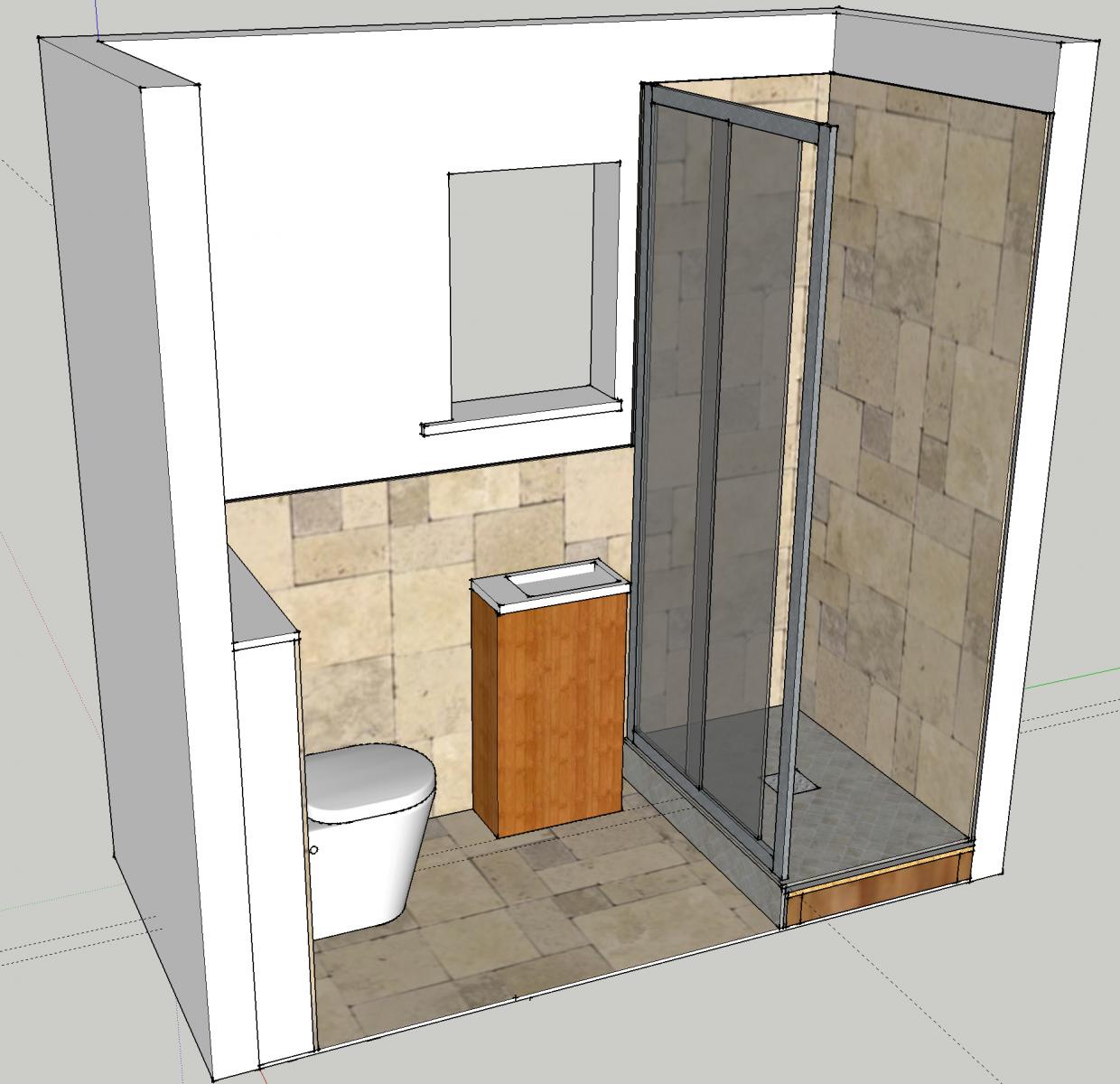

We also plan to replace the existing sink with a slimline vanity unit, fit a new towel rail (current one is too big and rusting) and I'm quite keen to replace the toilet with a concealed cistern/back to wall toilet, perhaps even a wall hung one.
