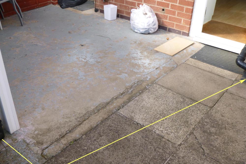

I think I have decided on my tile for an outdoor but mostly dry space protected on 3 sides but can have rain blown in - see picture. The tiles are PEI rating of 5 this full bodied porcelain and come unglazed. I then start reading about stains and sealing and start to doubt my choice (haven't got them yet ) the fella in the store says I do not need to seal, they are these . I have brought a couple to test and have a range of stuff on them to see if they do stain.
The yellow line marks the extent of the roof coverage

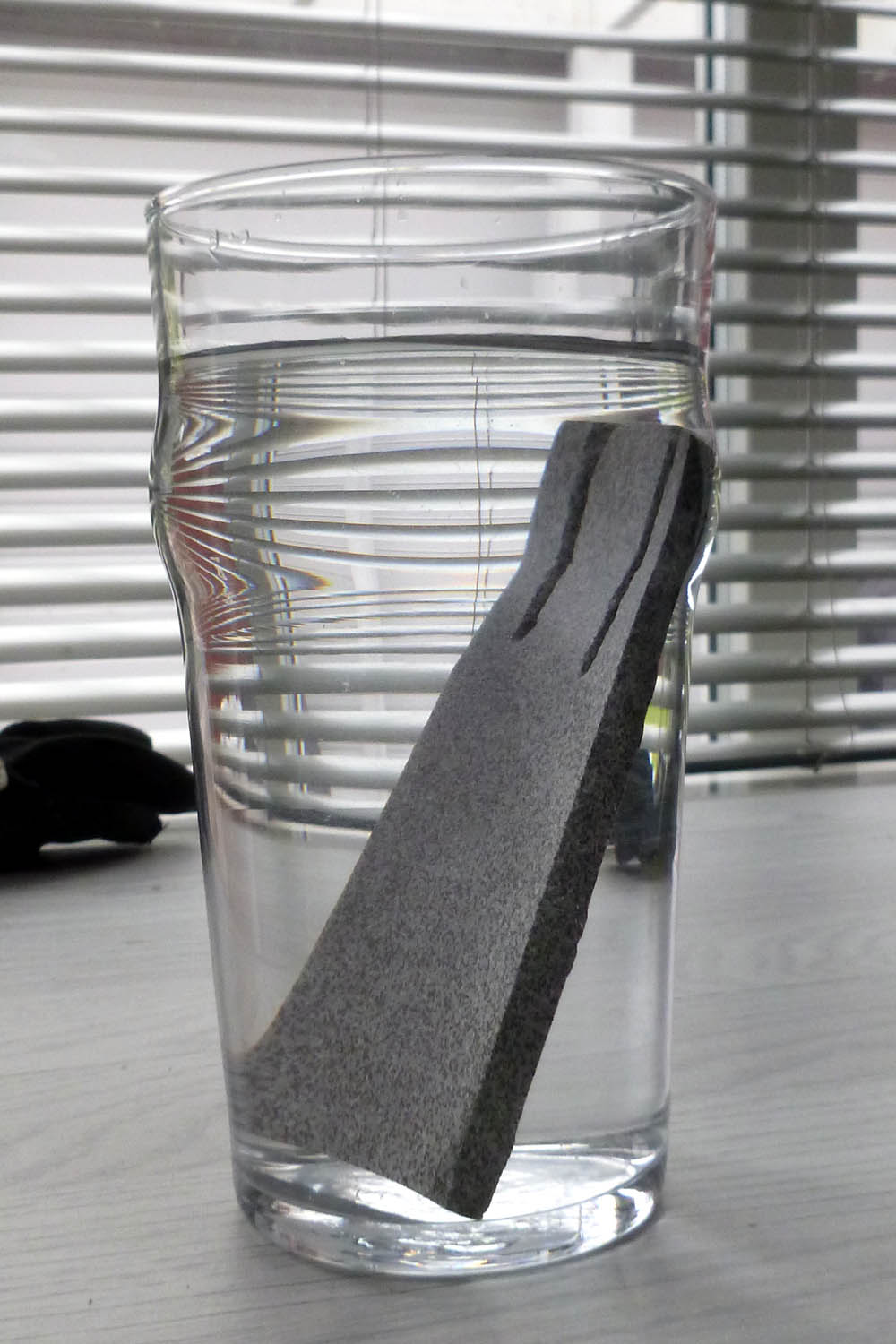

Ok I have come back to answer my own question but would still appreciate an experts view.
I have done some tests with grass,coffee,oil(olive) sharpie pen, biro, vinegar, and left it on for 18 hours. And none it has left any mark whatsoever. I am also ding a water absorption test and so far after 18 hours there has been no gain in the 108g starting sample weight

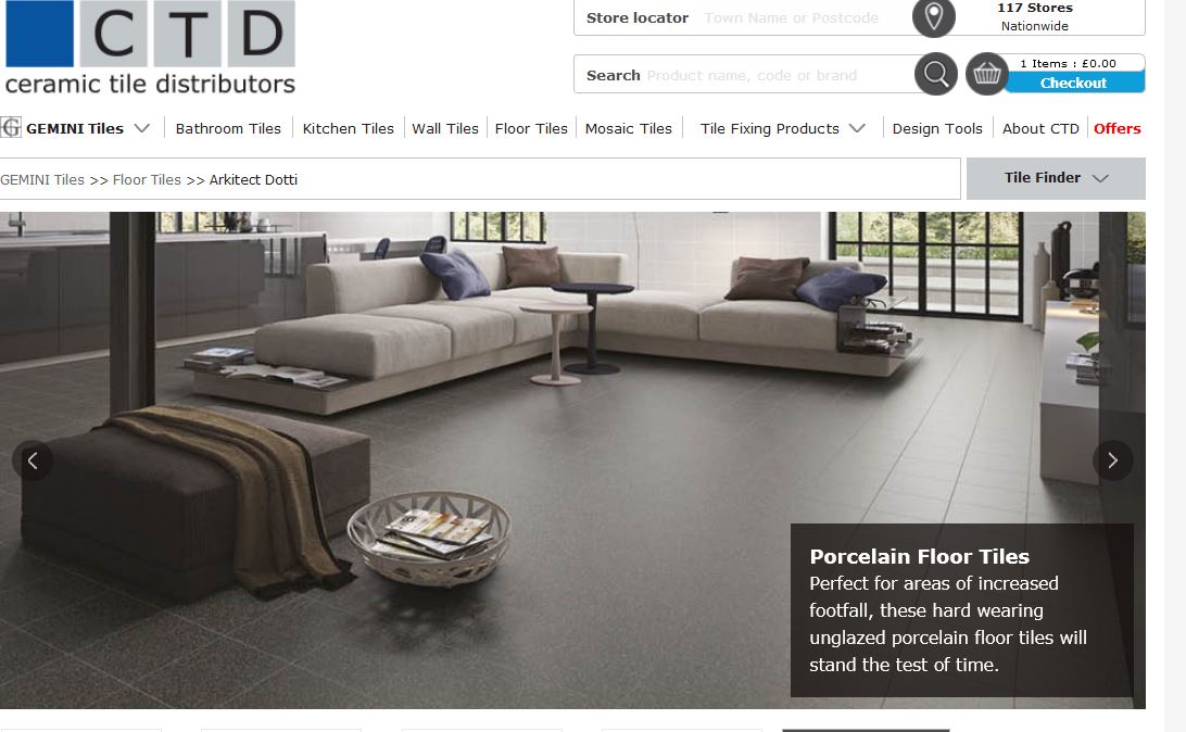

These are the ones
The second slideshow picture on the page says
  • Porcelain Floor Tiles
    Perfect for areas of increased footfall, these hard wearing unglazed porcelain floor tiles will stand the test of time.

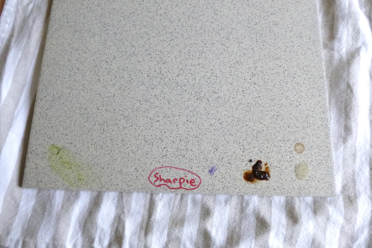

Just seen that my picture was not there with my test tile, here it is. I put a few drops of water on it and then added instant coffe very strong.

I must be missing something, cant see anything that says the tiles are unglazed, just full body porcelain..

Good test, haven't heard of any external grade porc that requires impregnating. Maintain only
Check your grout release on install, on a spare tile maybe, with the extra texture. a lot of the external boys are using bal temp sealer if they have problems to aid release.

Ok thats the end of the water absorption test because after 24 hours I want my pint glass back.
Result - no weight gain.
2nd result - beer for me
