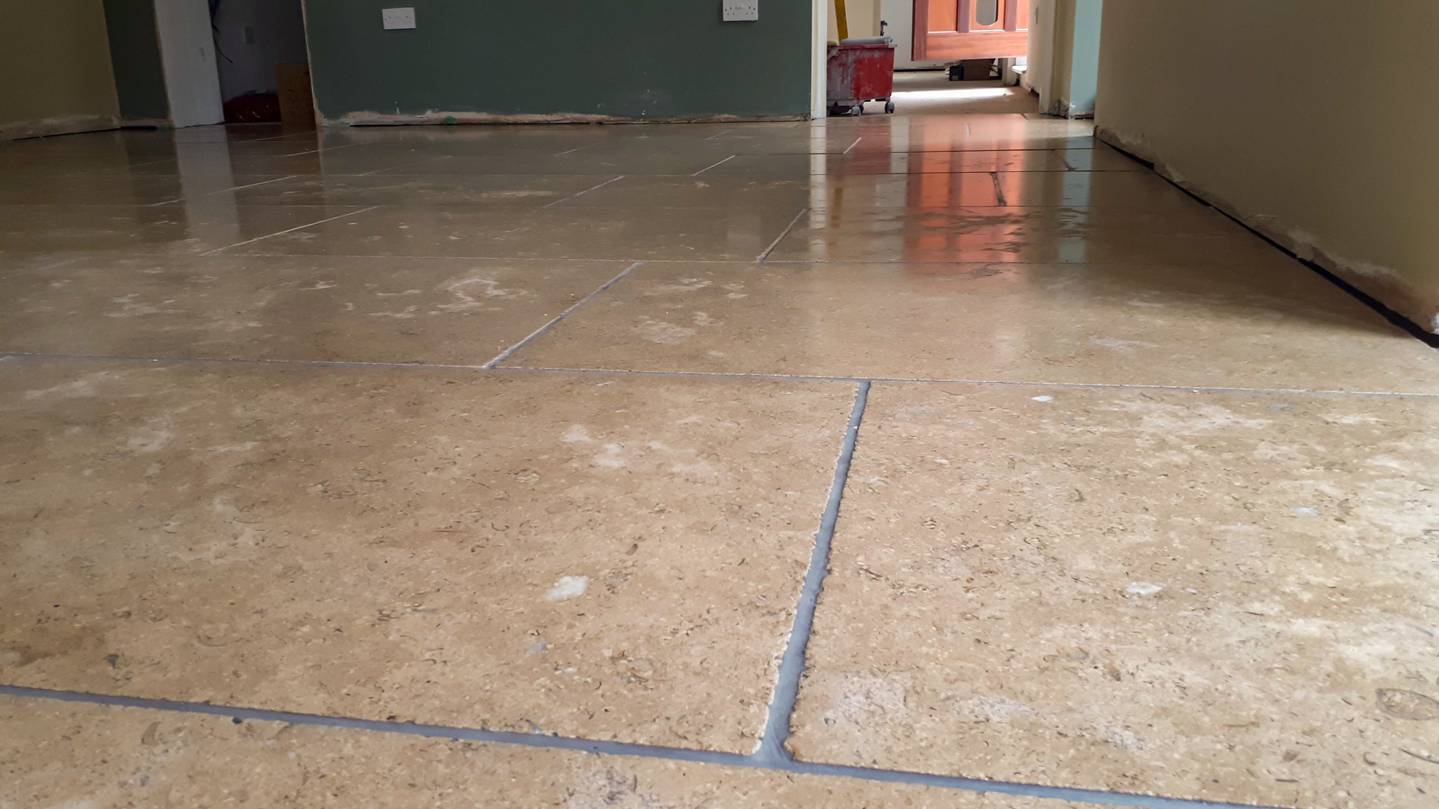

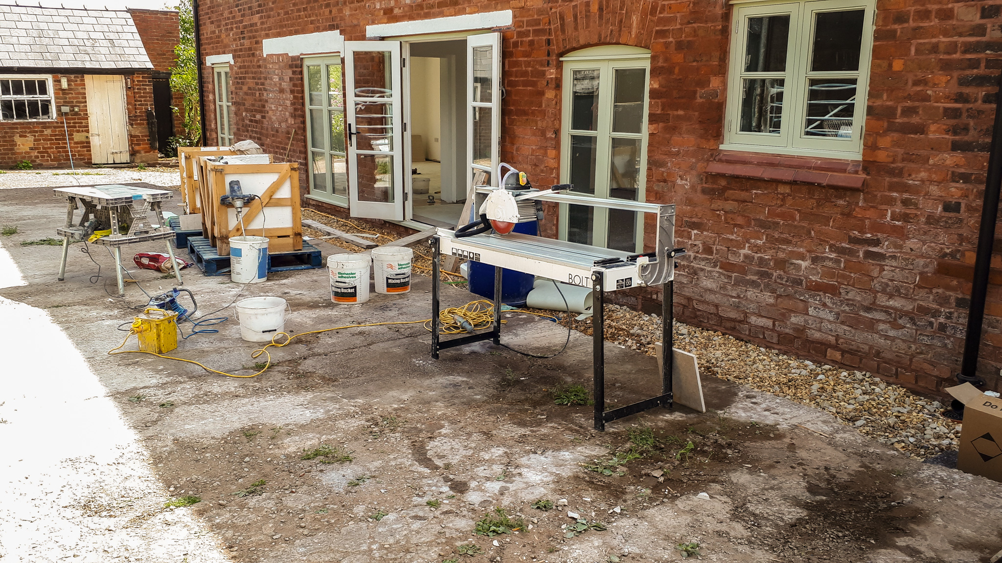

I am doing a job with Dijon tumbled limestone at the moment.
I use both a wet an dry cutter to cut them. A quality diamond blade for stone will be OK .
Dijon limestone is a dense stone and will not stain easily from water ingress.
I seal after fixing and grouting but then I am used to working with stone. I seal after I have finished.

No to a hand tile cutter if you mean a normal ceramic style cutter.
I say dry cutter as in angle grinder dry cutter. If you look at the photo #1 you will see my dry cutter under my workbench.

Water is not likely to stain Dijon limestone, use a good fresh diamond blade and you should not have any problems cutting wet or dry.
Having worked with Dijon limestone in the past id do as mentioned above, give it a good clean and seal it after completion
