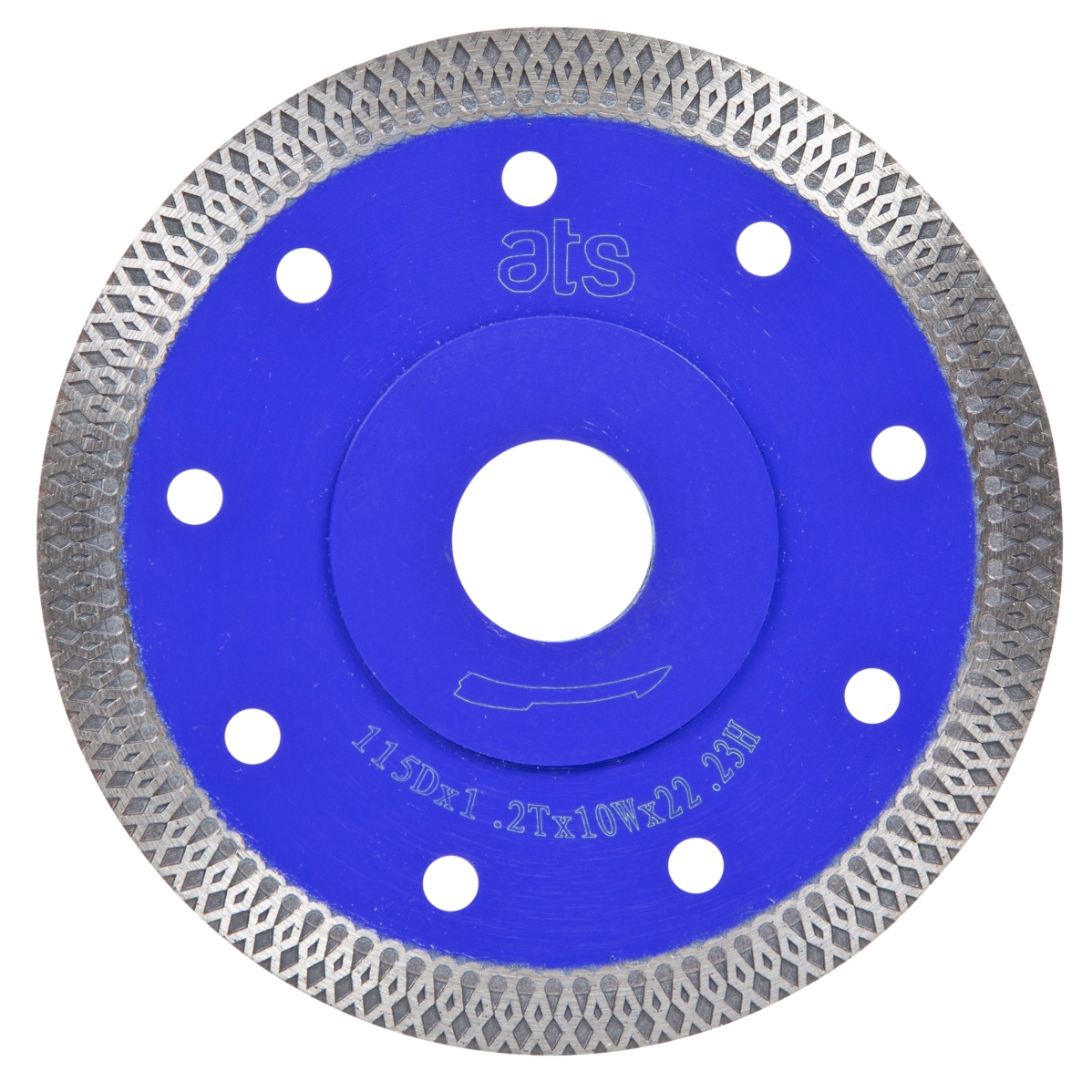

Turbo X Diamond Porcelain Blade
Home / Cutting / Turbo X Diamond Porcelain Blade
Turbo X designed Diamond Blade for angle grinders particularly for cutting hard material such as porcelain, hard ceramics and quartz. Only 1.2mm thick and with a 10mm high segment giving fast clean cutting and a long life. Available in 115mm and 125mm.
From: £11.55 +VAT
From: £11.55+VAT
These are good blades from ATS diamond tools..

Thanks Andy that looks just the job.
I have an old Ishii Big Clinker and to be honest it does the job. It looks like the Big clinker 2 from screwfix.
I will have a try with that and the angle grinder and see how I get on.
