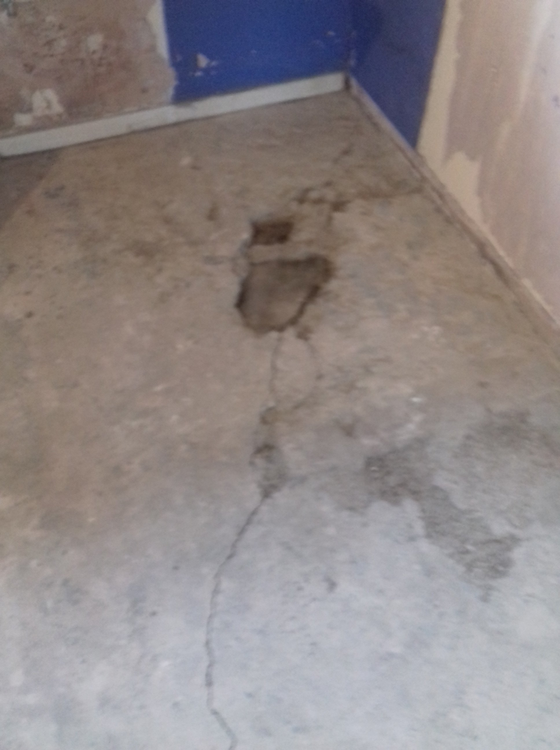

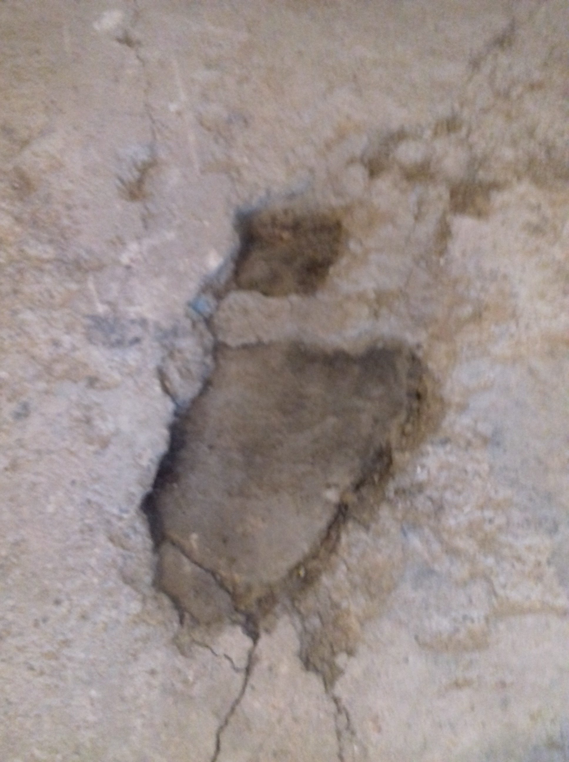

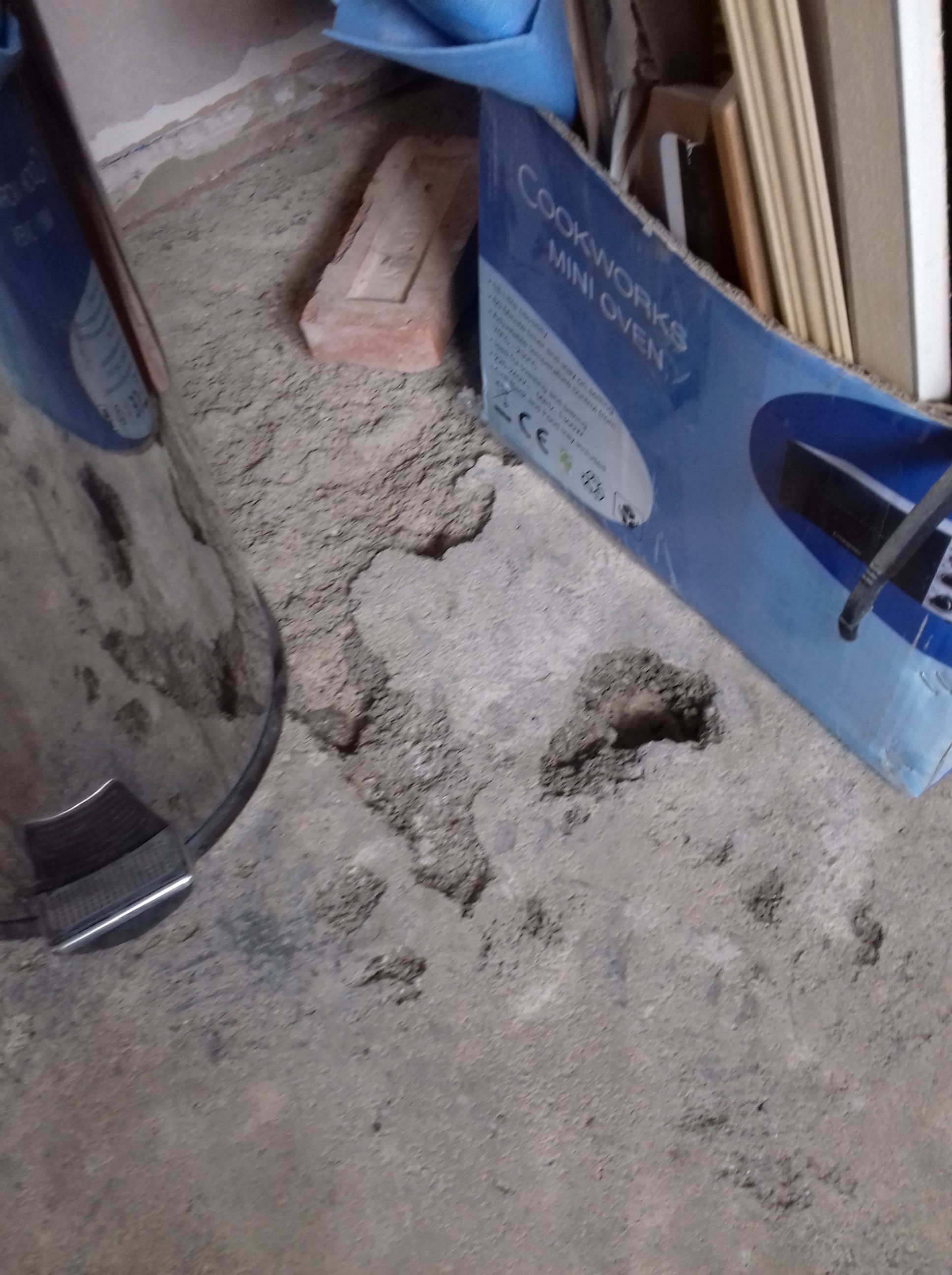

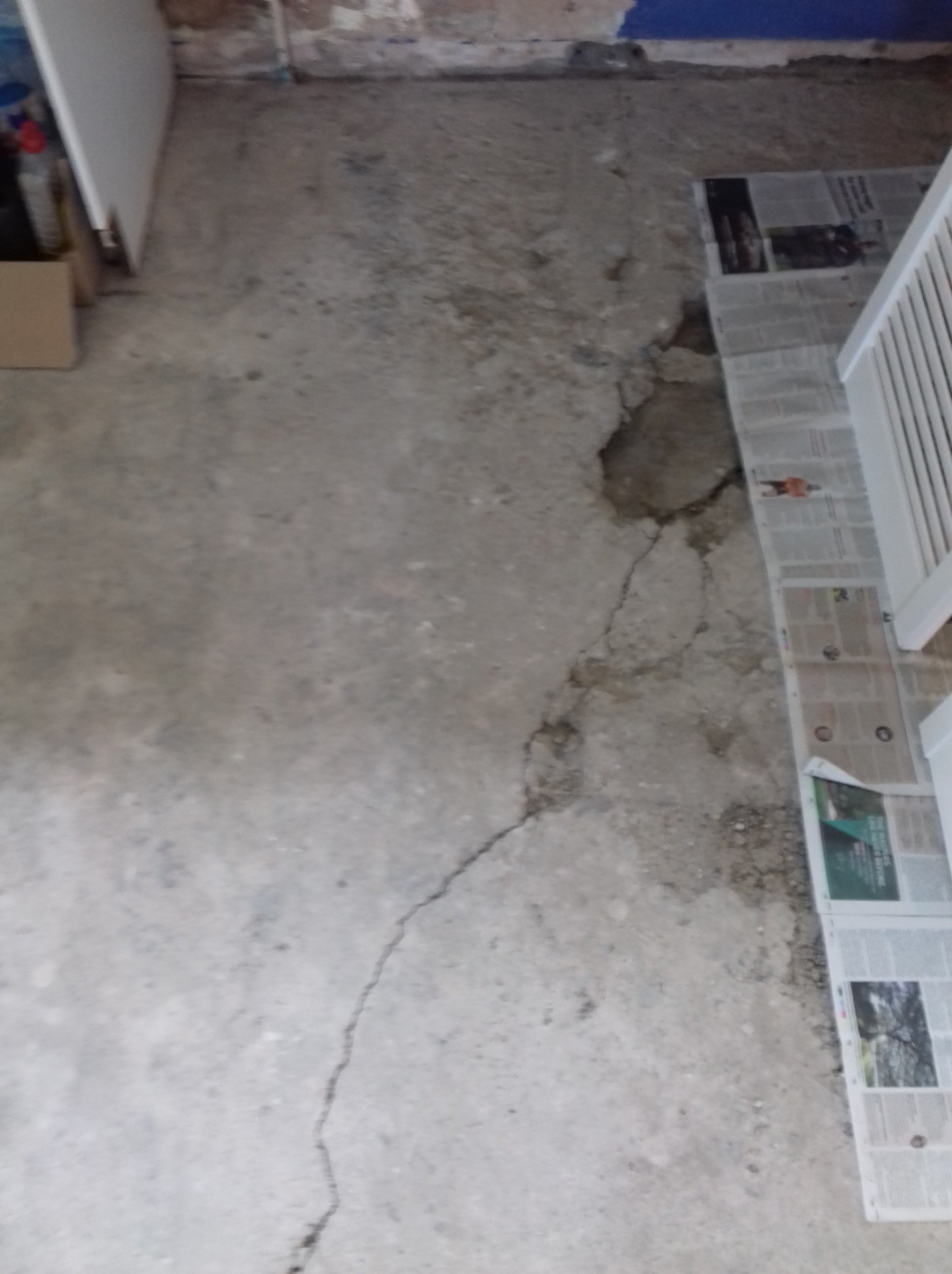

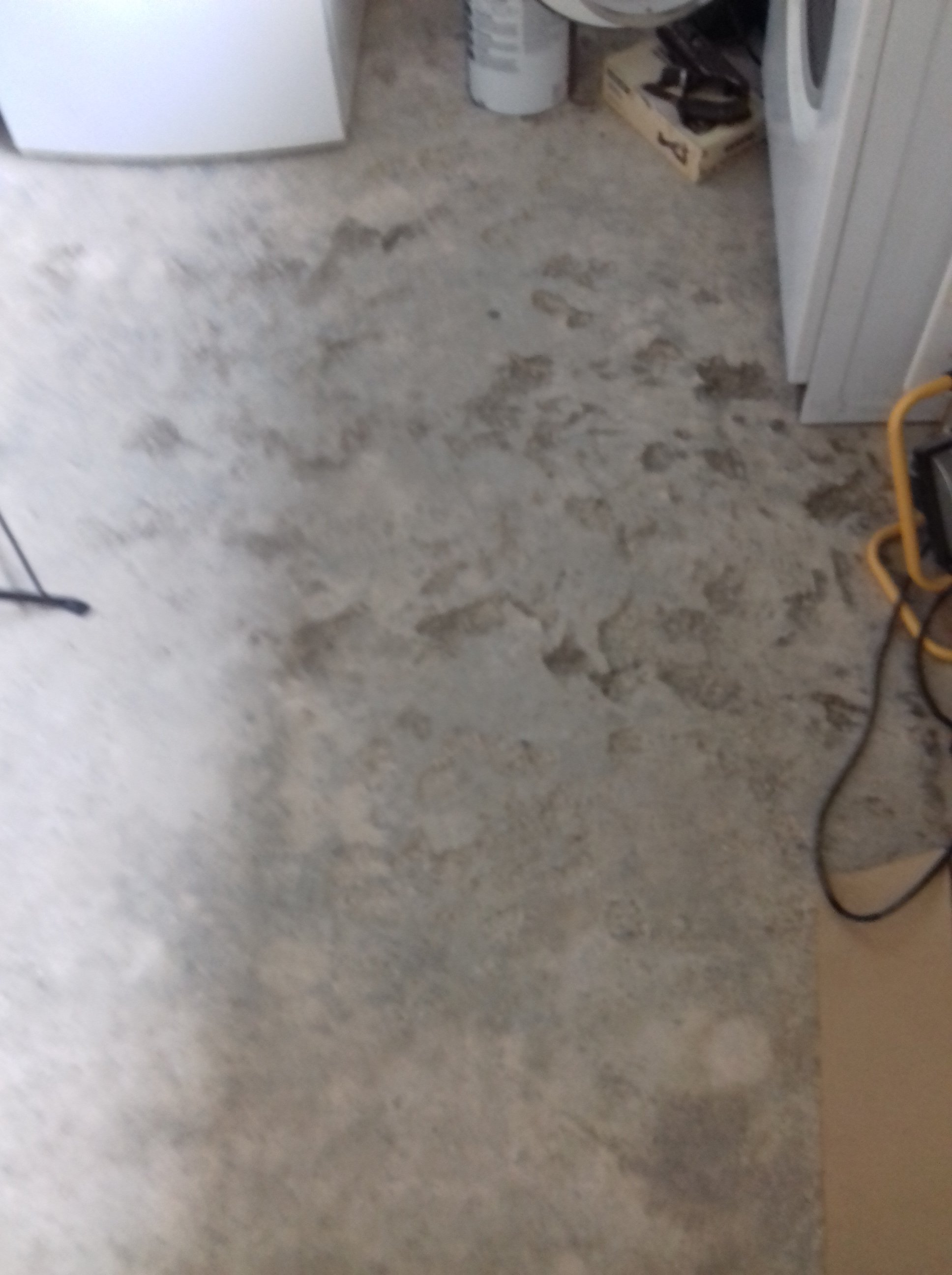

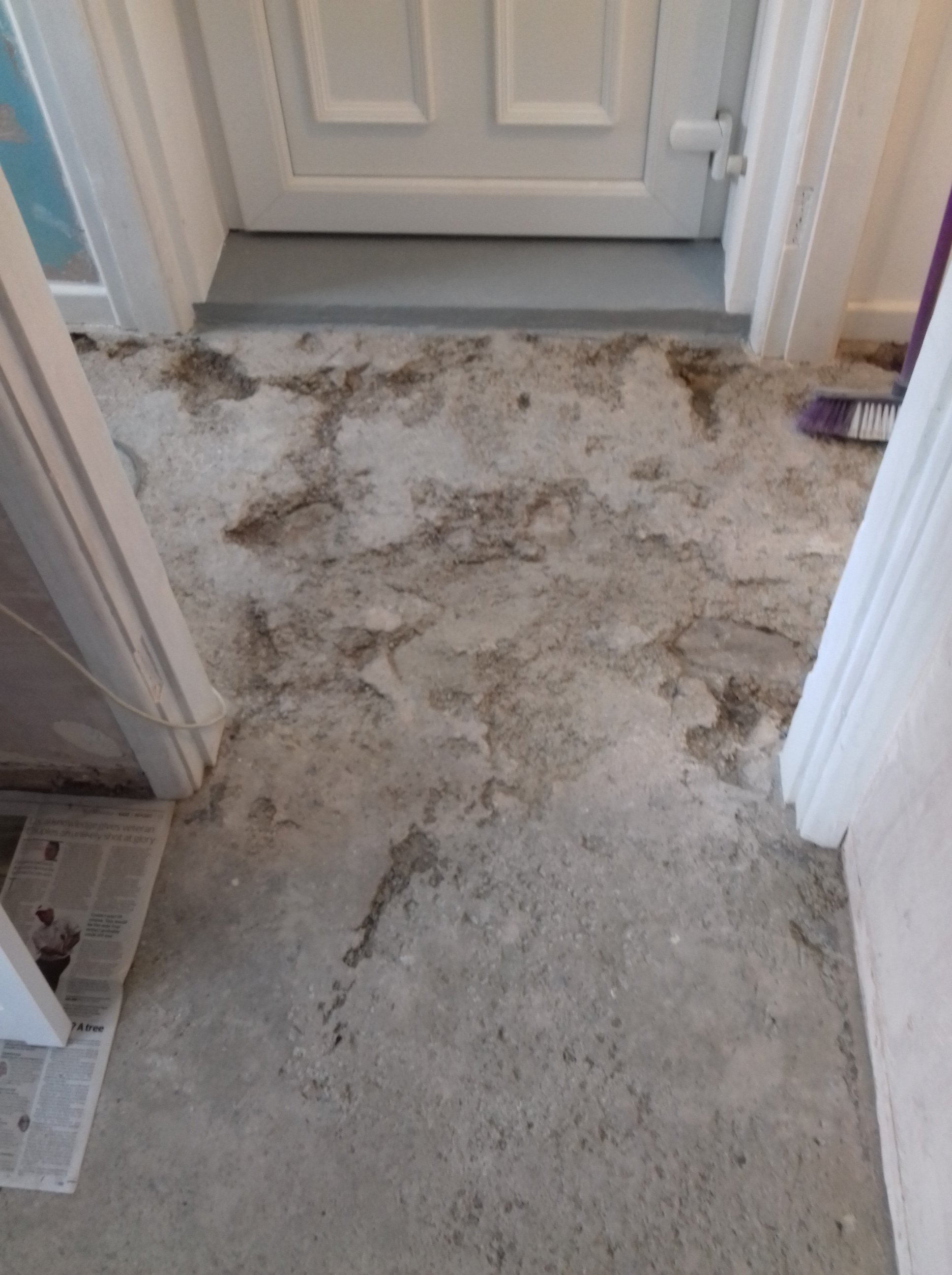

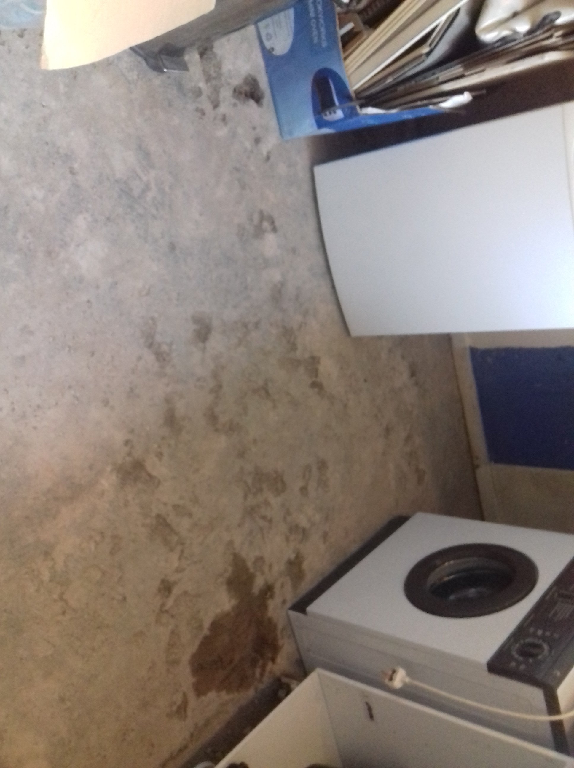

Hi everyone,
First time tiler here about to tackle floor tiles (and wall tiles soon too)
First off just want to say this forum is the dogs - lots of great info and help for green behind the ears types like me!
Am doing up my first property and have a bit of a nightmare in the kitchen. It now resembles the lunar surface! There were 4 layers of tiles (3 vinyl, with marley on the bottom) on top of a layer of bitumen on a concrete subfloor. My plan is to ceramic tile the kitchen and downstairs khazi and put some cheap carpet tiles in the back door area and under stairs cupboard. I removed all the tiles and then on the advice that ceramics won't bond to the bitumen well, took it all up with a SDS drill.
I made a pigs ear of it as you can see. It dug out huge chunks of concrete in places, at worst around 2.5 inches deep!
My step-dad works in flooring and is coming to give it a look over soon but thought I'd best consult you guys too as I'm not sure what the best course of action is next.
The property was built around 1946, ex council, and does not have a DPM. There is a DPC that has been injected in through external brickwork. My understanding from what I've read, correct if wrong, is that the layer of bitumen acted as the original damp proofing and that now that's gone I need to treat the concrete with a liquid DPM, then use a primer, then a screed and level it, and then I can get the ceramics and carpet etc down.
Is that correct? Another source has told me that it would be easier to use cement to fill and level the place, forego the liquid DPM, and then get the ceramics down. I'm dubious of this and obviously want to do this job properly hence why I'm asking.
Also I doubt you can tell in the photos but there are some very small remnants of bitumen here and there still stuck to the concrete. These bits are no more than 1mm thick at the most and are invariably due to the SDS being a pain in the *** and juddering over the top of the stuff due to the angle I was holding it at being slightly too obtuse. Are these small bits going to be a problem with any of the above or am I ok to just leave them there and liquid DPM/screed/cement over the top of it?
Many thanks in advance!
P.S. Of all the jobs I hope I never have to do again, removing bitumen ranks high! I raise a glass to any tiler here who has to do that with any regularity as part of the job!!!
Khazi:
Cupboard (worst bit):
Kitchen:
Back door area:
Bitumen mid-removal:
More kitchen:
