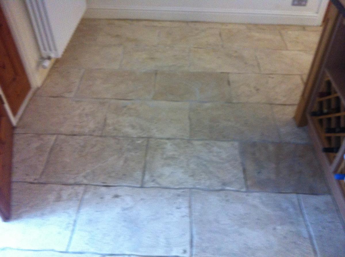

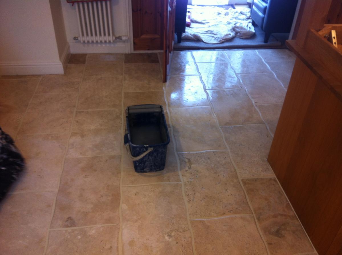

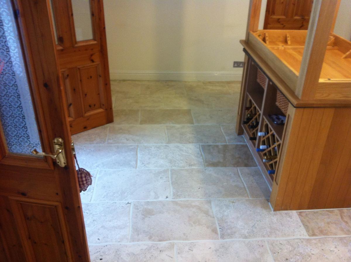

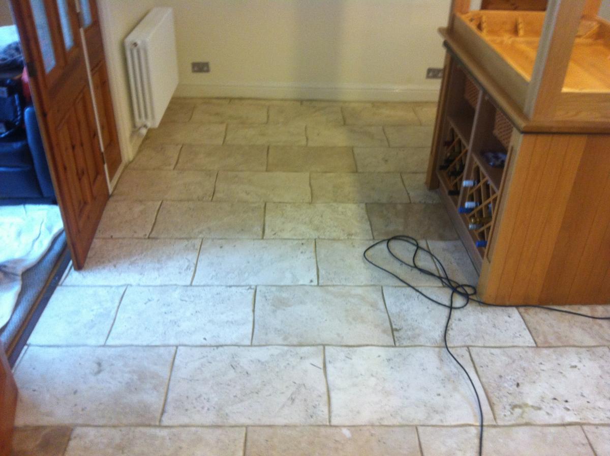

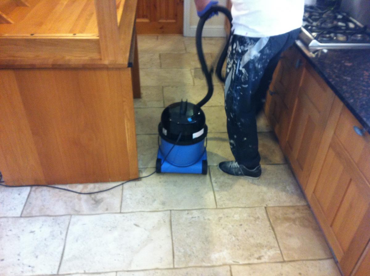

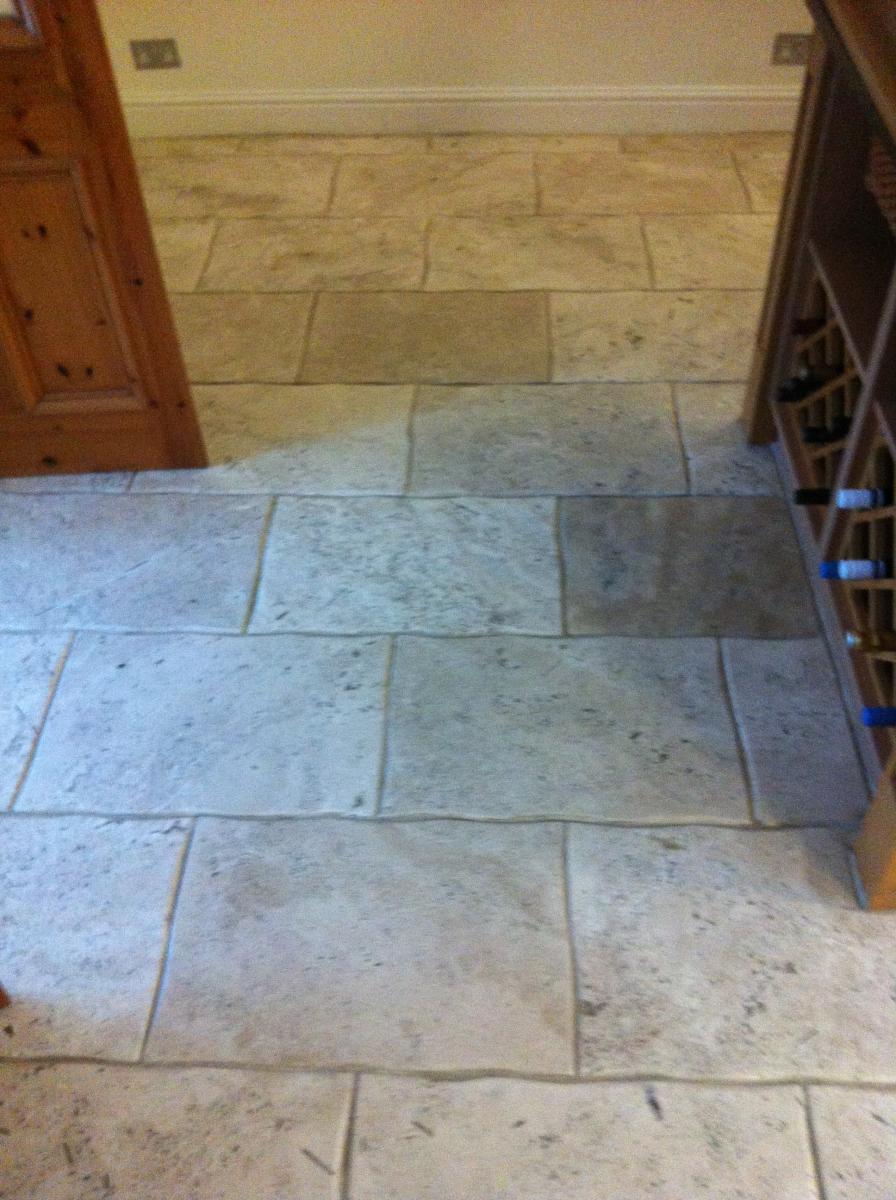

The job in hand is a travertine floor that was rather ingrained with dirt and cleaning products, very shallow and none grouted open pores on the tumbled surface.
They also have a wavey edge with pillowing , so the shallow grout made them harder for customer to keep clean, the job it's self by the original tiler wasn't the best installation and some quite bad lippage and grouting but it is deffo a lot better than it was.
And the slate was not in straight lines but again it was just to clean and re-seal.
So we have used Extreme clean to remove all this ingrained dirt etc... well it actually cleaned them better than i expected when i seen the colour the tiles had become over the yrs..
So we cleaned the floor and seen as the joints were approx 5mm shallow , we re-grouted as well... with ultra cololur in Jasmine.

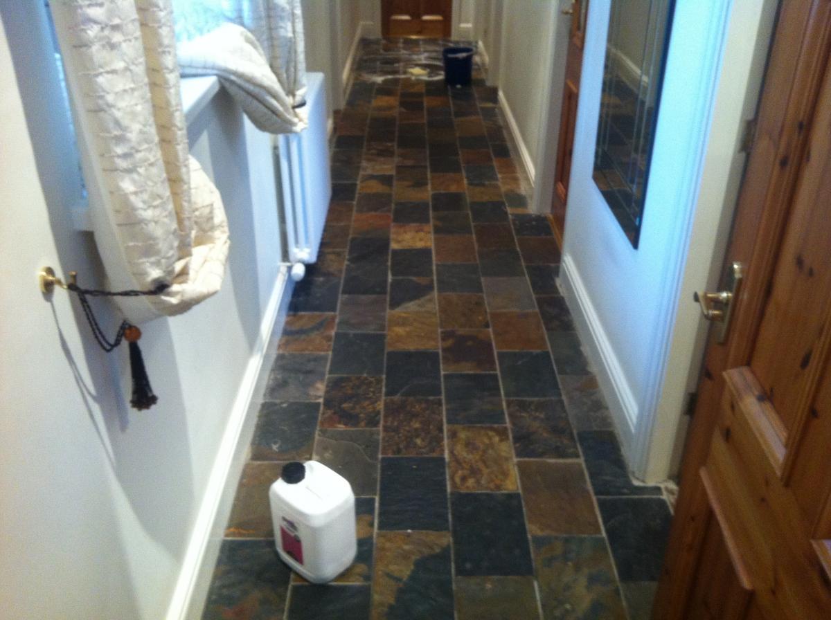

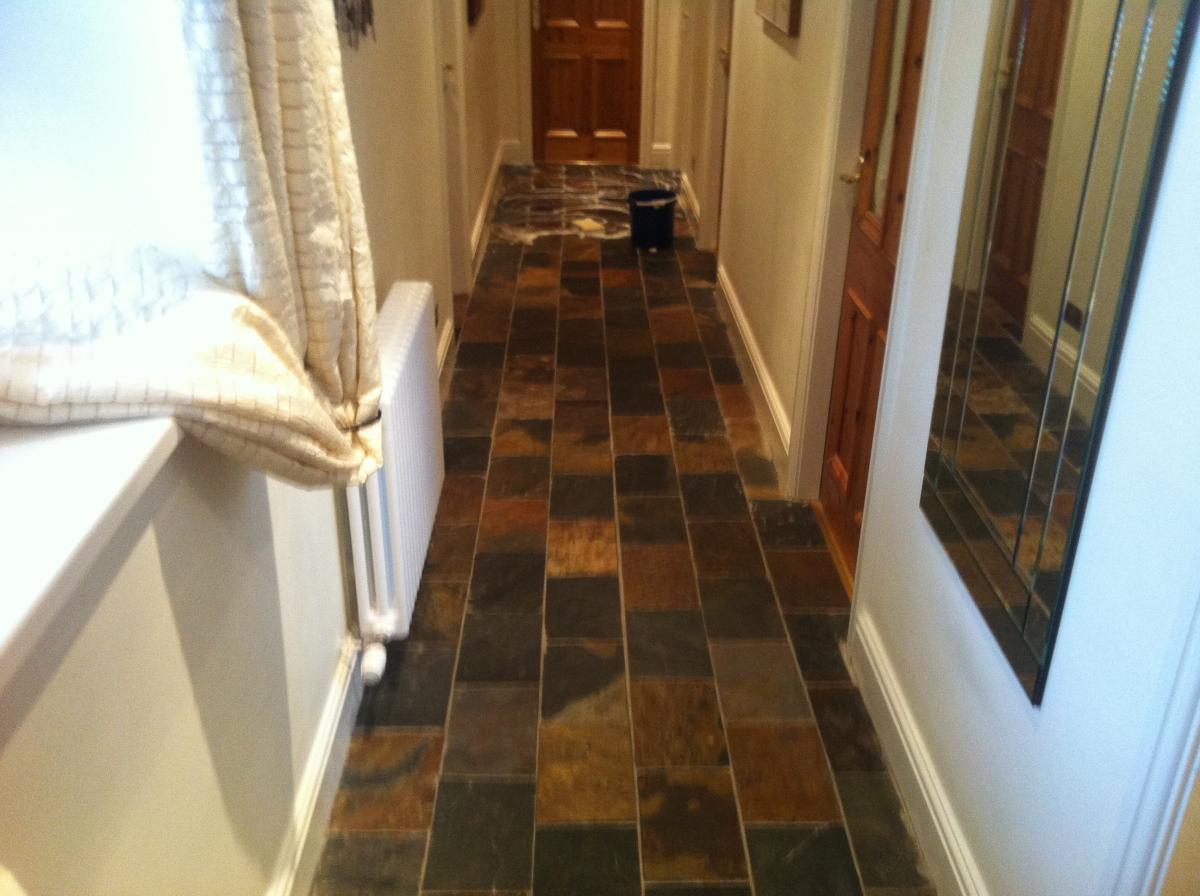

The next floor was Multi coloured slate and it wasn't as dirty but required a good clean and to remove old acrylic emulsion sealer... so this was cleaned today as well.. and will be re-sealed on friday with gloss&seal satin finish..

And these are some of the slate but we only cleaned it today.. so better pics when sealed..

Photo's look good Dave, the Travertine Floor has come up brand new...:thumbsup:

How do you apply the extreme clean Dave? does it need scrubbing in, then hoover off?
It does look good, A 50/50 shot would have been good though.
I must try the colour seal, as it's something I'm asked about from time to time.

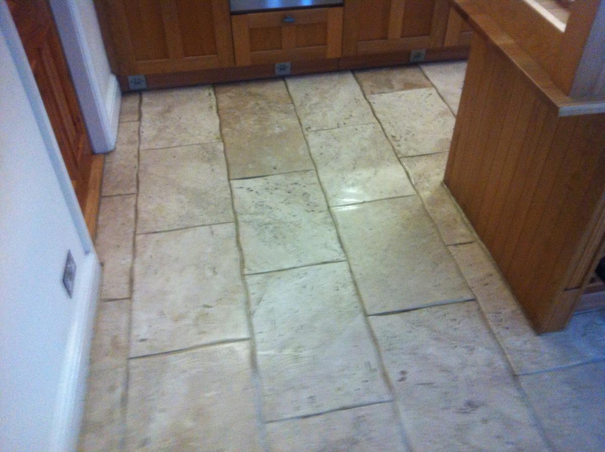

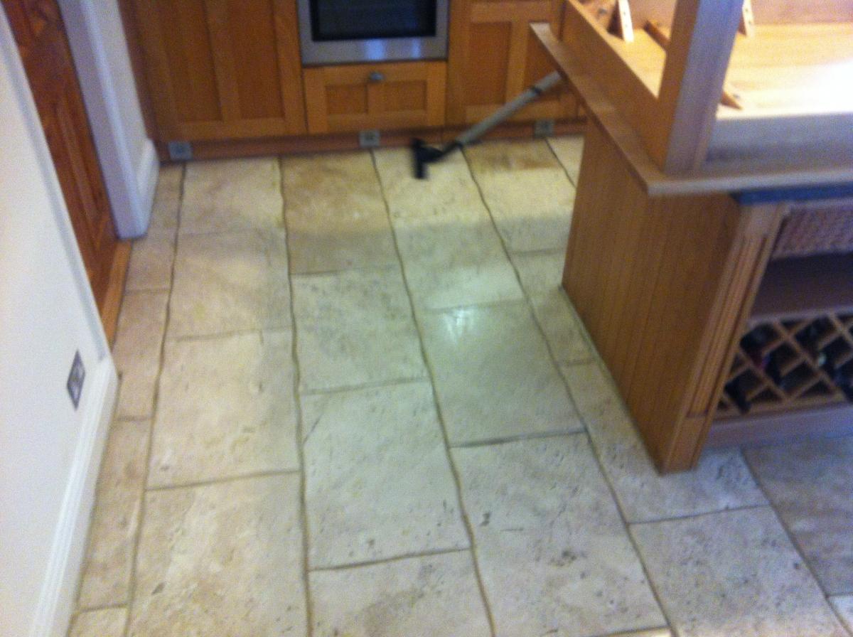

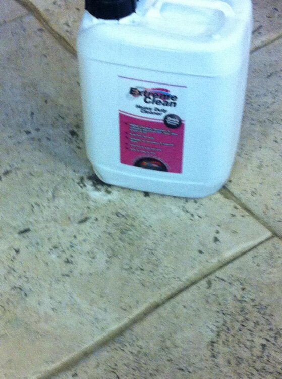

we applied with a sponge at around a 3-1 ratio.. it was dirty lol ... left to dwell for around 15 to 20 mins then agitated with a bristle hand scrubber , then wet vac'd up to see result ... then applied another wetting of extreme to make sure we got deep into the pitting.. the second wetting worked a treat for the stubborn bits... wet vac'd up and then a wetting with clean water to neutralise..
pic 4 is a 50/50 clean and dirty shot from first wash ..
