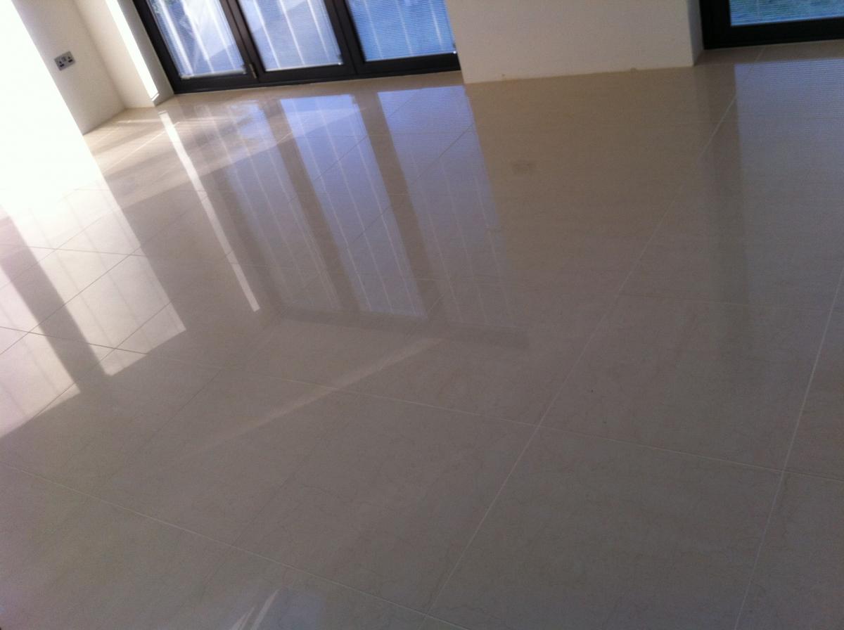

Question, we picked new cream rectangle tiles as heart isn't in the black ones anymore. Would grey grout be ok with them do you think? Our living room has cream tiles with ivory grout and they are a nightmare to keep clean. The grey grout we have on the dreaded black ones just now is very light anyway, so we thought its not as light as ivory but not dark either. Any opinions?
I have fitted cream polished porcelain lately and grouted with ardex vanilla and it looks good too, very easy kept clean by the looks too as I have used it on bigger jobs too with plenty of dirt in areas already tiled.Mapei's silver grey is a lively light colour too and looks great.It's personal taste really.Nice to hear you have all sorted now too, well done.
With cream tiles I always prefer a cream grout but it is really down to individual preference. I used Ardex Classic Vanilla on this job.
A decent flexible grout will be dirt and moisture resistant so easy to keep clean, IMO.
