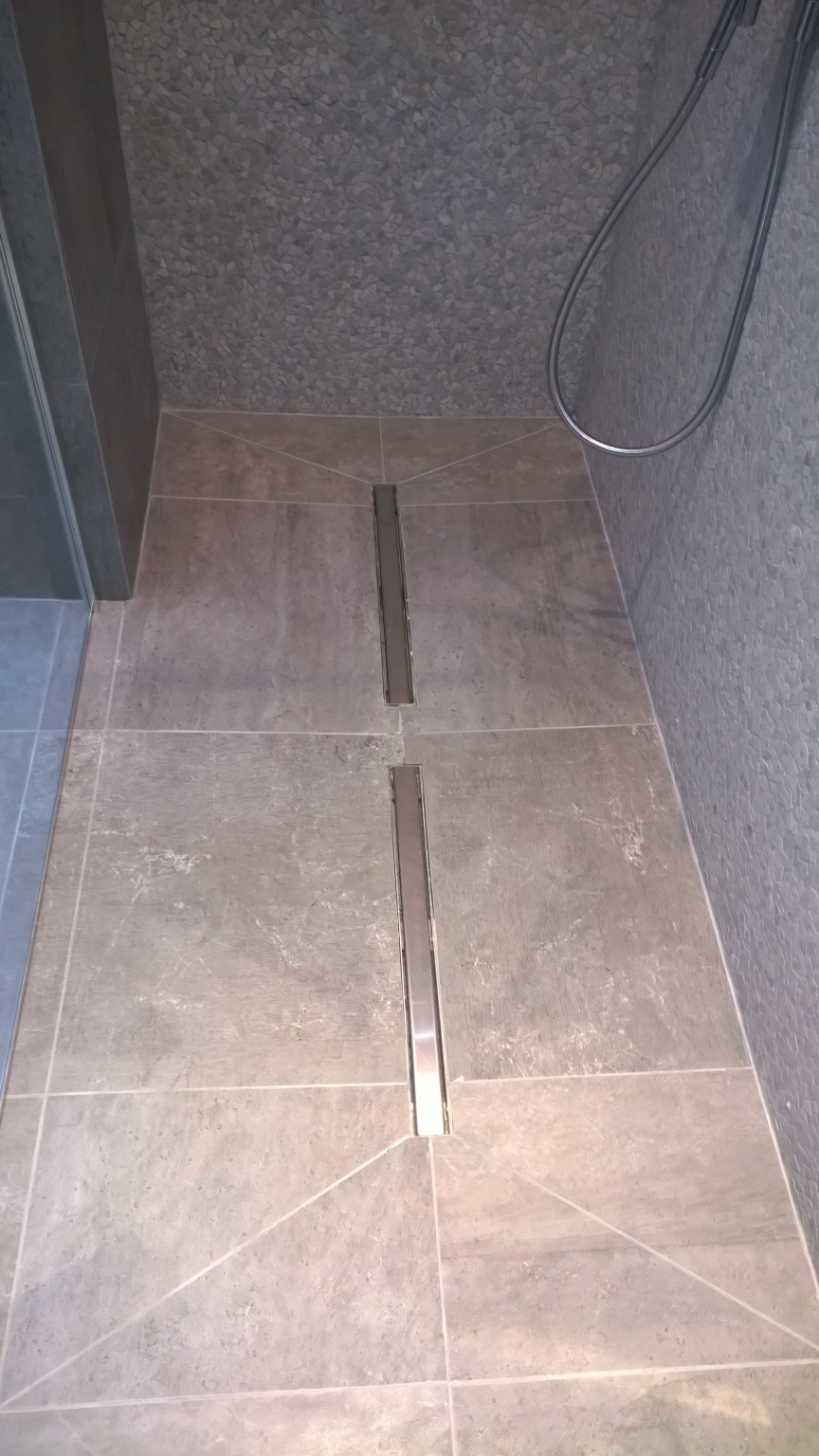

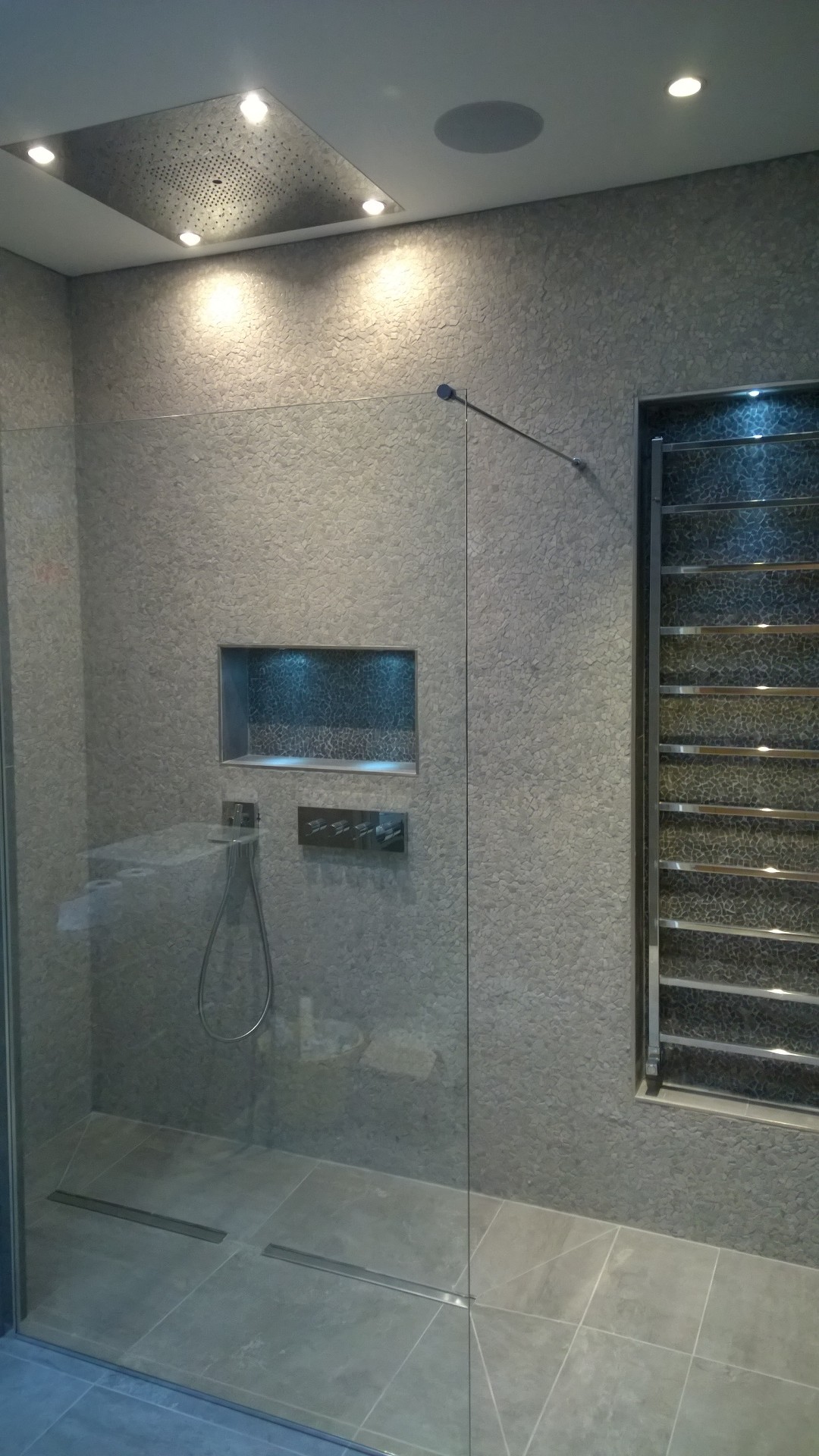

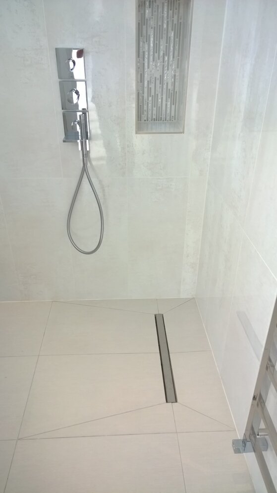

I can screed a wet room floor as quick as you can fit pre-formed tray - is that in your equation?
J Sid
I love hand screeded wet rooms. Do share photos of your work as we all like seeing quality handmade work.
These are hand screened
