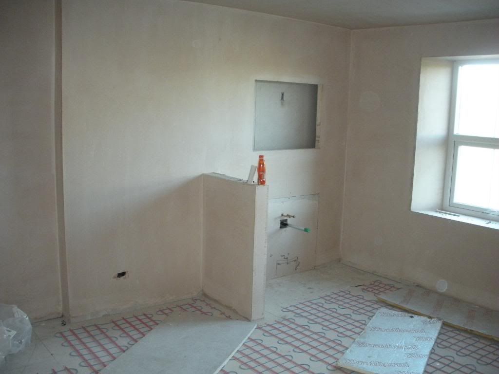

on of the largest bathrooms ive tackled, after a fire at the farm it had to be totally refurbed, unfortunately some one lost their lives in the fire. when the customers bought their bathroom tiles etc they asked the place for the name of a tiler who the they recommend, also the company in charge of the full resto project, and they also asked the joiner who done kitchen etc aswell. all 3 companies are based about 30 miles apart. Yes they all gave the one same number , MINE. so i undertook the work. bathroom was very large just short of 70m2 and the kitchen behind the propper aga cooker needed tiled aswell, just a mere 7m2.

Concealed Wall Cabinet:

First Visit:
i dont really want to say where it was, all i can say is the lady was smoking in bed, fell asleep and tragically never had the chance to wake up.
