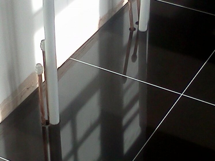

Bought the plumbing set a few weeks ago worked great on limestone, little tip start the drill before locating in the guide it won't wander. the 16mm bit is a bit on the tight side for 15mm copper would suggest buy 18mm as I found it was difficult to stop the bit going slightly out of square with the tile surface
Cheers. Yes if anyone wants to add the 18mm drill to their portfolio then we have them in stock!
As Andyman says it does give a bit more clearance on the 15mm pipes
so you dont have to be so accurate.
This is a 15mm copper fitted through a 16mm hole.
Grey plastic pipe also fits the hole.
White Polyplumb quickfit plastic pipes fit too.
But the hole has to be spot on or otherwise it will be a tight fit.

After reading a few posts recently (one of which included a letter from a 365 user who had whinged about the life of the core drills, despite him way over exceeding the expected average life of a kit).......... I would just like to have my say.
I have just about (but not quite fully!) killed my 30mm bit ........yet I am absolutely ecstatic!!! :hurray:
The reason why?????......... well, I managed to use it for 3 ceramic tiling jobs which needed 4 cores drilling per room, plus a porcelain wetroom job which required 8 cores drilling :yikes:
That is a whopping 20 cores, with nearly half being in ultra hard porcelain.
My hat off to 365 drills.......will need a new set very soon :thumbsup:
Cheers Geoff and great looking holes too !

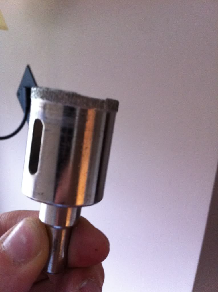

I bought the bathroom fitters pack last week. The 30mm drill chipped off where it slots at the cutting end. Resulting in chipping my ceramic tiles I drilled.
It drills ok if used very slowly, you have to be VERY slow at the end or it chips the tile when it breaks through
kinda disappointed really.. must have just had a bad one
Not a user error as I studied the video guides online before drilling.
Also would be better if an 18mm was supplied over the 16mm... no need for such pinpoint accuracy
Just my views, delivery was super quick though
Sounds like you had a bad one. Note to customers in this situation - always contact us and we will replace.
If you contact us direct we can arrange to replace the 30mm

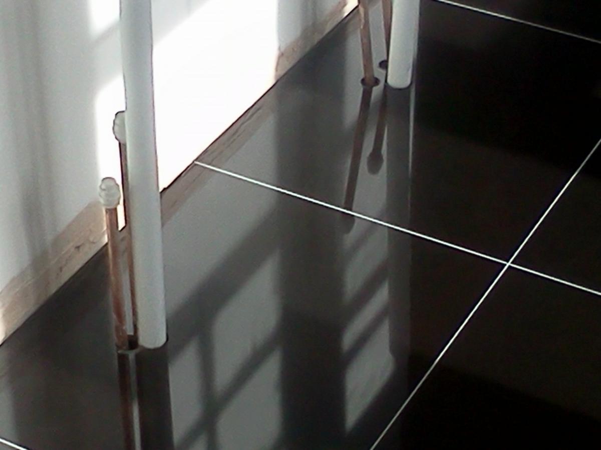

I agree about the 18mm and it was simply that we didnt have enough room on the drill plate to squeeze it on.
Opinion is divided. A lot of people love the 16mm and like the close fit. They find the 18mm too gappy.
This is what a 16mm hole looks like with a 15mm pipe poking through.
This is a 16mm drilled into soft ceramic
Agreed it can look a bit tight and there's not much room for error.
We do have the 18mm pack available seperately for those who prefer this size.

Cant say fairer than that mate, a replacement would be grand, thank you. I will pm you my address.
Do you want the damaged one returned? here is a pic showing what happened
Wow, a shiny new 30mm drill AND an 18mm also arrived yesterday
THATS customer service for you!
BIG thumbs up to 365 drills! Thank you very much :8:
Thats OK. As mentioned yes if there is anything wrong with the cores then of course you are entitled to a replacement. Have a play with the 18mm and let us know
if you find it better than the 16mm for the 15mm pipes. The 18mm was a freebie by way of appology for not getting it right first time.
