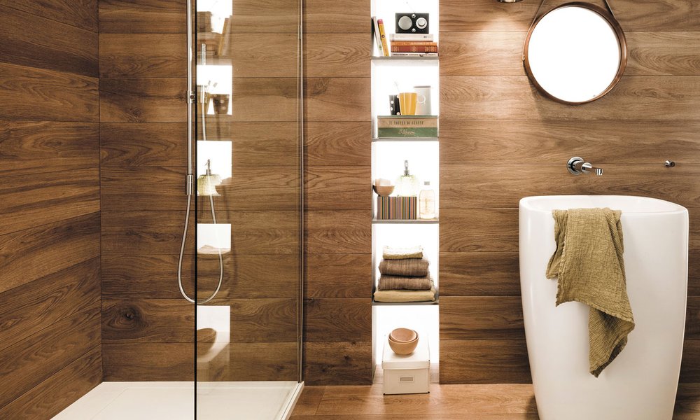

I took a bath, floor and wall tiles with 120x20, poses in horizontal line, (not staggered). but I can not find pictures.
someone ever done?

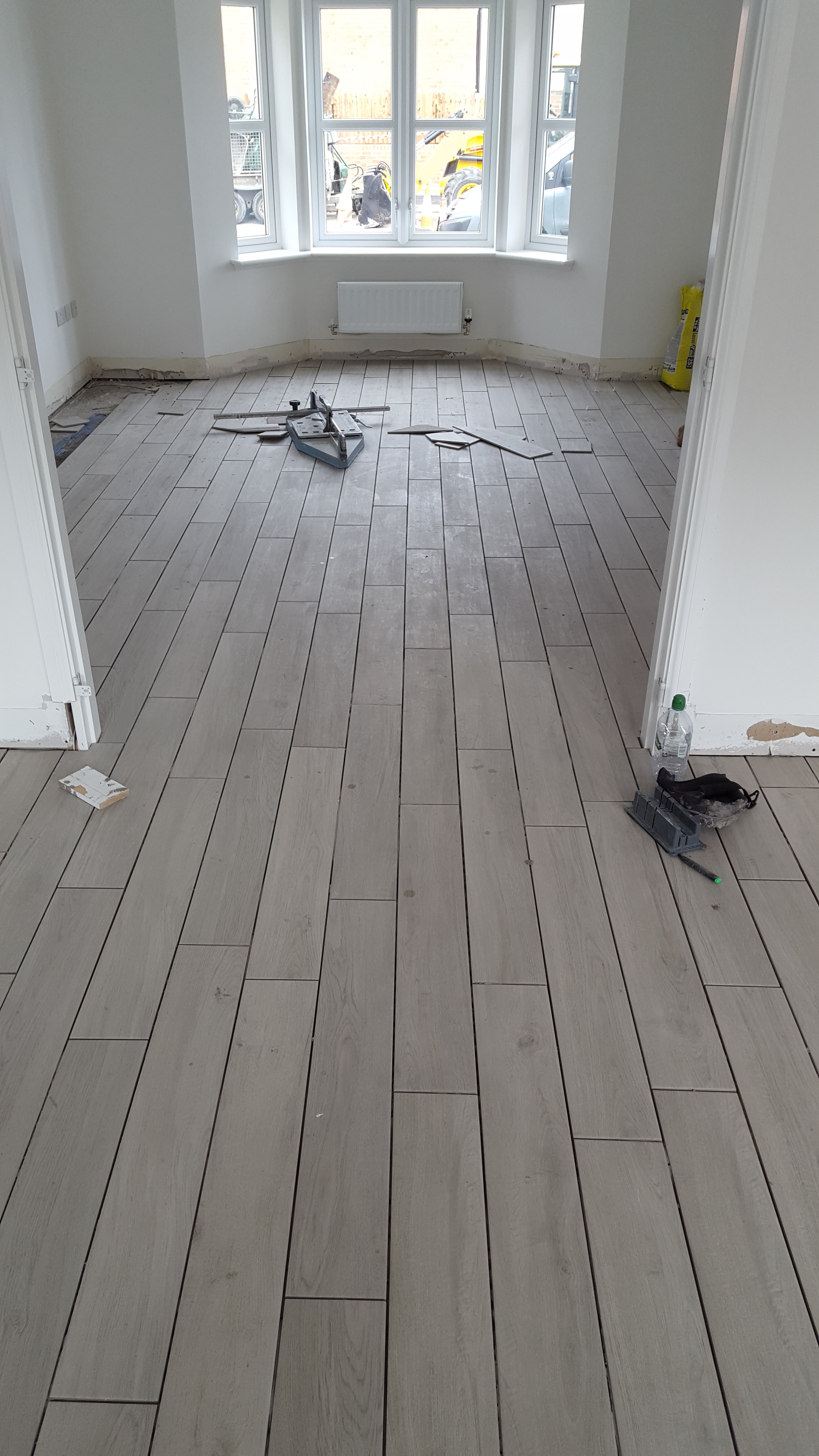

It was similar to this
Must admit I do like random plank jobs.

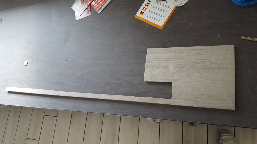

So quick to set out and light on kit - one of these
and grinder for the long cuts.
I got one of them little cutters, I find it a bit of a pain some times, the ruler isn't true!

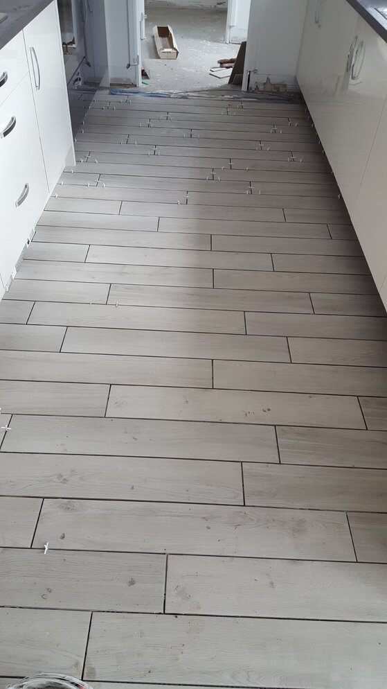

I, I think I did, wrong job.
Only just realised how many responses I've had to this question!! I did random in the end anyway! Looks much more natural than the boxes recommendation of 3rd of the way down the tile brick bond.
Cutting metros yes, but I can't imagine any of the porcelain planks I've ever fitted being cut by a mini monti!!!
Try it mate.
Promise you'll be pleasantly surprised.
Only planks I couldn't use it for were from Porcelanosa and that was only because they were too wide.
