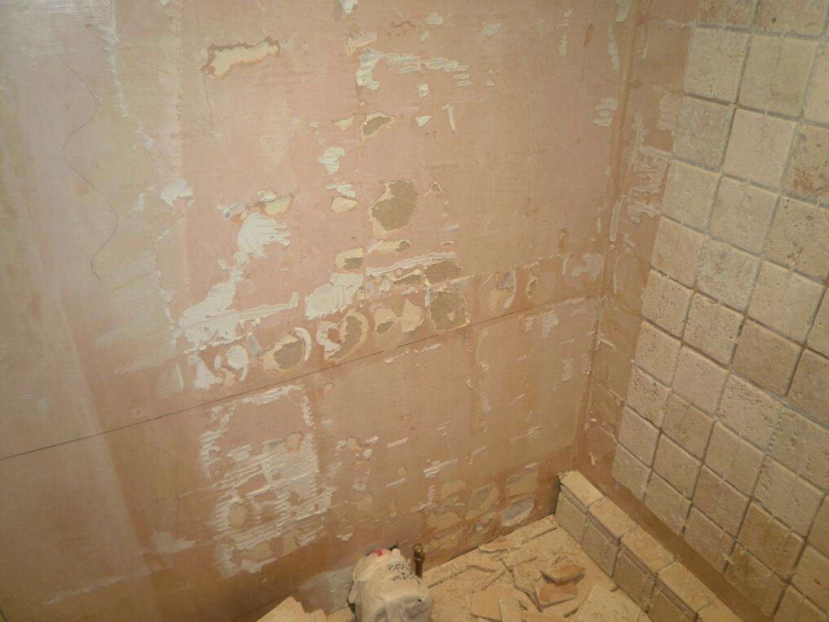

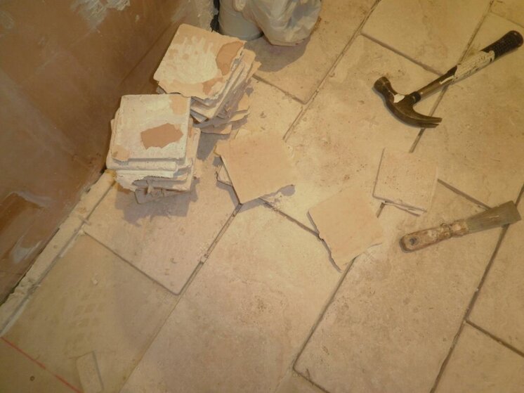

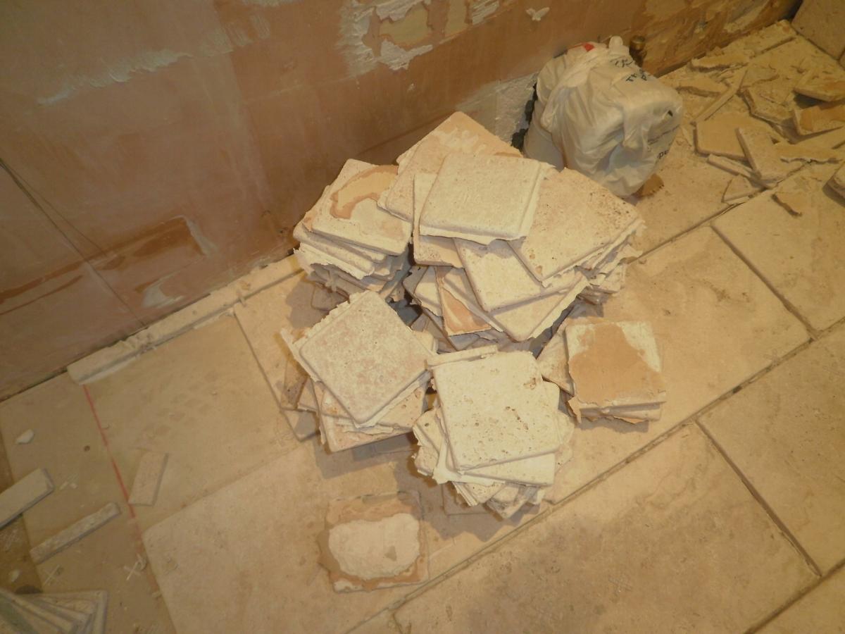

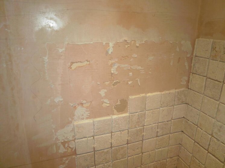

Yes, fairly easy so far, though I am starting with those that were put on last. Just easing a scraper down the tile and popping them off. A bit of plaster is coming off with some of them but not too bad. I'll take a picture later.
BTW, he did confirm that he had used PVA on the wall first.

The list of errors is growing, pva is wrong wrong wrong, there is a long thread on the subject, it would seem ( almost definitely ) that tubbed gear was used, wrong for the tiles, get them off the wall and cleaned asap.
This is what it looks like now.
