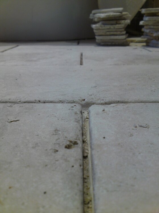

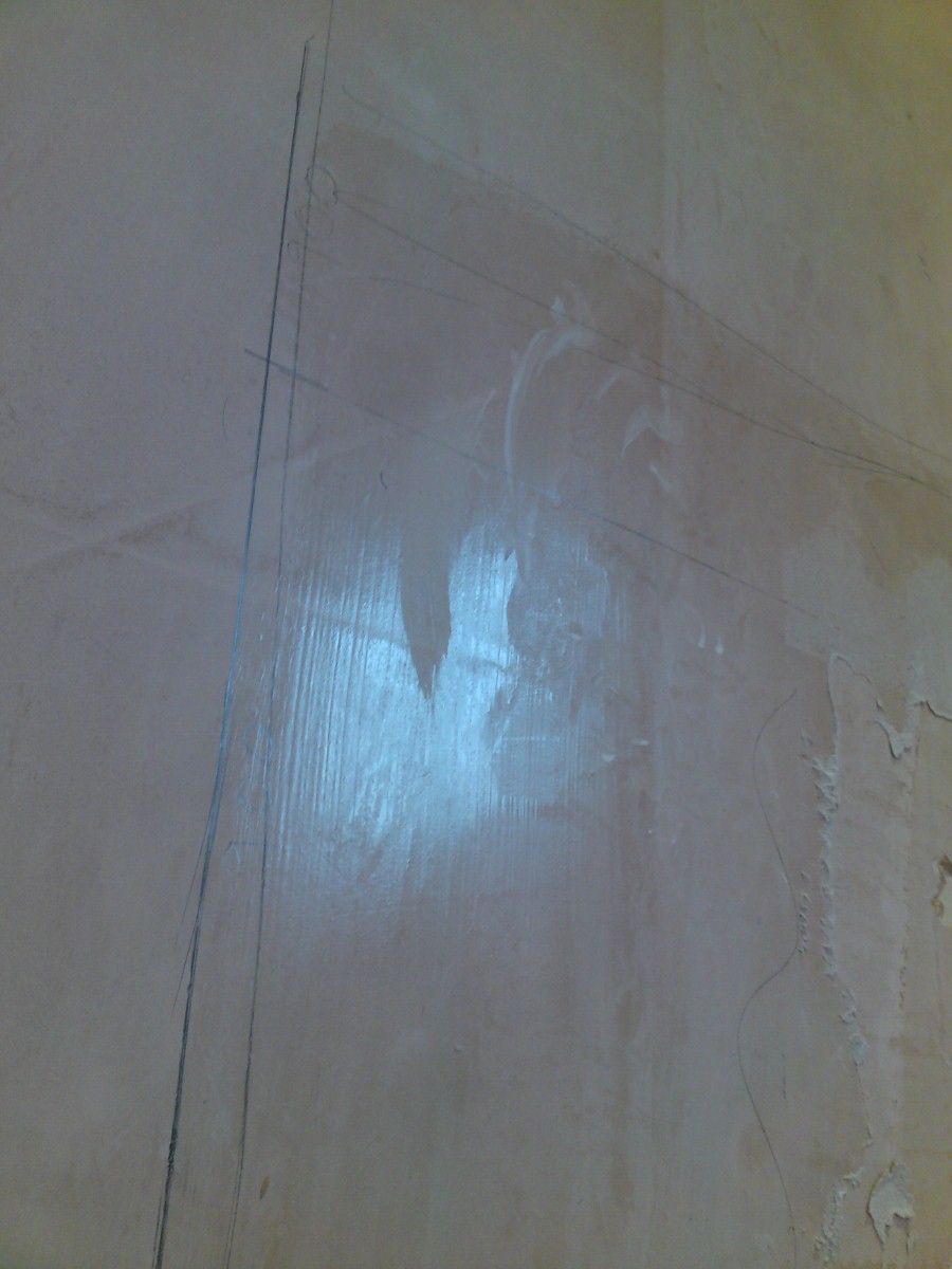

Here are some pics i took whilst it was there
You can see how storng a pick of PVA he used, it came off like sun burn. The others show the bit the KAte hadnt noticed and that was the alleged brickbond that was 1/4" out over 3 courses.
Such a shame really but at least you are on the job now and so so pleased it will get done right..
Thanks for sorting this out..🙂

As for PVA, the number of builders, bathroom fitters etc who assume PVA can be used without a problem never ceases to amaze me.
I will say one thing for PVA though - it makes getting the tiles off FAR easier. I stripped a bathroom out a couple of years ago to convert into a wet room. The tiles came of in SHEETS! The grout was holding them together. The bond on the grout was stronger to that holding the tiles to the wall.
When the walls were inspected, you could see the shiny surface all over them where the adhesive had not made contact - PVA!
