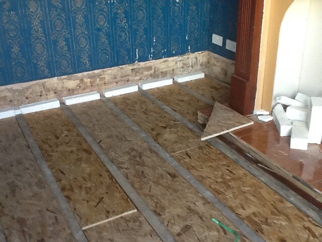

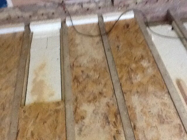

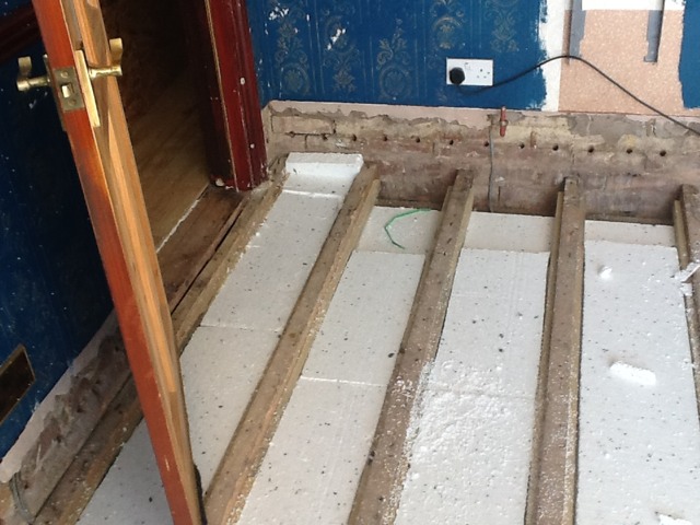

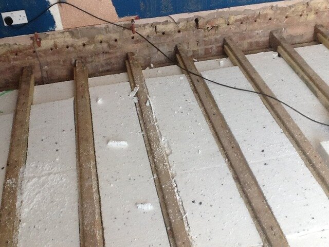

A Ajax123 TF Esteemed Arms Jun 30, 2012 #11 Joists battened reay for steeling board subfloor and final layer of insulation going in. Soon be ready for underfloor heating pipes and 30mm of screed

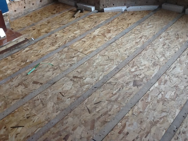

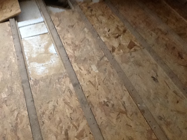

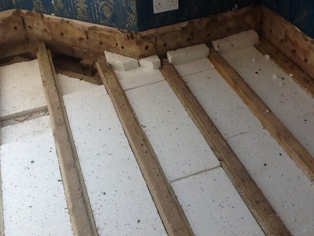

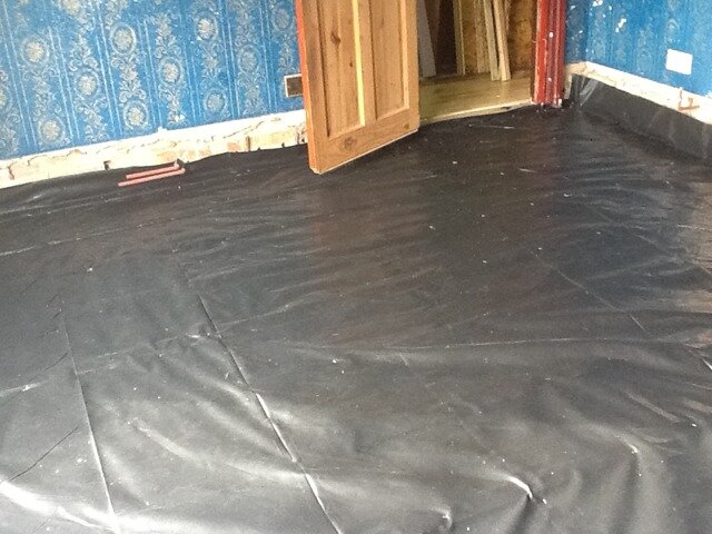

A Ajax123 TF Esteemed Arms Jul 6, 2012 #13 Phase four complete..... Next job to screw it all down then notch out joists for underfloor heating pipes....

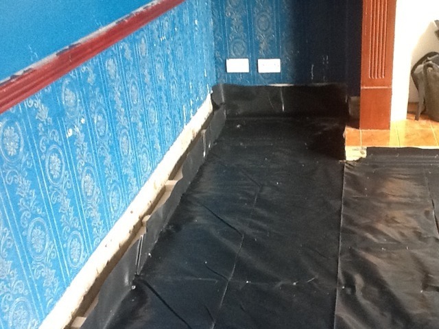

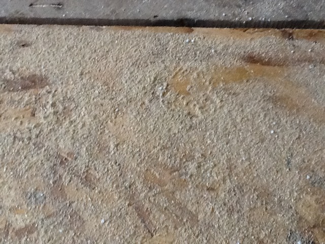

A Ajax123 TF Esteemed Arms Jul 7, 2012 #16 Yep. Problem with damp. Injection DPM was a mistake. Gonna put wood panelling on the bottom half of the wall to cover it all up.....

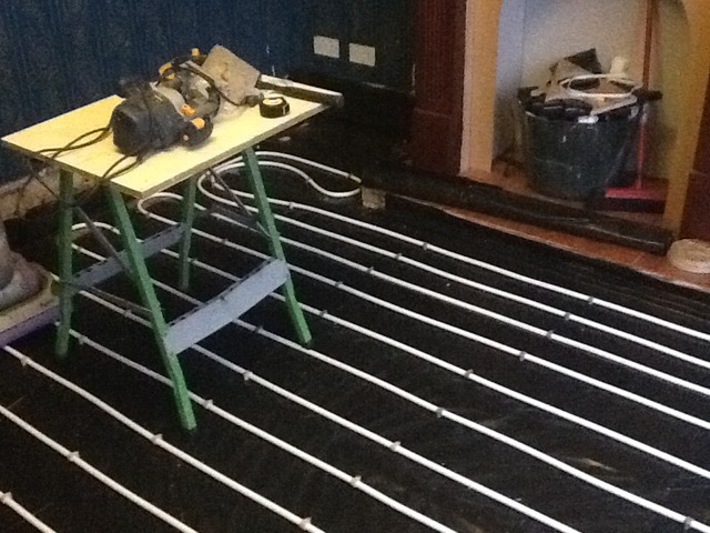

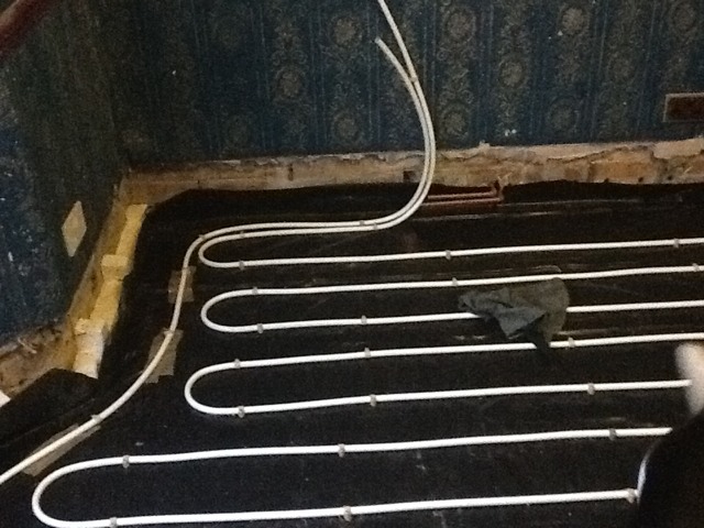

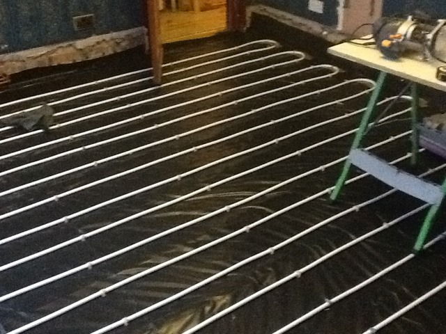

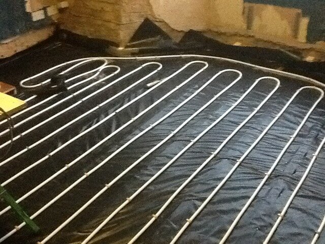

A Ajax123 TF Esteemed Arms Jul 9, 2012 #17 And then there were pipes..... . And some left overs Ooh and a dog.. . I think hes saying "tout younsaid it would be warm daddy"
N nybor62 TF Jul 9, 2012 #20 Dave said: Bloody hell Alan, look at the size of that Rat.. :lol: Click to expand... must have read my mind stole my thunder lol, nice 1
