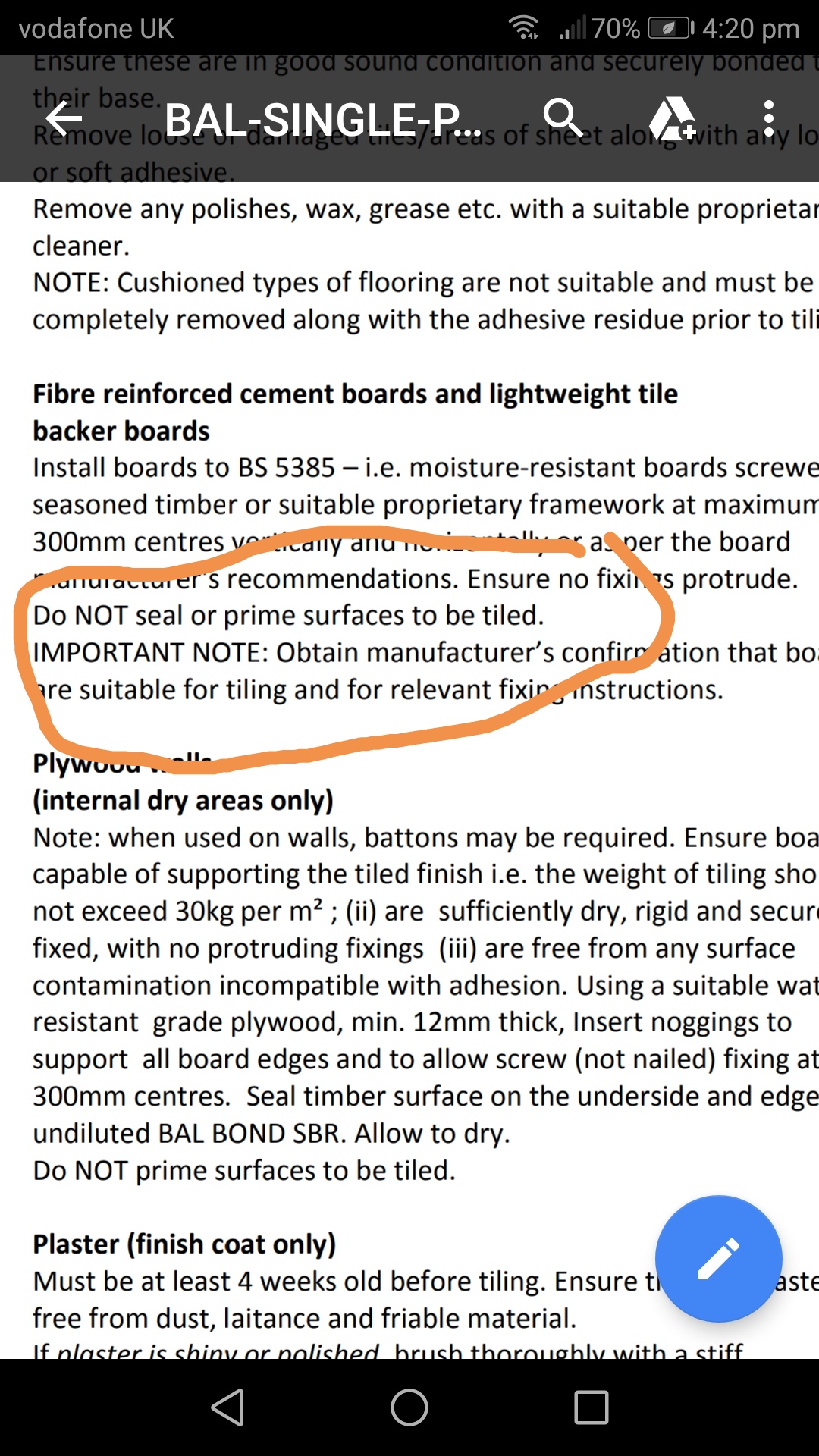

This is taken from there pdf, the adhesive is bal single part fast flex, an adhesive I use all the time on wooden substrates with cement boards...
Right if you look at next paragraph down that is what I challenged them on. Saying do not prime surfaces to be tiled on . I challenged them and they ok not a problem . So I wouldn't rely on that . I've not finished bal tech will get a call from Mr pain in the arse from salisbury
I know first hand priming certain surfaces using that adhesive reduces the bond strength considerably.
So just had a chat with bal tech and they say no need to from their point of view but you could to slow the porosity of the board but you should check with the manufacturer . The guy was very non committal and ambiguous but at no point did he say do not do it . I also asked if it would be detrimental to the bond strength and he said no . I dont know if bal board is a lightweight board , i know it not cementitous but they recomend priming with apd
