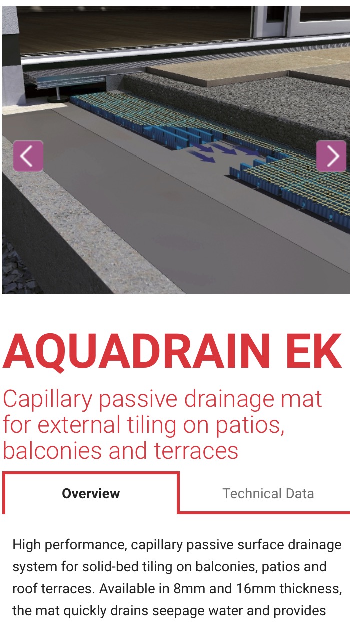

Thanks callatiler for forwarding on the aquadrain demo video ,, but the balcony in question already has excellent waterproofing and drainage .. I'm mainly after the advice of best adhesives and grout that will withstand all weather extremes as the balcony really is open to all elements.. thanks anyway
