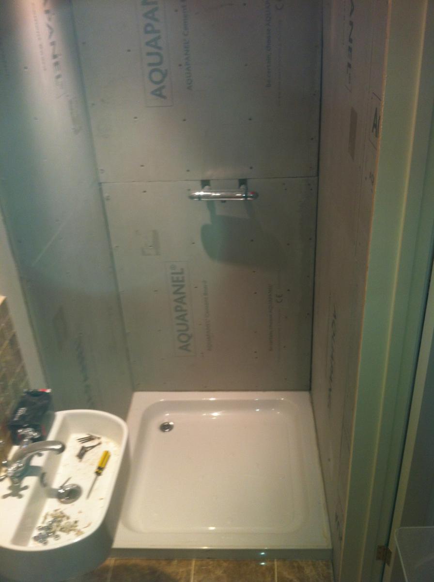

Well I've made a start yesterday. ripped out all the ply, and then the tray wobbled..... blasted plumbers as well as the tiler now... I was cursing....... So I knew exactly what this would entail.... yep down to the kitchen, cut a nice hole in the ceiling to find the waste trap and disconnect it, then lift the tray out (dry set on chipboard.... and rocking like a good'un.. nice one), Then clean all the old Silicon off everything, board the shower walls, and then bed the tray down properly. So now I have basically re-fitted the lot, including repairing the new hole in the kitchen ceiling. Tiling it today
Here's a couple of photos after boarding:
View attachment 56274View attachment 56275View attachment 56276
What have you done to tank the aquapanel boards & joints?
