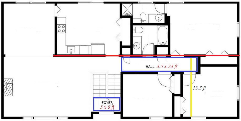

I would like to install slate tile on the hallway and foyer (blue rectangles) of my house. However, I don't think the framing in the hallway meets the L/720 deflection necessary for natural stone. So I was hoping I could get some advice and opinion on fixes and feasibility of such a project.
The joists are douglas fir 2x8 16" on center with a length of 13.5 ft (yellow dimension). The supporting beam runs along the center wall (red line). With these specs, I get an L/221 deflection. Unfortunately, I have a finished basement, so sistering the joists is not feasible. I want to match the height of the hardwood installed in my living room, which gives my 3/8" on top of the existing 3/4" plywood that is already there (the stone tile has a thickness of 3/8"); 1/8" or even a 1/4" above the hardwood would be ok, but undesirable.
Given that the hallway is adjacent to the support beam, I expect the deflection would be minimal. This is not considered typically considered by deflection calculators. Would this help at all? Does it make a difference?
I've also read about products like blanke permat that may mitigate deflection, but it seems this only minimizes the deflection of the subfloor, not the joists themselves, correct?
