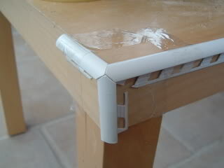

Discuss Struggling with 3-way mitre trim in the Canada Tile Advice area at TilersForums.com.
Avoid 3 way mitres and corner pieces, just use L shaped trim.
The trim must be a perfect quadrant i.e. quarter circle. If not you will never get a perfect 3 way mitre.
So what shop (not online, as i need to get done tomorrow) could i buy new cream trim 9mm and a L shaped corner piece? If i need to match them i will just buy new trim.
I prefare the L shaped trim Bri, even though you need to be a precision engineer to get them spot on. Luckily I'm perfect.:lol::lol::lol:
