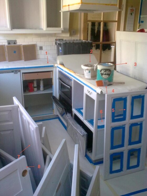

Stack them in a criss cross fashion if the sealer stays wet for a long while, ok this picture isn't a very good example, it's similar to what we do but you get the idea. It surprising how many you can stack like this and you have minimal point of contact.
