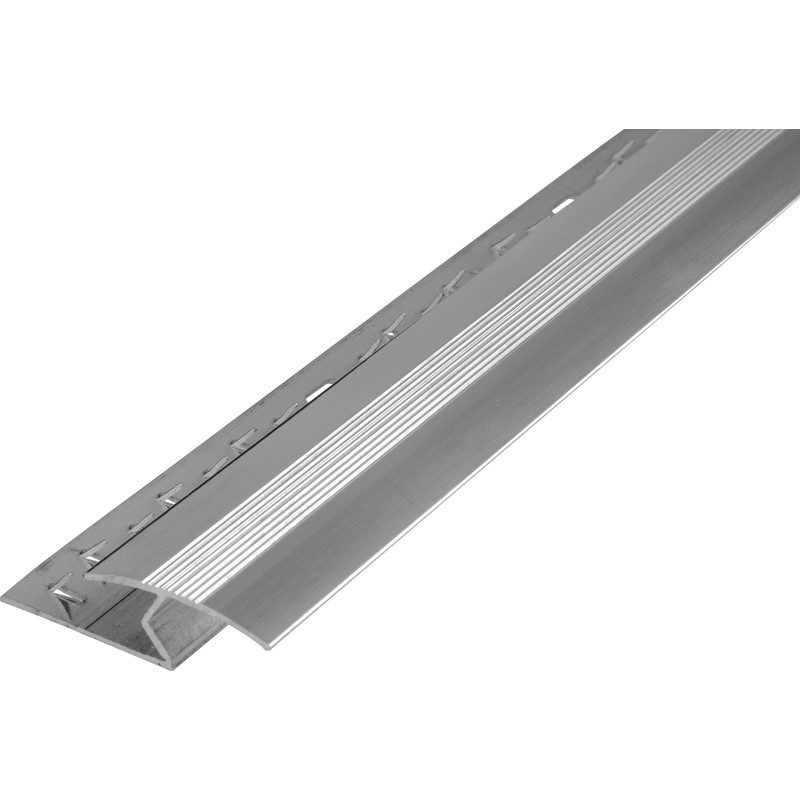

4. Where the dining room meets the living room I plan to tile up to the separating wall on the living room side. At some point, I will put down a wooden floor in the living room.
Question: I will need to insert a metal or wooden strip between tile and wooden floor - what is the best way to leave the tiles now to make this easy to do in future without having to take a row of tiles up - usually the strip inserts under the tile. At this point, I don't know what depth the wooden flooring will be.
