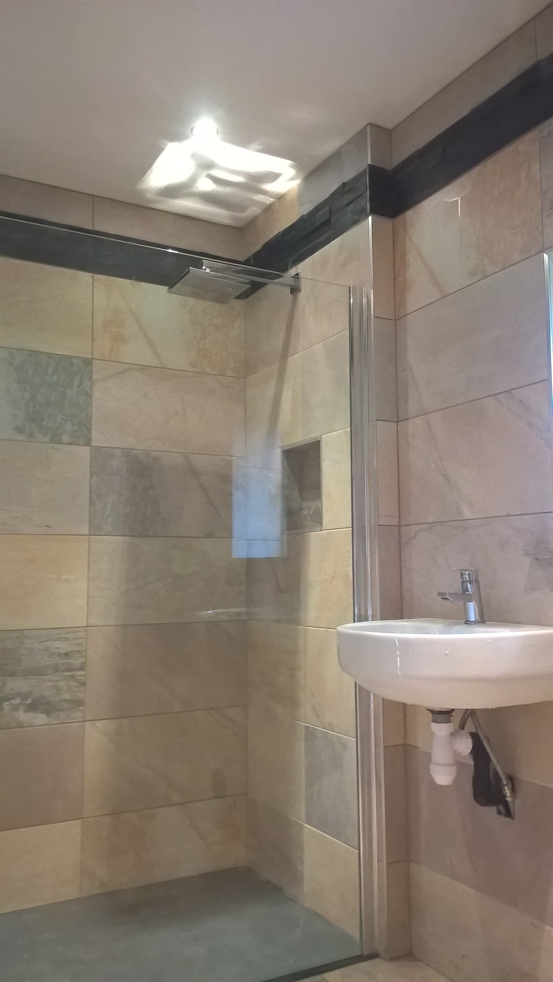

Had this issue a couple of months ago, customer wanted a strip of split faced slate down the centre of a shower cubicle, talked her out of it and fixed a high level border around the room instead, well out of the way of imminent water damage 😉
