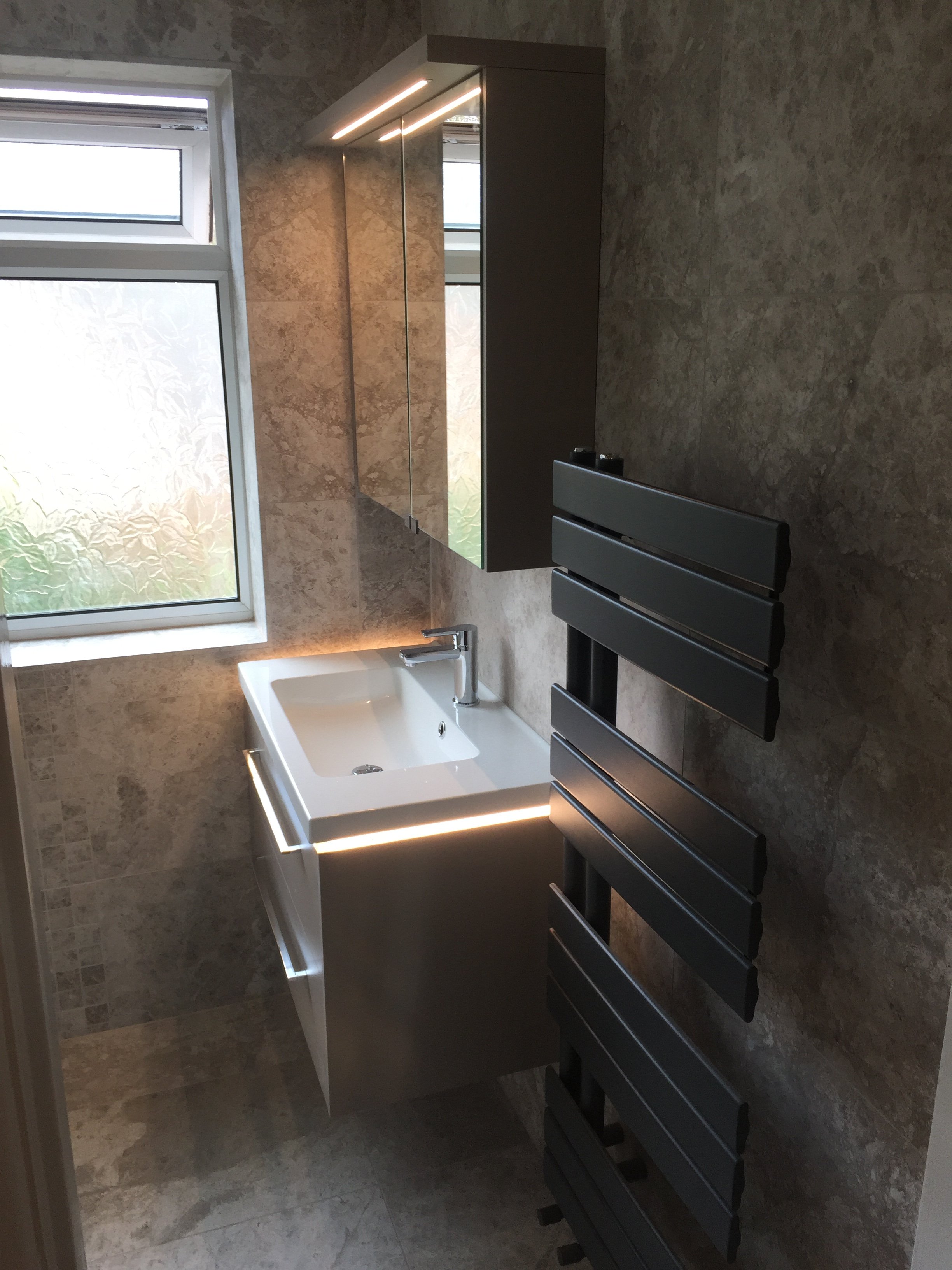

Oh and your 'Small marble shower room' is stunning - (how far away are you from Lincolnshire??!!!)!!!
