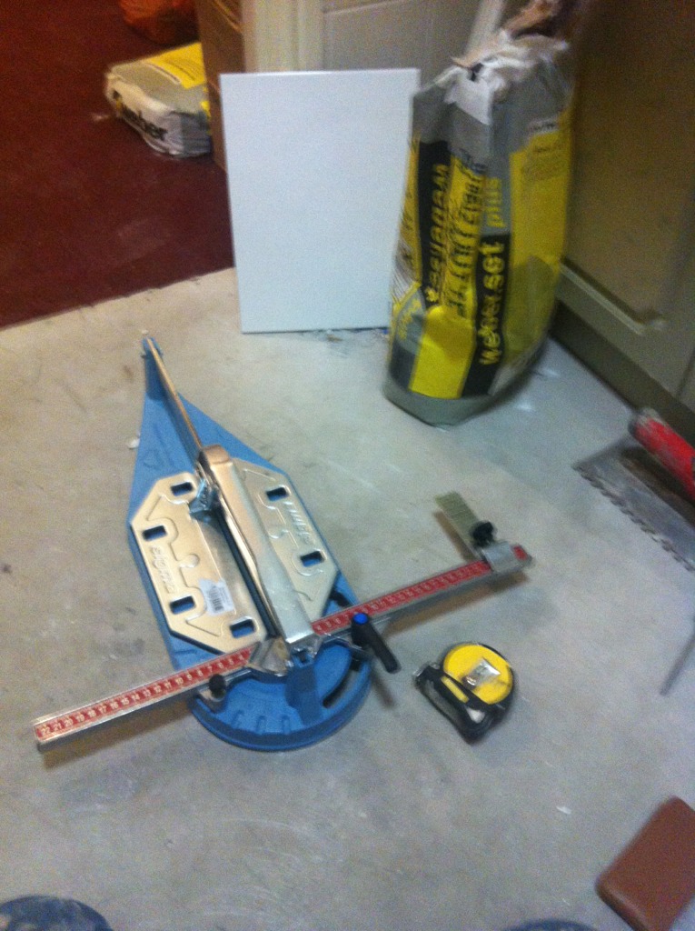

The pull is canny , it isnt awkward , just different from what i am used to but not uncomfortable or Anything.
I like it.
humble pie for tea tonight ?....:lol:
Neale I'd recommend PTFE spray instead of any polishes or such. You'll find it in most tool shops in little spray cans, I like the trend one, it's mainly for prolonging the life of blades/router bits etc etc but I use it on all my sliding tools such as mitre saws and also tile cutters, no build up and no grease
