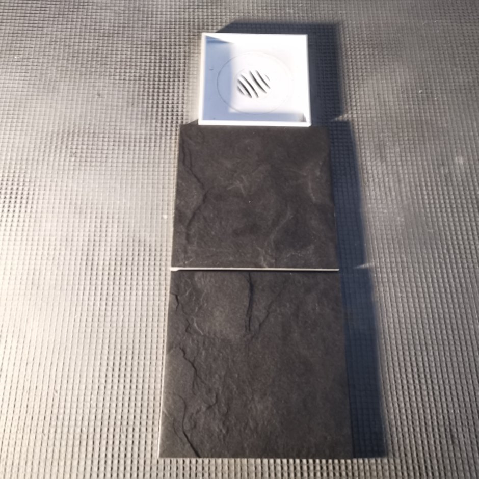

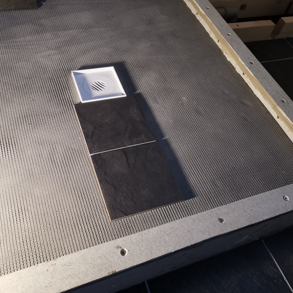

Been out looking at tiles again today to replace the original mosiacs.
Have found a square porcelain tile that's 160mm by 160mm. See below:
Would I need to envelope cut this rule to follow the fall of the tray or as it is 160mm would it be small enough to still follow the fall?
If I need to envelope cut them then could I rotate them and fit them as a diamond pattern where then it would follow the fall to two corners and be close to the other two corners of the shower (tray is 1200 by 900). I've probably not explained that very well but see below :
If you imagine I have cut the tile where the drain would be then maybe this would be an option to avoid envelope cuts.
Thanks in advance,
Daz
