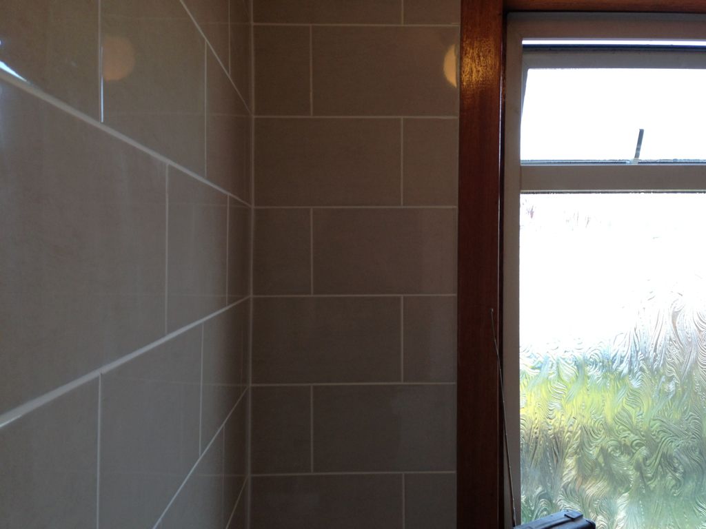

Bathroom I did last week. Suite out & same one back in. Wall tiling only.

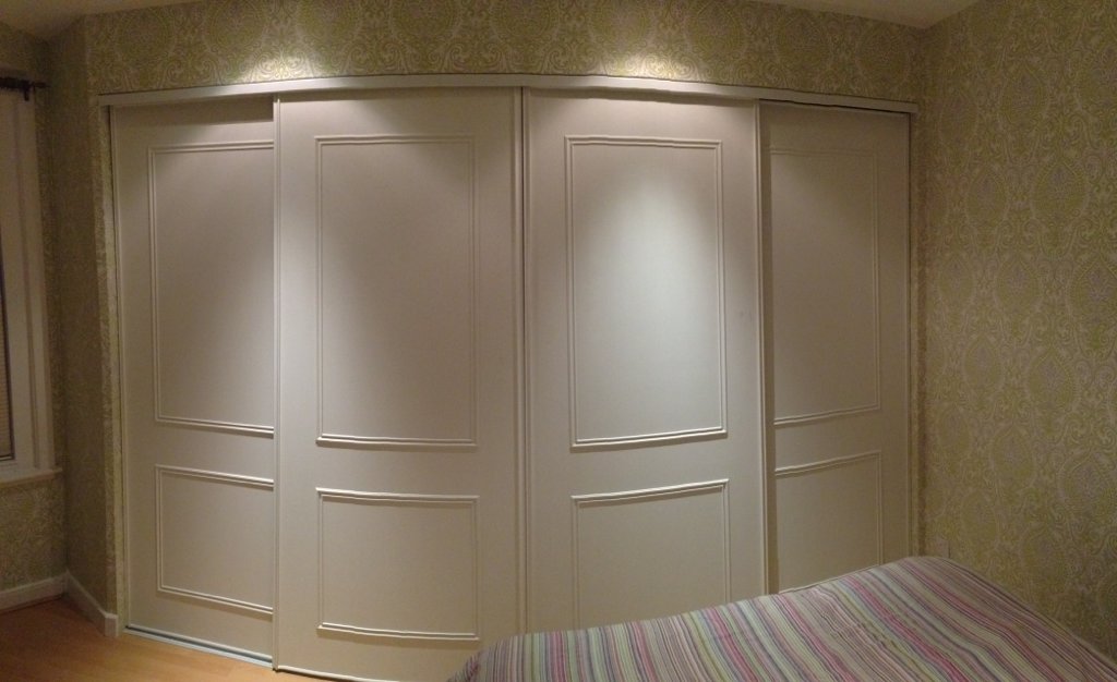

Heres fitted wardrobes I finished today
Done the new ceiling, lighting & decorating about 2 months ago. Got me back to do the fitted wardrobes
