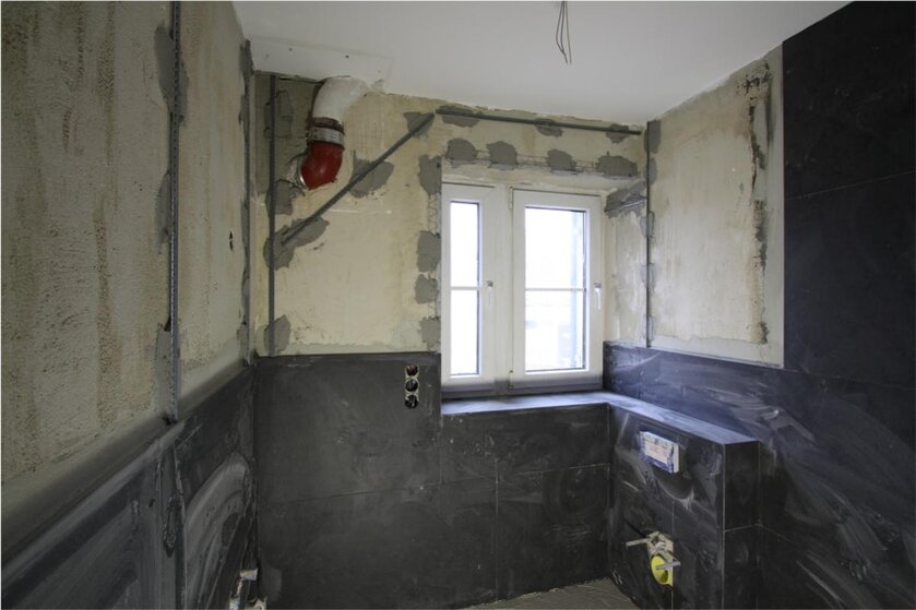

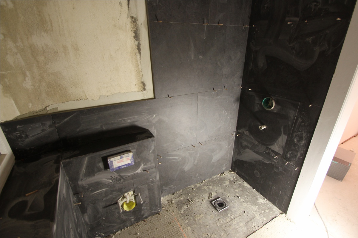

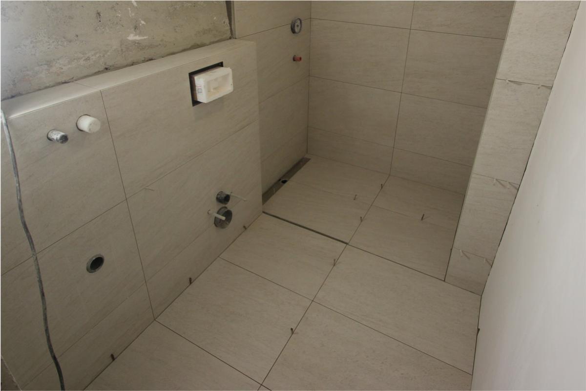

renovation of a munich apartment in the 5. level. i used a 6,5cm wedi fundo plano and schlüter becotec with standard screed. tileformat 120x60
because of the small place to work i just use my dry cutter and a grinder. i drilled the holes wet on the small balkony. rendered the walls flat to the tiles. i like rendering.
120black00.jpg120black01.jpg120black02.jpg120black03.jpg120black04.jpg120black05.jpg120black06.jpg120black07.jpg
project i have done today. the new TECE pusher for the toilet is not easy to cut out. i like the position of the window in the tiling gate.

there is a plug socket on the left wall you don´t see at the pictures. the two holes can be for the mirror light and maby a radio. but i don´t know.

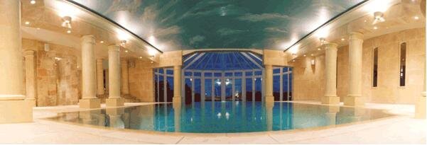

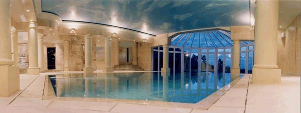

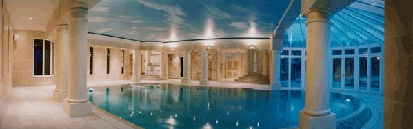

ok i will kick off this new thread following on from old one with a job about ten years ago or more now.
it was a dream tiling job in a way, as my employer was a very successfull engineer and entrepreneur.
the job was started by david platt (footballer) when he had set up a building company but they went under on the job and my client took over the whole project himself as he was then semi retired .He looked after all the subcontractors in place .
he set out to do a basement pool utilising the new and genuine old reclaimed stone from france supplied by paris ceramics ,kings road london.
I was recommended by paris ceramics so i did a measure for all materials and we ordered everything we needed for copings,stone grilles oversized and to be cut and finished on site.
sorry i posted the first part because i was worried about losing content.
the stone that we used for copings/grilles and field stone behind was french burgundy.
copings were 30mm thick. grilles sections 50mm thick and field tiles 600 x 600 x 20mm
there were genuine antique bourgogne mosaics set in 1.00 sq mts panels in diamond shape around walkway not shown but same mosaic used on waterfall end . we set pebbles at bottom of waterfall before running in to drain.
the stone grilles we designed with the client and simply routed out four sections per piece.
the grille sections we wrapped in celaphane on a sand cement bed on a ledge . when this had gone off we could remove and stone sat snug and moulded to sub base .with 50mm thickness this was unlikely to break and has worked to this day.
