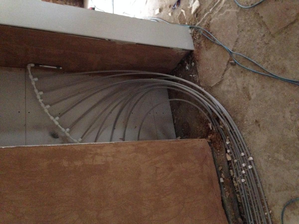

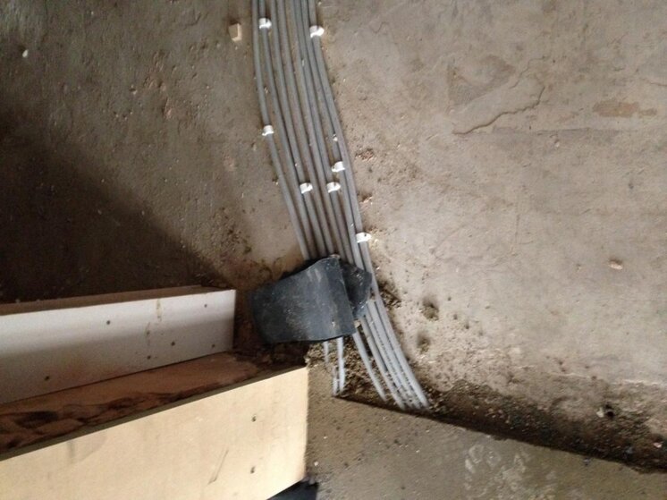

Good morning all. Went to look at a job yesterday where they are having the nu heat Lo Pro 10 UFH system on the ground floor of an area of 56m2.
I've put some pictures on which hopefully aren't upside down as the usually are.
My question relates to the screed. The pipes have been covered with 65mm sand and cement fibre screed, so the builder said. I know the drying times for screeds is around the 80-90 day mark but as usual the builder wants it done sooner. Also in relation to the commissioning of the UFH have any of you guys had experience with this system and what's the best way to deal with the commissioning of it. Also I know the answer but is there anyway of tiling sooner onto a set up like this. The tiles are limestone. I'll be using ditra as well.
