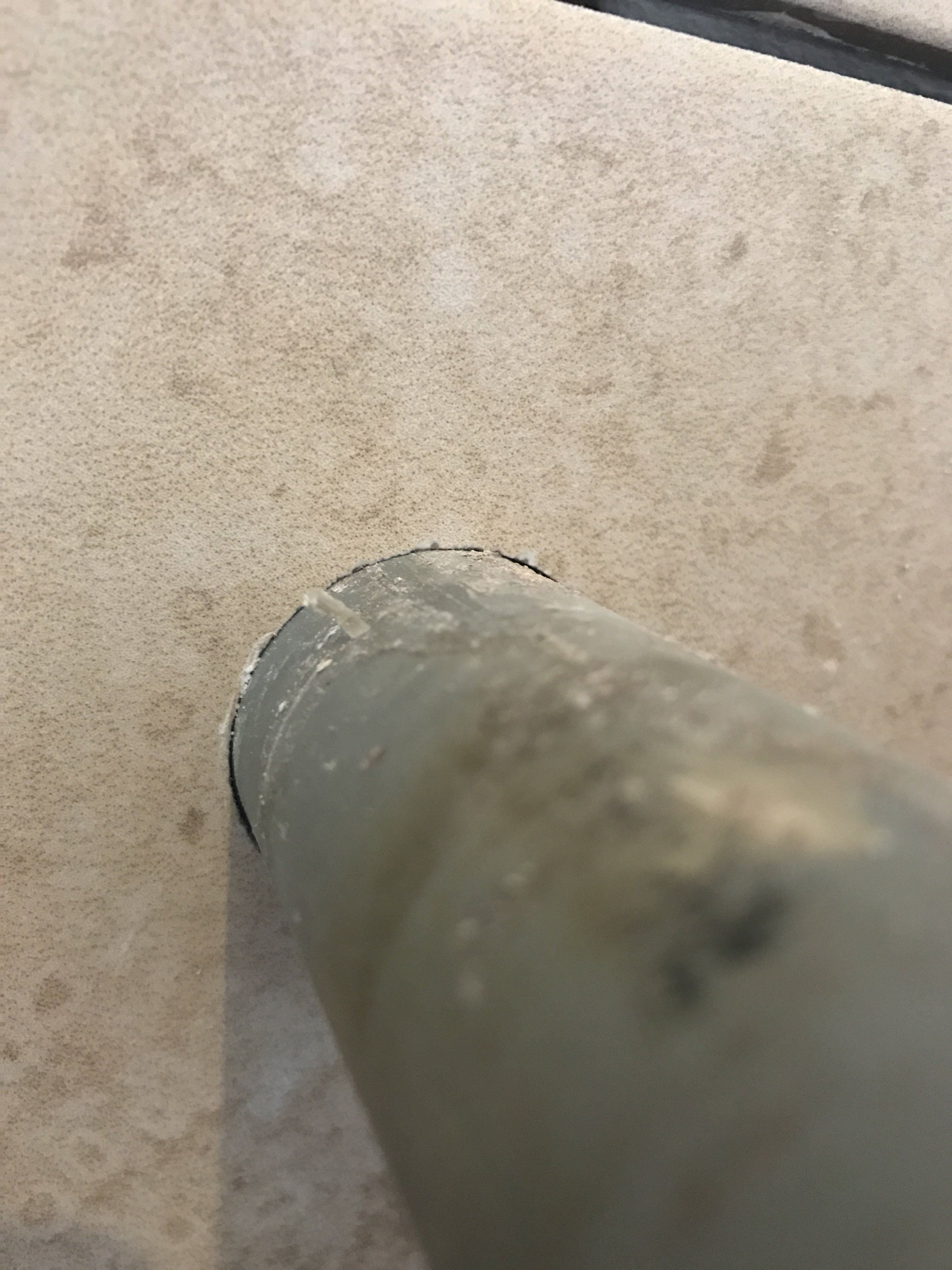

If that pipe rubs through because of expansion and contraction I'll re tile the place for free!
You can only see one side of the cut, other side is a right mess looks like a dogs chewed it
