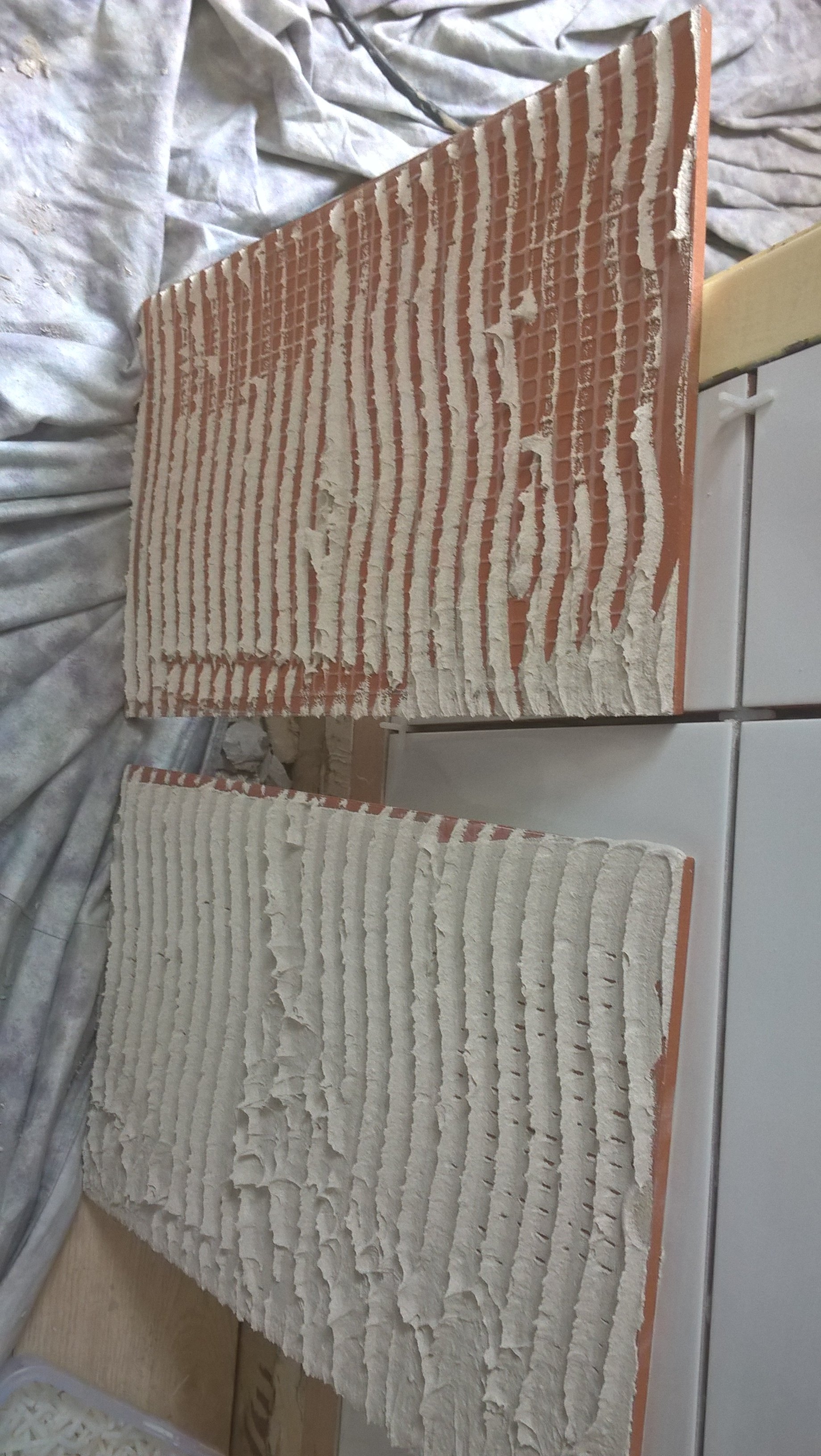

Was reading this thread at lunchtime,have always back skimmed every tile I fit, just do it automatically so thought id try a little experiment...pic is two same ceramic 250x400 wall tiles, one skimmed one not, same 8mm trowel, same pressure applied on fixing...whoever advised you not to butter tiles was a fool!!
Hi guys thanks for all comments and help and yes that shows very well that back buttering is a must thanks.
