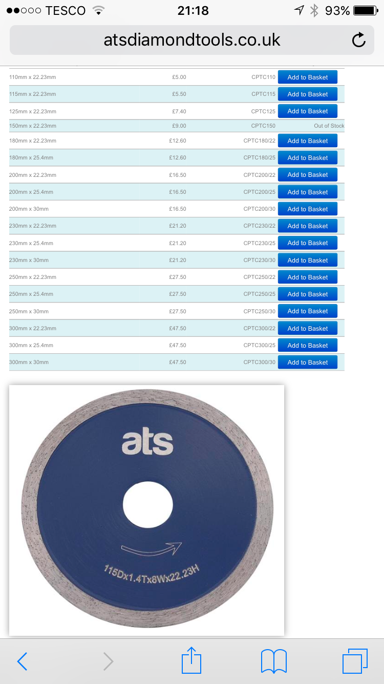

I've not used that one, it was the original pro-Gres that I had.
For the difference in performance & price I will stick to ATS blades as I'm more than happy with the cut.

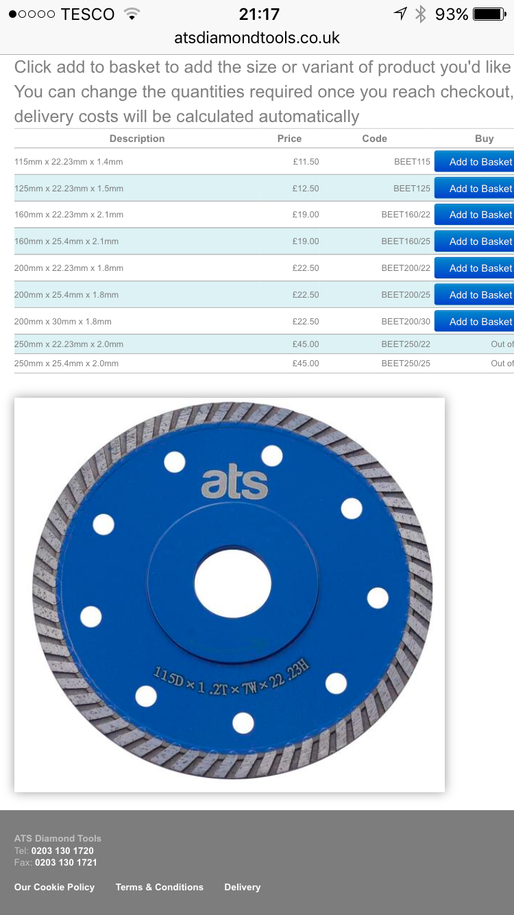

I understood that you used tcs that I put pictures.
I'm not selling anything.
we're just here to understand what is best for tilers.

Progress Evo a very very good cut, ATS blade also a very good cut, this is blade Craig gave me to try, sure he said he'd got 2 delivered for £15. 6 blades for 1..
Antonio you try ATS and compare?
