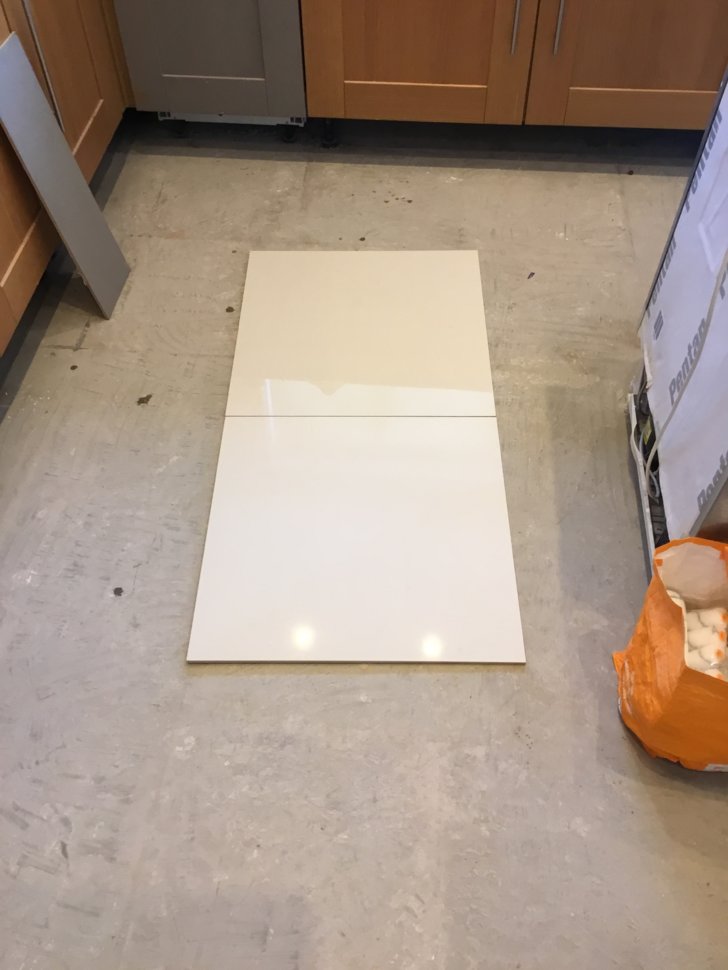

Planning to lay some 60cm x 60cm porcelain floor tiles onto my kitchen concrete floor
Do I need to treat the floor with anything before or can I lay straight on to it?

Prime the floor first with either dilute SBR or Mapei Primer G. I'd advise against a white grout on the floor, will just discolour pretty quick, are those tiles white? They look ivory coloured in the pic? Epoxy grout would be one option if you really wanted white grout but just a lot more work involved.
