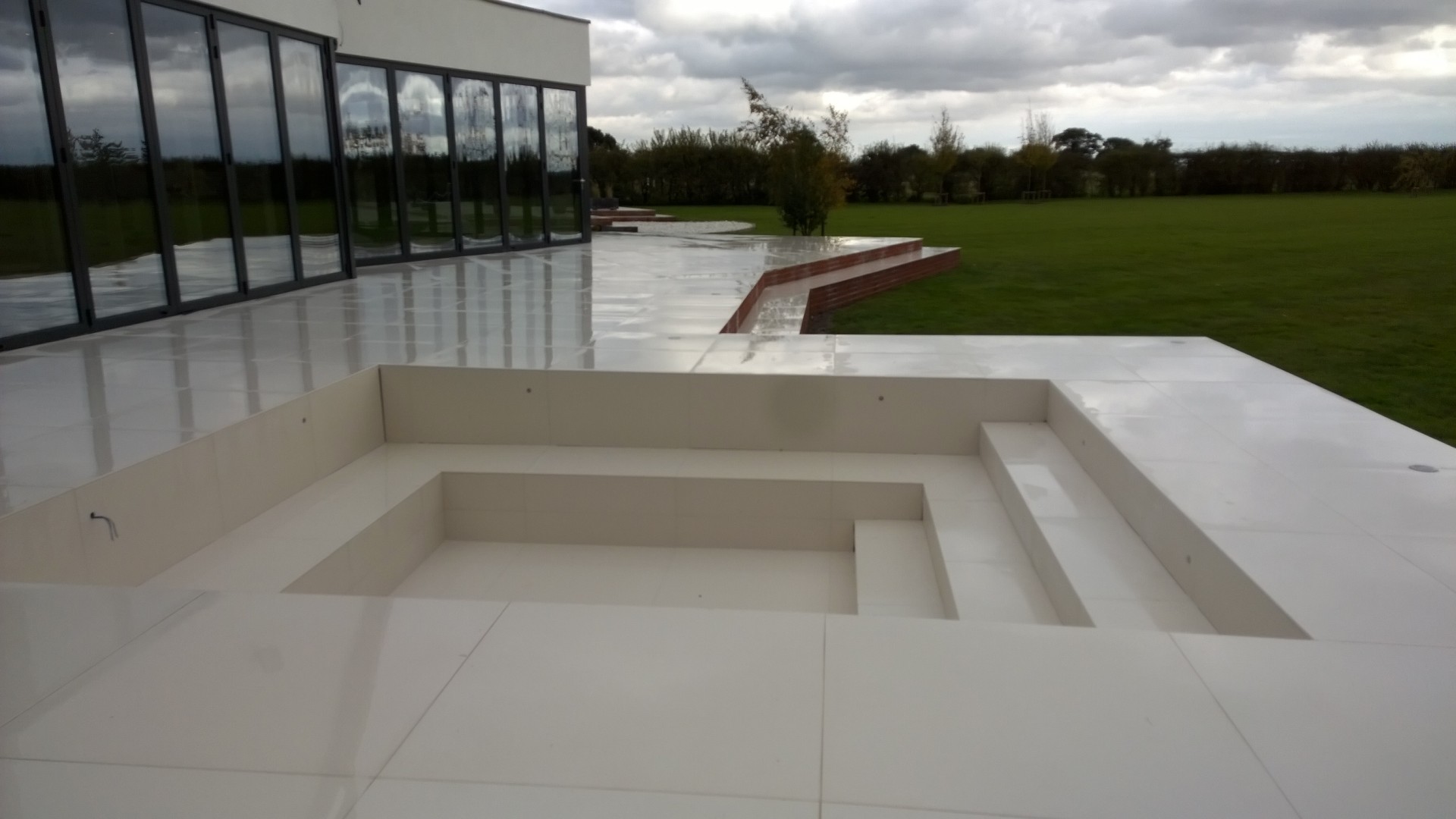

grout will only look dirty imho if the wrong cleaning technique is used.
job 5 years ago, about 400m2, white grout in and out and still white now.
Nice looking job, but personally i'll always advise against it & this is because when you don't mention it, the response 9 times out of 10 you didn't tell us it might go mucky looking & if you say to them your not cleaning it correctly I not going there with that one, bad experience which very nearly came to blows
