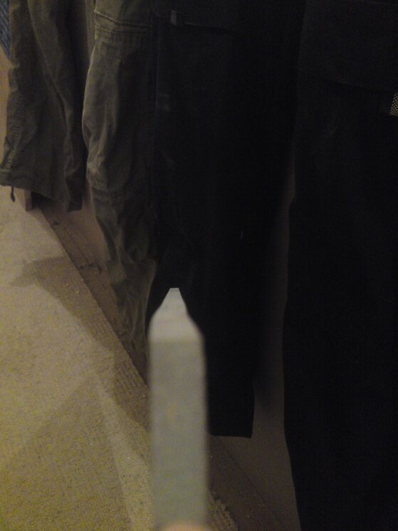

Been round to a mates this evening tiling his bathroom floor. I checked the sample for bowing and it was ok but look what i ended up with!
Not only are they bowed on the surface but on the edges as well, the only thing thats straight and true in the calibration.
And the cost of these little beauties? £68p/mt. What a rip off. Im calling the supplier about them tomorrow as i weant replacements for all the bowed ones, and a bag of addy as that skinned over whilst i was trying to find a flat one.

The main problem is bowing is over such a short area, about 40mm from the end of the tile it just goes off, some up and some down.
