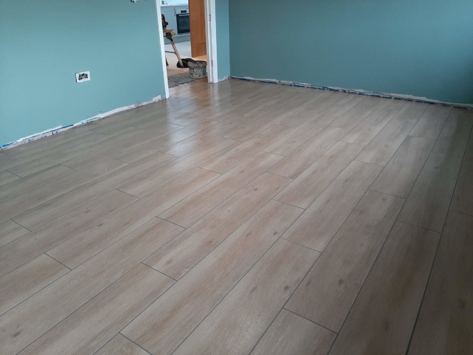

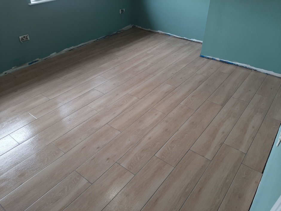

Not happy with tiling job - or am I being picky?
doesn't look great but the chances are that the planks will be slightly bowed which will cause lippage no matter what the installer does. The light is probably making it look worse aswell. Any half decent carpenter will be able to scribe them skirtings in to lose the gaps. Can't really see what the tiler can do now apart from re-do the lot if i'm honest and maybe could re-pay you a few quid for the sub-standard finish. wouldn;t bother with court etc though.
I had some similar plank tiles to lay earlier on this year. They all had a slight bow some worse than others. Had to clip them all, used a ton of clips which made removing and cleaning them take twice as long. Tried not to bond them no more than a 3rd. I wouldn't get too hung up on the deviation over a 2metre straight edge, sometimes you have to follow variations in the floor to a degree but can still avoid lippage. Depends really on how much prep/self levelling was allowed for. But I think the tiler should be given the opportunity to try and rectify the worse areas.
So does using clips go a long way to solving the problem? Would they have ensured lipping was minimised to at least BS guidelines? I spoke to him on the phone and he said 'ah yeah, those clips are for people that don't know what they're doing..' I bit my tongue until I have all the facts.

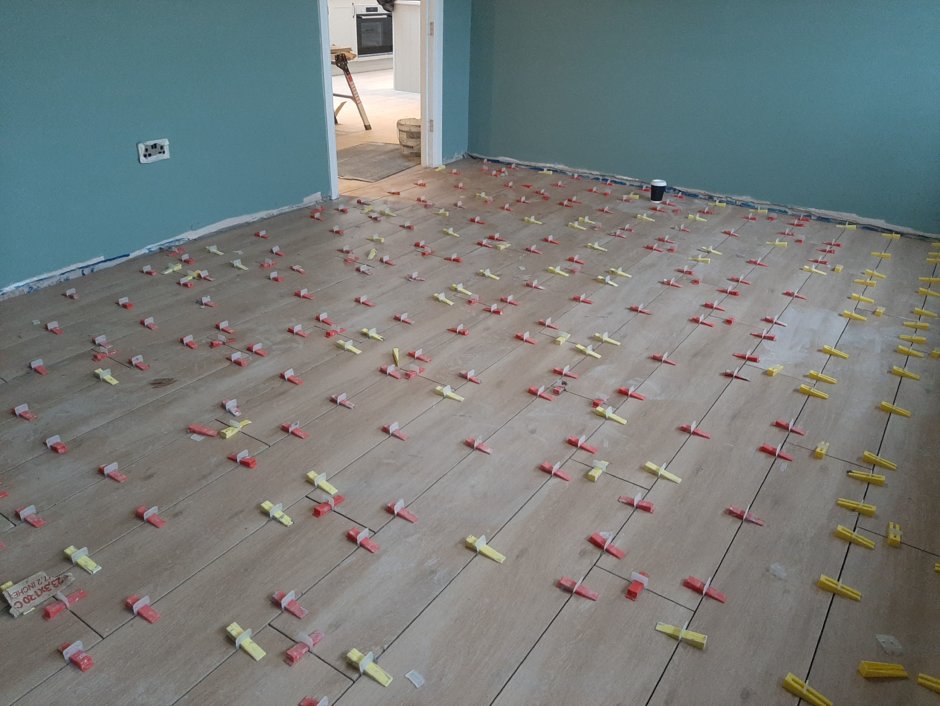

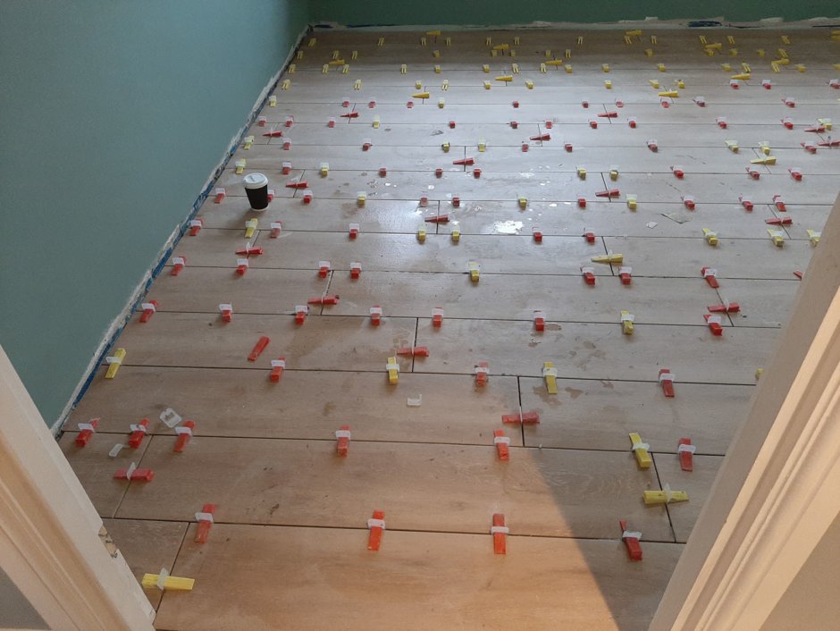

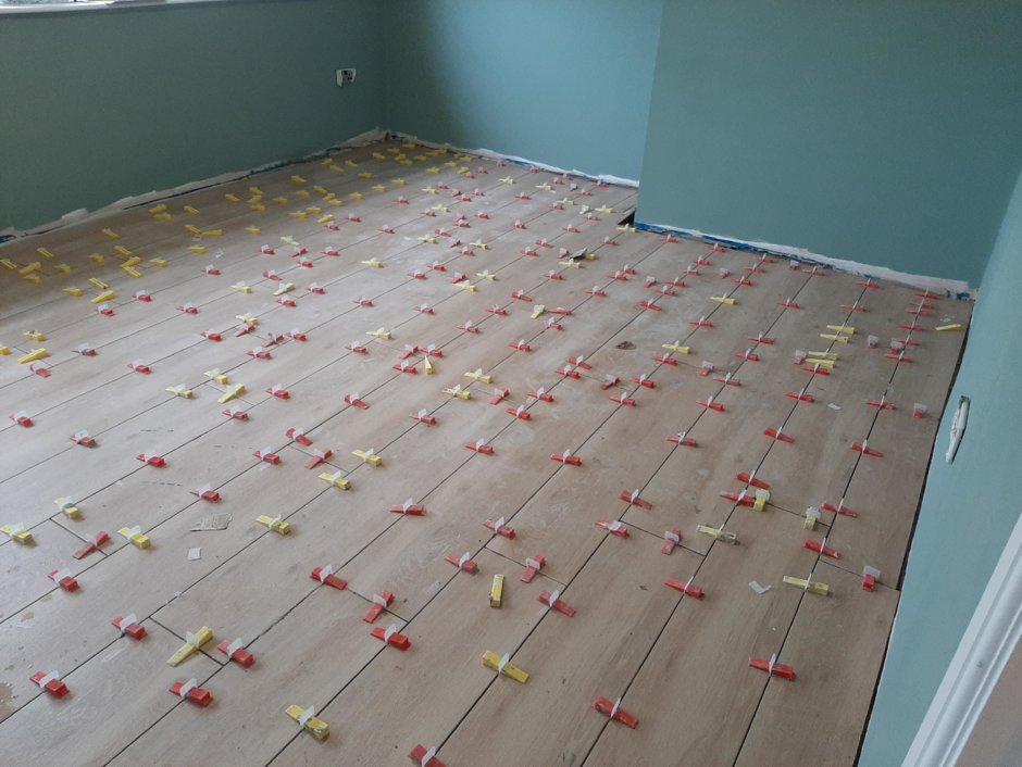

Clips you say? Bowed tiles you say?

There is one big thing about tiles that people tend not to understand.
That there exists a Renault Clio and it costs 20k, and that there exists a Mercedes S which costs 100k. But a tile is a tile. Yea, right.
HOWEVER, looking from the customer's perspective in one hand I understand it is very hard to know what is a quality material and who to trust for advise and laying in the end.
Been laying glass tiles "worth" 650€/m2, the guy said to me watch out when laying it, it is a very expensive material. Looking at it I wanted to cry, the difference in dimensions, a bow, etc.
It is hard to say anything from the pictures, we would have to see tiles in person, try how to cut it. Clips are a must, but can't do miracles. It is still possible to do a neat job with a crap tiles. BUT the general problem at the tiler's, you put price per m2, after you get low budget material you spend twice as much time and effort to put it together, resulting in no revenue.
Don't know what to do or say in this case, folks, when buying tiles ask someone as much reliable as you can get, and check the builder's works before tiles.
Been there, done that, had stairs one week ago that seemed perfectly fine, when measuring it 4cm height difference on some spots. What to do or what to say?
