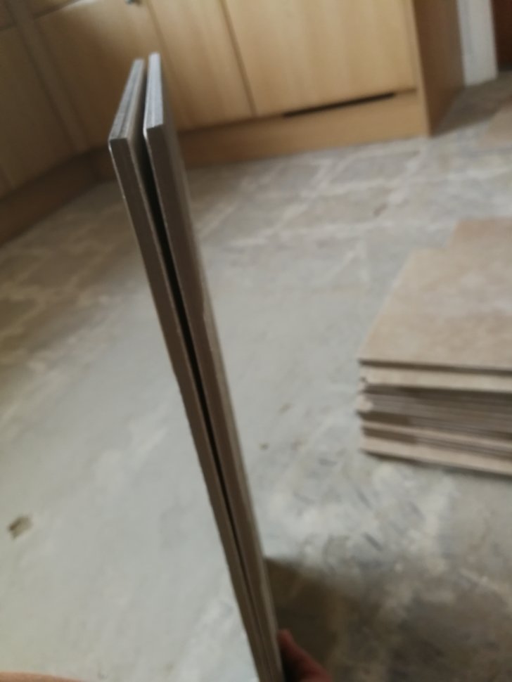

you say the tiles are straight and there's nothing wrong with them...
how did you check this..??
Measured the depth with a steel rule along the edges, and ran a spirit level across the tops with them butted against each other. Certainly nothing that would make lipping unavoidable...
you need to put them face to face to check if there bowing, like this...
So there's a little bowing if you put them back to back like above, but this must be why the manufacturer specified no brick bond? There are cases where I have lipping along the full tile length though so this can't explain that.. Also, if the BS states max 1mm lipping for joints this small, surely the tiles should be designed to make this possible and that it's the installer's responsibility to check that it can be achieved?
You would think that about tiles , but as tilers we as the people at the end of the line have to deal poor quality materials and try and make a good job out of it.
